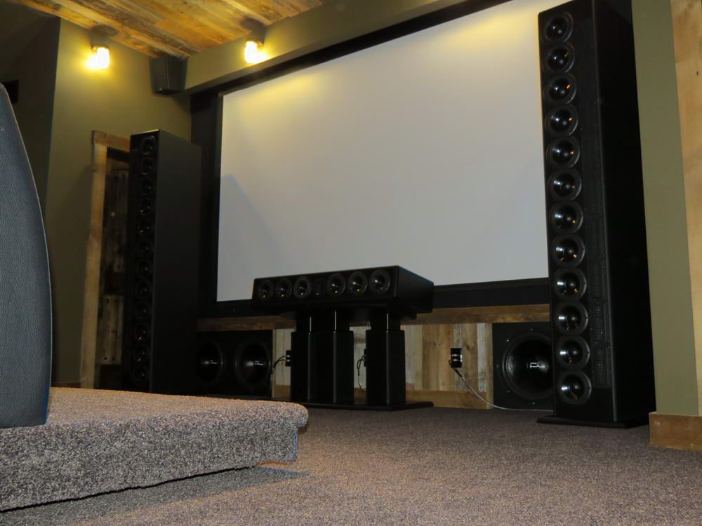

Hi chopshop.
If you're trying to maintain off axis (both veticla and horizontal) accuracy, you might want to seriously consider a line array. They solve those issues specifically. There are several tested DIY line arrays available too if you want to go that route. I chose to go with the tested LS-9 from GR Research (more specifically, Danny Richie). There are a few here that have the LS-9 and LS-6 and love them. desertdome has indicated elsewhere that Danny no longer has drivers for the LS-6/LS-9 kits, BUT...I would still reach out to Danny anyway. If there is continued interest in these kits, I'm sure he could arrange something.
As you can see from the pic below, there is no shortage of soundstage nor imaging for anyone in the back row....Line array would suit you well based on your concerns. Something to think about.

I was always surprised more DIY projects did not adopt line array tech or principles. It actually seems the easiest of the designs to get right, since physics is working for you, and not against you. Although I've never actually done a line array... so IDK. Just guessing at that, but with a line array you identical drivers mounting in a line and fed in phase and placed in a way so that they intentionally and constructively interfere with each other to send sound waves farther than traditional horn-loaded loudspeakers, and with a more evenly distributed sound output pattern.
I've liked all the line array's I've heard before. I liked them a lot. I thought the Wisdom audio demo at Cedia was one of the better ones, but because it was not Atmos it was forgotten. It did not seem like many people even noticed they used a hard wood floor and hard surface ceiling in that demo, reduced floor and ceiling bounce is an advantage line arrays have. In some cases they can really make a lot of sense to use if you understand how to use them.
But I think line array are generally expensive, which is a reason why they are not so popular. You need a lot of drivers, and if you use premium drivers that gets expensive. Also, dedicated spaces have room treatments, including carpet and pad floors so the floor ceiling bounce is less an issue. But these pictures I see all over AVS with soft dome fancy speakers in nice higher end rooms/homes with hard wood, tile and glass everywhere make me cringe sometimes. A high end speaker is going to sound like poop there, you can tell just by looking at it. Line array might actually make more sense in a live room, or a room with a hard floor surface and ceiling, but certainly output is also an advantage of a line array. They get silly loud, like hearing damage loud.

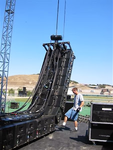

And lets face it, if Jake has a style it's probably something like this:
haha... I could see him hanging something like that ^ lulz.
Or this:
or this:
