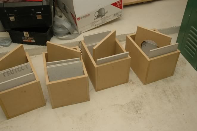

So away we go. I've built four of the five light boxes and am ready to install them. (The fifth one goes way back in the attic where I need to crawl in. I want to make sure the first four work before I crawl in and measure for the fifth).
The boxes are pretty big: 14″ x 10″ x 10″. They are made following the general ideas from here:
How to build a soundproof fireproof light box
. They are basically boxes made out of 3/4″ MDF, glued and finish nailed together, with a 6″ hole in the bottom and a 5/8″ hole for the flex-conduit/wire to come out the side. The insides (except the bottom where the light hole will be) are lined with hardiplank/green-glue. This will give more heat resistance than straight MDF. The green-glue will (hopefully) give a bit less sound transmission. Mostly, the green-glue can't hurt.
The boxes are sized to fit exactly between the studs on top of the existing drywall. I plan to drill a pilot hole from below to mark the spot where I want the boxes to be. I'll place the boxes from above over those holes. I'll attach the boxes by screwing through the studs from the sides (so I can remove the boxes later if I ever want to modify them), then caulk all around.
The flex-conduit from each lamp exits the box through a small hole in the side (not shown in the pictures) and goes to a metal junction box on the outside. That'll make wiring up easy. If I kept the junction boxes inside the light-box I would have code problems (not allowed to bury' a j-box).
I bought 6 cans for $30 at HD, but ended up not using them. Instead, I stripped down the original cans I removed from the ceiling. Those were higher build quality and seemed less likely to rattle. If anybody wants 6 cheap IC can lights, let me know.
I'm hoping to get some installed soon, but time is tight these days
Here are the light boxes (I've since green-glued/caulked them and added the can and the junction box. They are a lot less pretty now...)

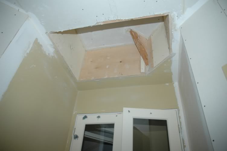

1) The 'floor' of the light shelf (the horizontal surface of the light shelf, behind the lip). There was no way I could get in here with a drill to screw in the drywall screws. Instead, I used drywall glue. Each piece of drywall got a blob of drywall glue at each end and green glue over the rest of it. I laid them in and wedged them down with scraps of drywall (you can see some of the scraps in the light shelf pictures just below)
2) The 'inside' of the light shelf. In the back of the room where I redid the light shelf from scratch, it's completely sealed off. The front lip of the light shelf is two 2x4's running sideways. The inside of the light shelf is insulated. No problem. However, in the front of the room, the light shelf is hollow. With the shelf off, you can sort of see inside:
That opening you see goes right through the shelf into the attic. There will eventually be a piece of pine shelving on top of that opening, but it's still a path for sound to get out. My solution: stuff the inside of the shelf with pink insulation, and then use a double piece of drywall to seal it off. I cut a bunch of little pieces of wood and glued them down inside the shelf opening. I then cut two pieces of drywall to fit between each of the studs you can see in the picture above. I green glued the two pieces together, and used drywall glue to stick the assembly to the supports I had dropped in. Hard to explain, but the effect is that the lip of the light shelf is now sealed off by a drywall sandwich a couple of inches below the opening. No more air path.

I need to fit at least one, and likely eventually two, equipment racks back into this corner:
The current plan:
* continue the current left wall straight, covering this hole.
* contine the wall by the door to the right. Essentially square off this hole.
* the tall space next to the door to the right will be a bass trap.
* fit two 19" racks, ~4' high at the front, against the left wall of this space.
* Next to that will be a 20" x 5' panel that can be removed. use that to access more space in the back corner. That's where I'll put an HTPC or a small rack or two with equipment that doesn't need access often.
Because I won't have easy rear access, it would be nice if the racks could pull out and rotate. I've picked up some 500 lb rated Accuride drawer slides (big!) and a 1000 lb rated lazy susan. I also picked up 4 Middle Atlantic rack rails to use as the corner posts. Heres a sketch of the current plan:
The outer 2 pieces of wood on the base are attached to the floor. The accuride slides attach to the insides of those. Between them is a wooden sled (2x3's and reinforced plywood). On top of that goes the lazy susan and the rack. The rack depth is 22". The whole thing will slide out 28" and rotate 90.
Here are pictures of the current progress. I'm waiting for some blank cover plates for the front of the rack before I build the rest. I'm going to use them to set the spacing of the rails.
