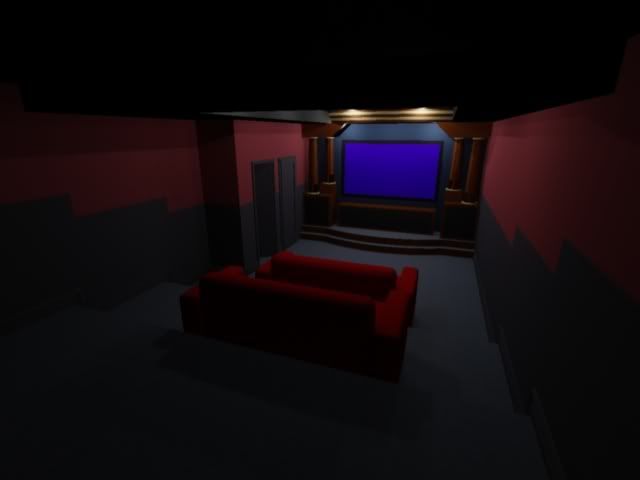

OK on to the plans. We're building a brand new home and in it I have a nice space for an entertainment room, being 16' at the widest point and 31' long. Originally I had planned to have two rows of seating with a third riser in the room for a pool table behind the second row of seating. However, this is no longer possible since I can't manage to dig any deeper for the basement. Faulty planning on my part I didn't account for the extra room needed for the stairs coming from the main floor.
Anywho, so now the plan is for 'L-shaped' seating. With one sofa and a love seat. Pictures will explain this better...
Original room plan:
New, non-theatre-like plan:
So, my google sketchup skills are not quite up to par, but a rough sketch is better than no sketch, right? right??? The sofa will be 14 feet away from a 60" plasma/lcd which will be mounted into the crawl space wall. (basement floor plan to follow) In front of the tv will be a drop down 120" 16:9 screen for bigscreen goodness. Behind the sofa will be bar seating with 4-5 high chairs. Behind this will be an 8" step up to a pool table/dart board/beer refilling area.

played with sketchup a bit more and drew those out. will also have a mirrored bar rack in the corner by the window to hold all the bottles with a beer fridge underneath. not gonna go with a full out bar due to space constraints vs what i want out of the room.

That is a pretty good sketchup diagram there.
