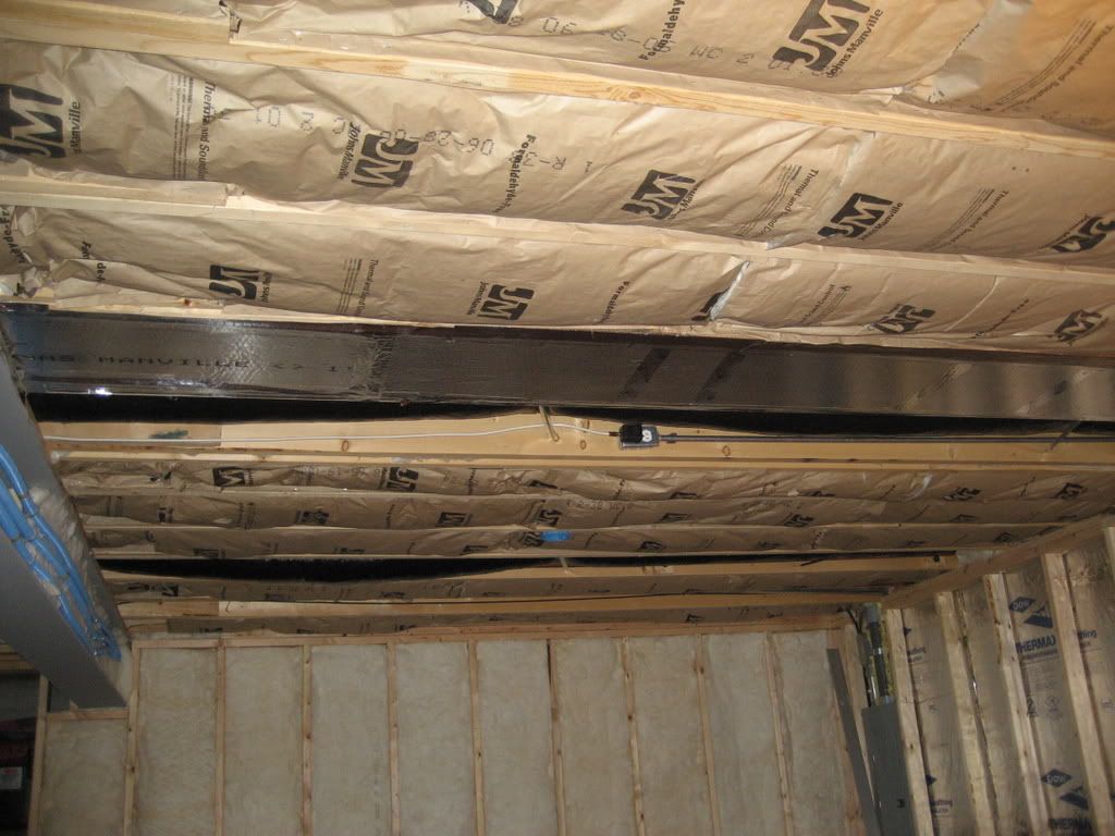

In regards to covering thr steel girder, what kind of adhesive did you use to hold the O.S.B.?
builtwell5000 is offline
post #70 of 1249 Old 08-04-2007, 03:25 PM - Thread Starter
W00lly's Avatar
Location: NEBRASKA
Posts: 2,110
Mentioned: 16 Post(s)
Quoted: 57 Post(s)
Liked: 74
builtwell5000
I used good old liquid nails. I let it cure for almost 7 days before I removed the clamps and still had one little spot pull away I dont think I used enough LN on that spot. I screwed it along the top and used the LN along the bottom edge of the beam and clamped it tight.

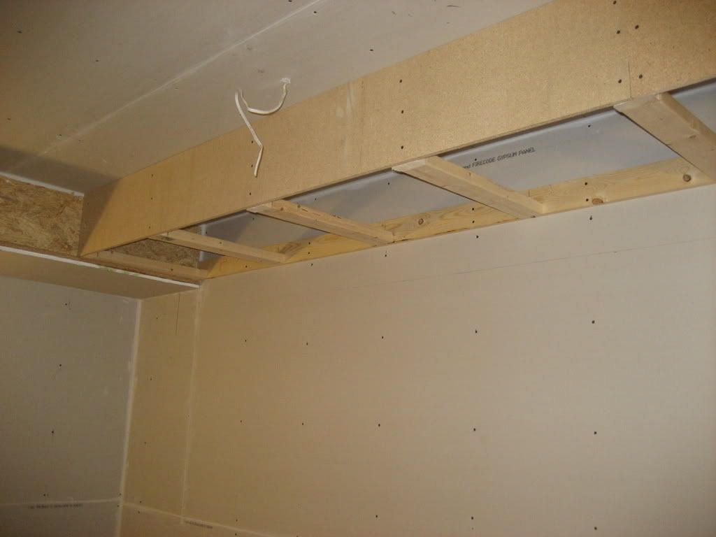

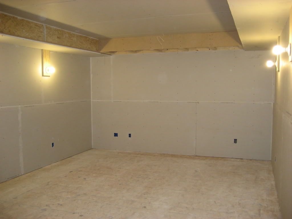

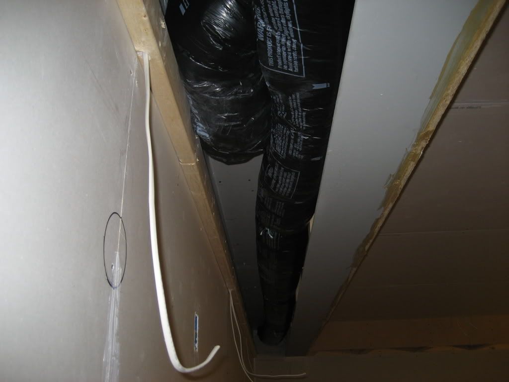

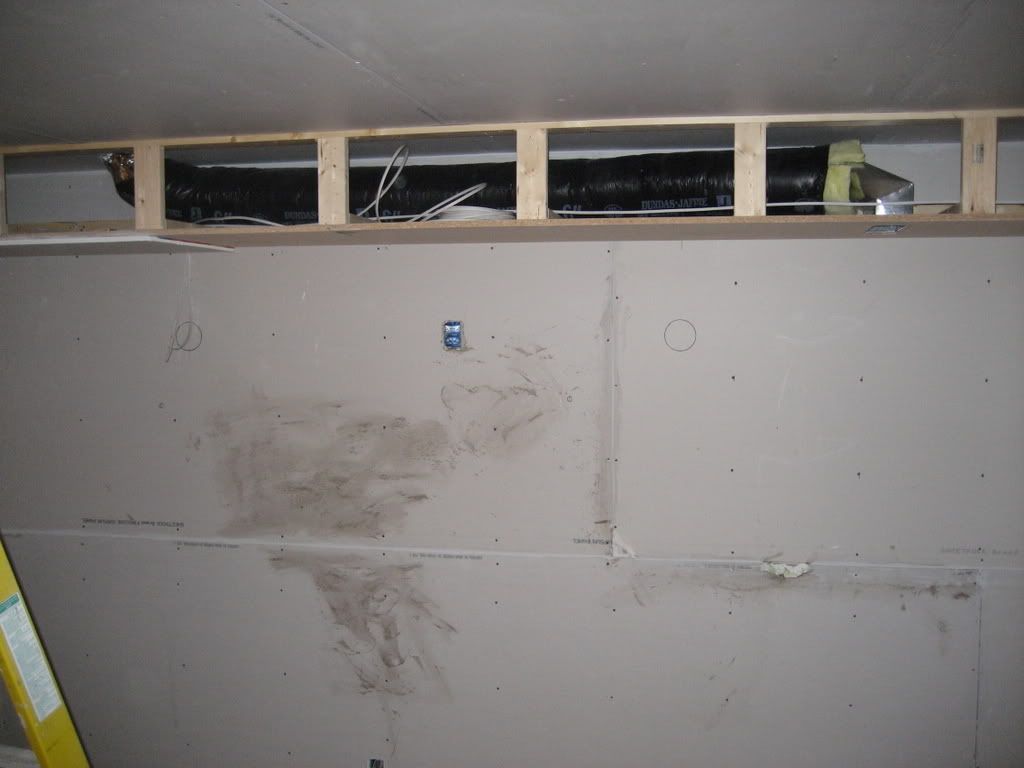

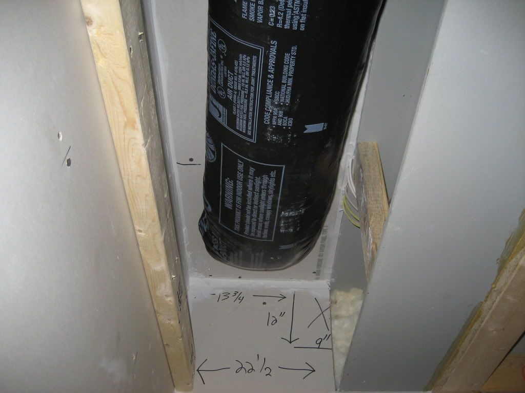

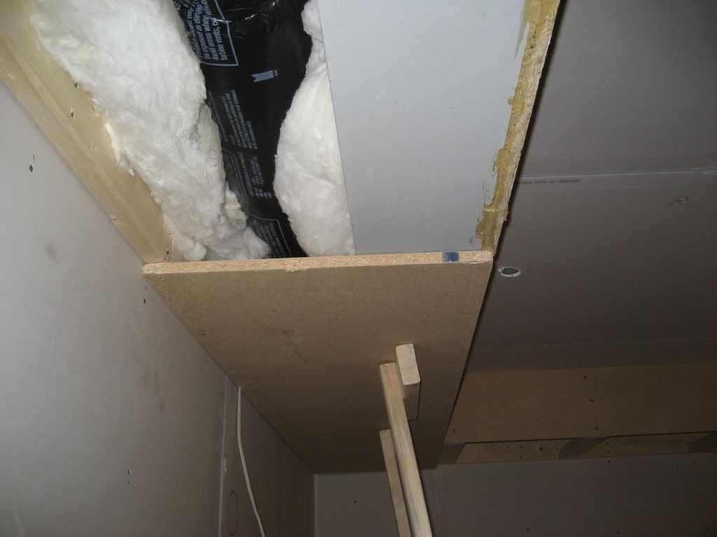

Hello All
I have been trying to finish up the soffets this week and I am pretty close just a few more small sheets of sheetrock and GG and DONE
Here are a few pics of my flex duct before I sealed them up
Return
Supply
Scott
The CopperFields Cinema
          Current Photo's
W00lly is offline
post #72 of 1249 Old 08-04-2007, 07:50 PM - Thread Starter
W00lly's Avatar
Location: NEBRASKA
Posts: 2,110
Quoted: 57 Post(s)
Liked: 74

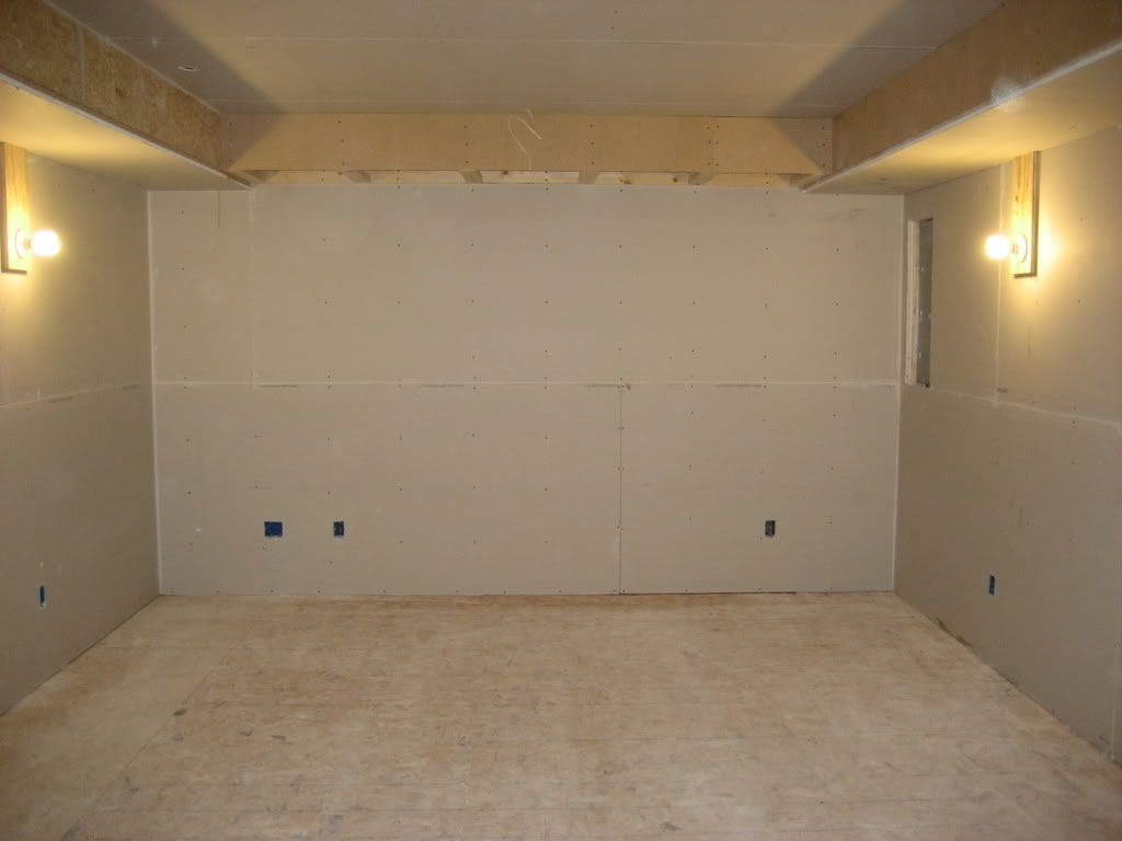

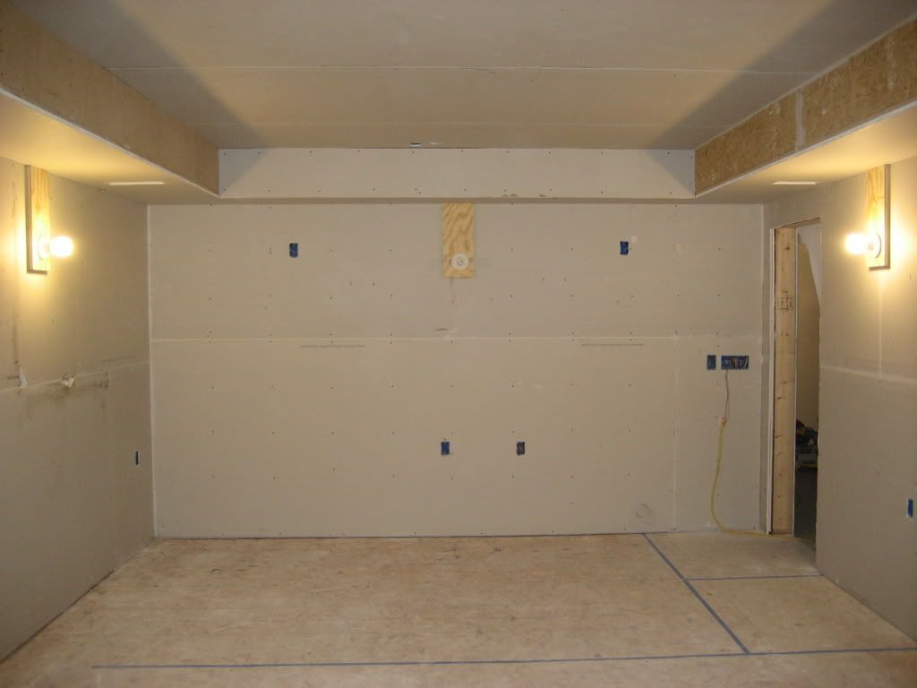

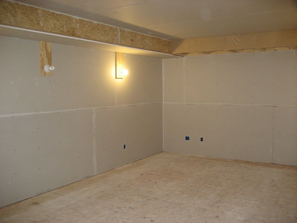

Also I decided to go with sconces so that I didnt have to cut into the mass of my soffets
Here are the almost completed Soffets.
Scott
          Current Photo's
W00lly is offline

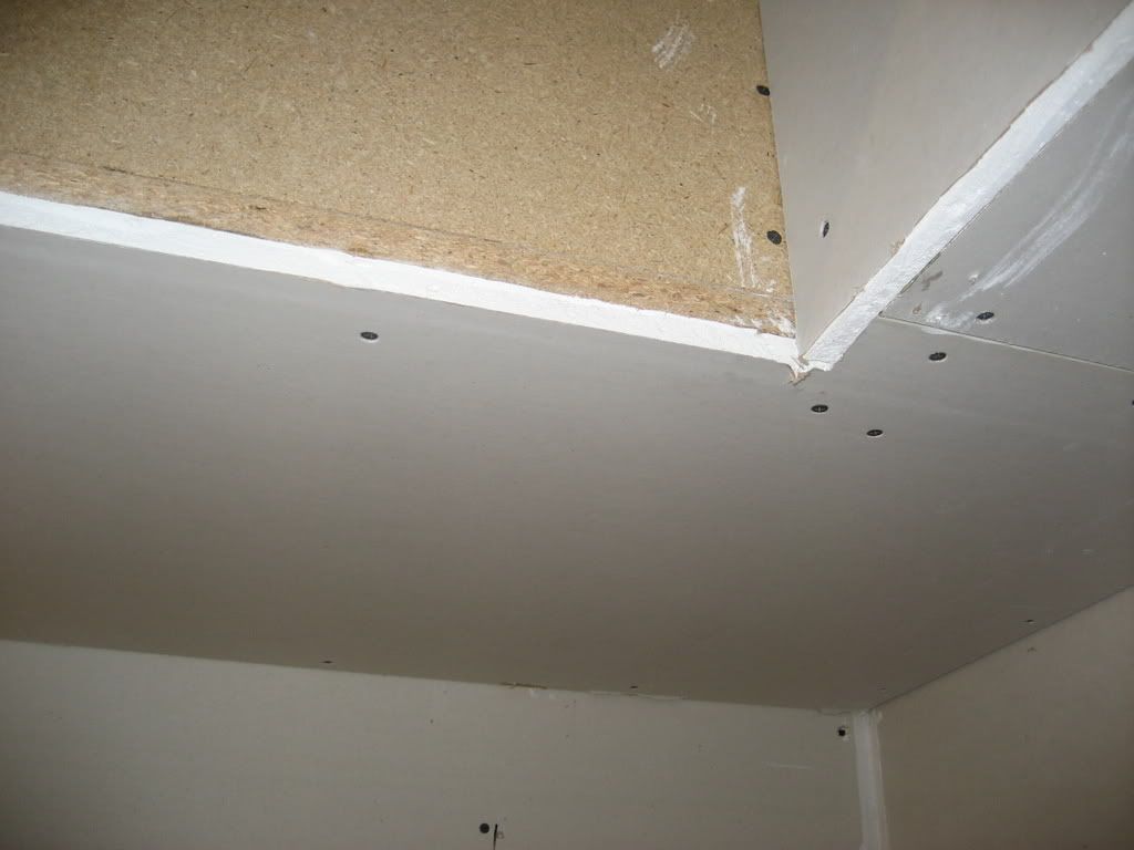

Future Bass trap and can lighting that will go behind the SMX and shine down on my speakers

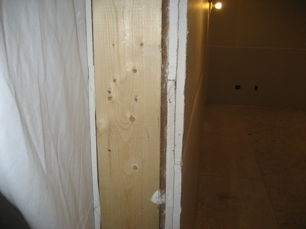

Here is a shot of my staggered stud wall where my door jam is. I think I am going to have it custom made since my jam is 8 1/2" wide
This is also a pretty good shot showing how I over lapped my sheetrock alternating the 48" & 54" sheetrock. Stretch rock is a Beautiful thing
going to order my Linacoustic this week and start getting some furring strips up. I'm also going to be using the fabricmate track system

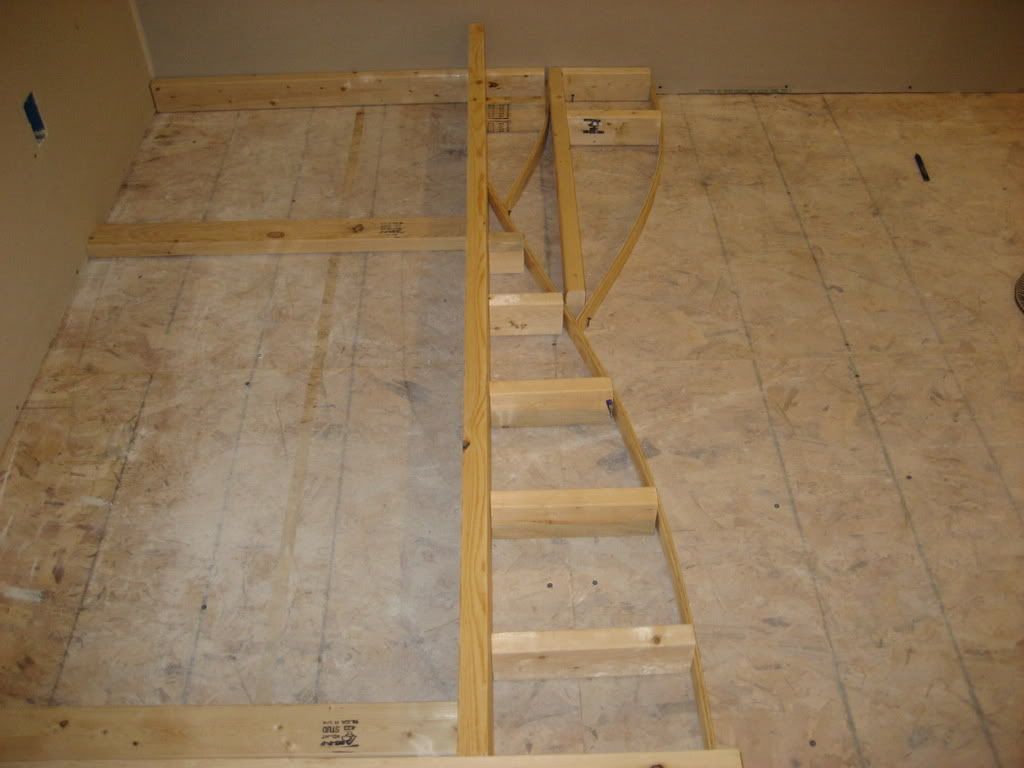

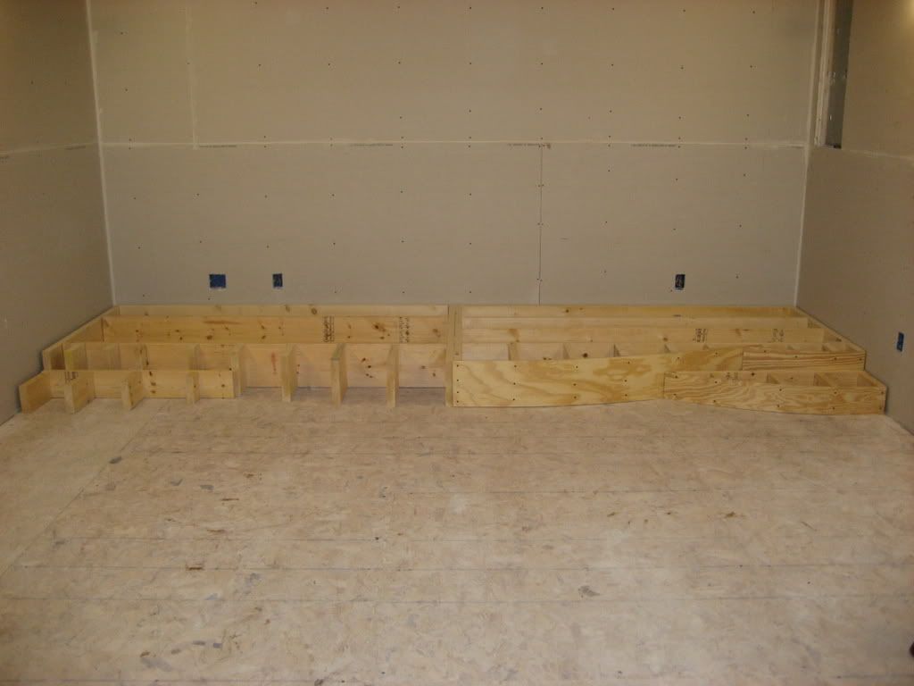

I'm about to build my stage. It would be cool if I could get some input on design. Please post links to your builds. I have a few pics saved of a few fellow AVS builders that I really liked but can always use more ideas
Scott
          Current Photo's
W00lly is offline

I know sandman's stage is a frequently copied one.
Any turns in those HVAC runs?
dc_pilgrim is offline
post #76 of 1249 Old 08-05-2007, 11:45 AM - Thread Starter
W00lly's Avatar
Location: NEBRASKA
Posts: 2,110
Quoted: 57 Post(s)
Liked: 74
DC
The cold air return I did a 14' run of JM 1" duct board in the floor joist and boxed it in and then hooked in my return with the flex duct. I can yell into it and you can not hear me in the room above. The supply line I have not hooked up yet and just have it hanging in the furnace room. I will mess with it when I get the room done.
Sandmans stage is nice but I think I am going to copy Ronnie jacksons stage. I really like the way that turned out. He did a awsome job
https://www.avsforum.com/avs-vb/showt...ghlight=ib+sub
Scott

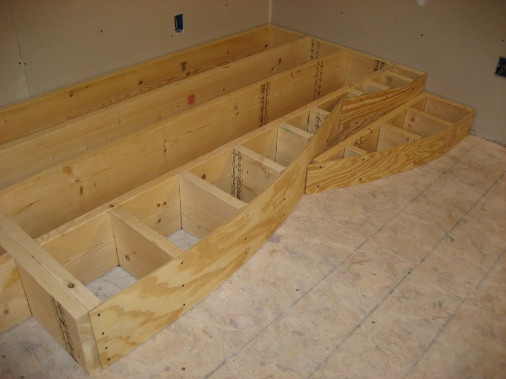

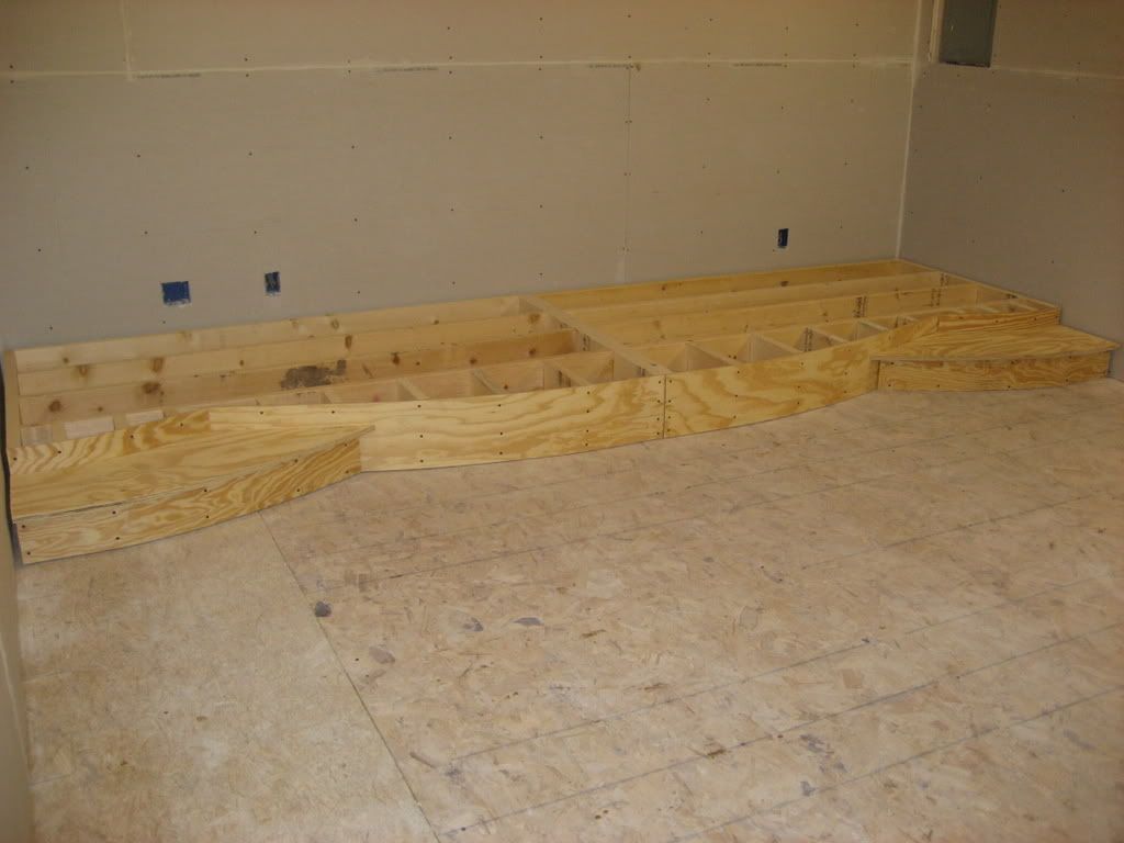

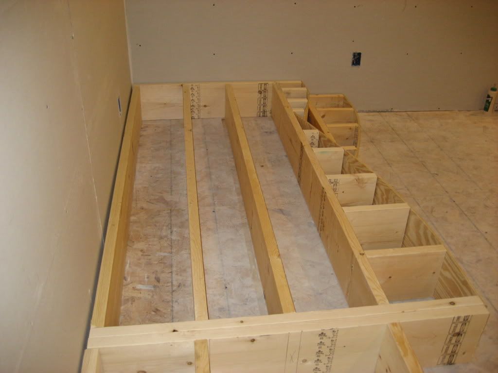

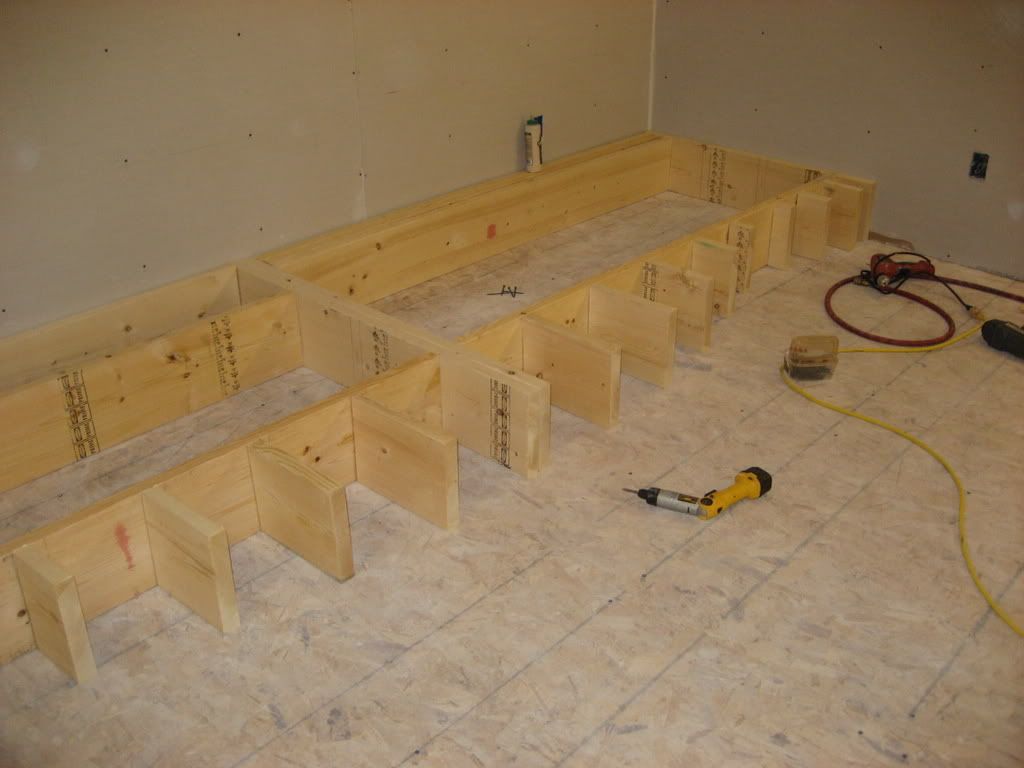

Hello All
Well in between the rain and mowing my lawns I made some time to start working on the stage. I tryed to copy Ronnie jackson's stage build. I had to make mine a bit smaller Thanks to Ronnie for some pretty detailed photo's I think I came pretty close.
Here I used a bunch of scraps and did a mock up
Once I was pleased with the way every thing fit I started putting the puzzle together
I think I got alot done for the few hours I have into it. I hope to have it finished by the weekend. I'm not looking forward to dragging bags of sand into the basement

I finished up the framing today. Now sand not looking forward to that at all
Scott
          Current Photo's
W00lly is offline

Oh man. Are those 2x12's? That is going to take a ton (literally) of sand! One word: Ibuprofen

2x10's but ya I think its gunna take a ton I have a plan though. I bought a drywall cart to haul my sheetrock around when I started working on finishing the basement my plan is to wheel barrel it to the basement window then slide it down a ramp. Then load it on the drywall cart and roll it into the HT. Sounds simple but we will see
Scott
