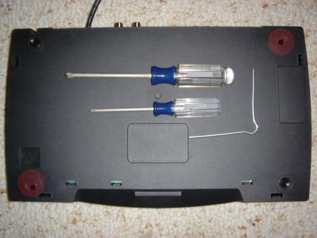

Here's an internal shot of the DTVPal DVR, courtesy of hignfy.
  • STMicroelectronics STi7109 DVR CPU w/ integrated MPEG-2, MPEG-4 AVC, and VC-1 decoders
  • 160MB DDR400 SDRAM (2x Elpida D5116AFTA, 2x Hynix HY5DU281622FTP-D43)
  • 16MB Spansion S99-50052 Flash IC (for system software)
  • 250GB Western Digital WD2500AAJS SATA hard drive
  • 2x MicroTune MT2131 tuners
  • 2x AMD Theater316 demodulators (218T316ZLA12GP)
  • A/V Inputs: 1x coax (split internally for both tuners)
  • A/V Outputs: HDMI, component, composite, coax; optical digital, stereo
  • 10/100Mbps Ethernet
  • 1x USB
  • Dish IR remote
  • 14.6"W x 8.8"D x 3.1"W
  • 5.0 lbs

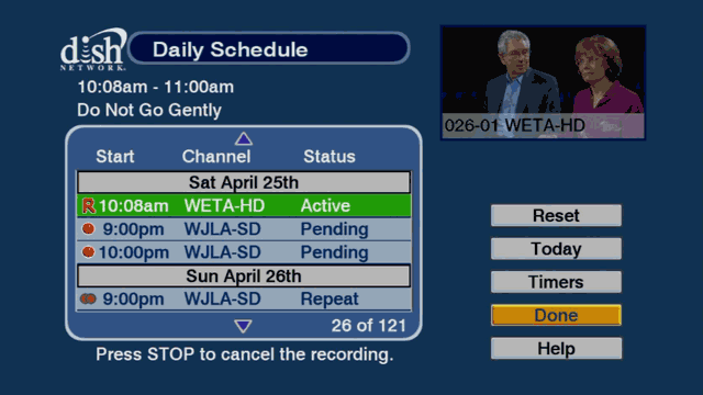

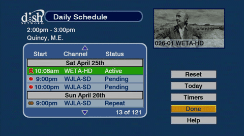

  1. DTVPal DVR may fail to record back-to-back programs.
    The DTVPal DVR often skips one of two programs scheduled to record when it coincides with the end of a previous recording. As an example, suppose you had one record timer set for 8-9pm and two record timers set for 9-10pm. In this scenario, one of the two 9-10pm programs would fail to record. This occurs 30-50% of the time.
    When this happens, the Daily Schedule shows the missed recording as "Skipped." Occasionally, the one event that does start will continue recording for an extended period (i.e. many hours).
    These skipped recordings only occur when two recordings follow a single recording; they don't occur when two recordings immediately follow two other recordings. Thus, you can avoid these skipped recordings by creating a "filler" timer so that two recordings always follow two other recordings. You can do this by recording the preceding program from the EPG.

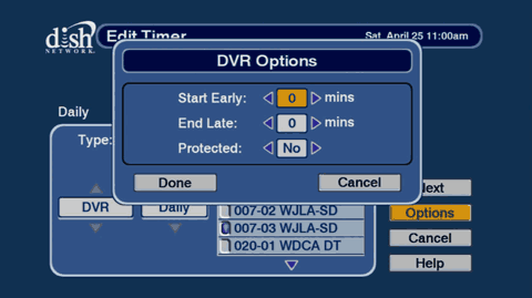

    If you are padding end times, or a record timer is set to run past the hour (ex: 8:00-9:01), the guide may indicate that the subsequent program on the same channel is scheduled to record, even when it is not.
    For example, if you have a record timer set from 8:00-9:01pm, then the guide may indicate that the 9:00-10:00pm is scheduled to record when it is not. For an accurate list of scheduled timers, check the DTVPal's Daily Schedule.

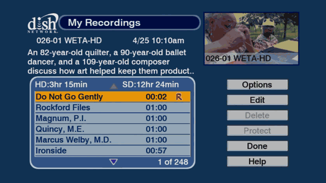

  6. How are recorded programs displayed?
    You can choose to sort by recorded date (shown below), name, or group. In group sort, the contents within the groups are in random order.
    Each recording is listed with the information shown in the guide at the time the record timer started. If TVGOS is not available, or TVGOS does not have program information for the channel on which the recording was made, then you may see only a program title without a description.

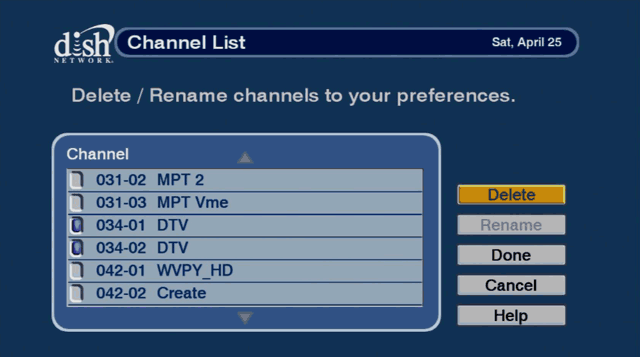

  8. Can I remove channels from the program guide?
    You can remove and rename channels, as seen below:

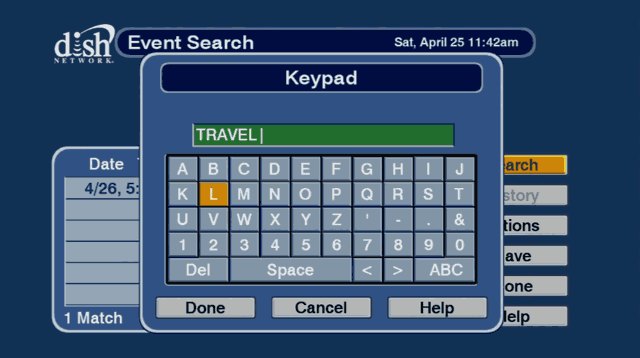

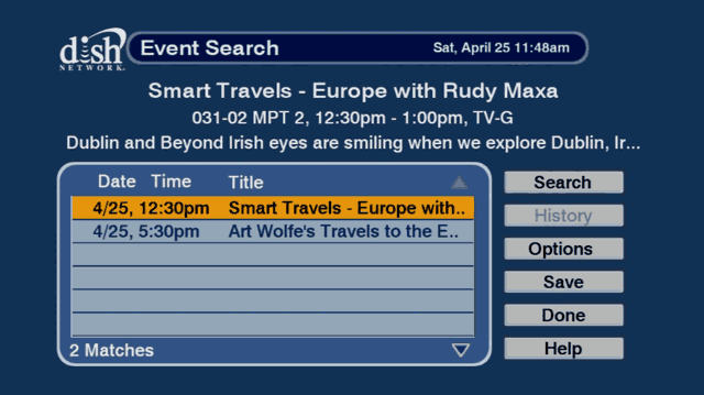

  12. What does search look like?
    The DTVPal DVR offers a basic search function for available guide data.
    You enter a keyword through an on-screen keyboard, click Done, and then you see a list of matching programs.
  13. What about more advanced search options?
    The DTVPal DVR is limited to the search functionality shown above, although you can choose to search program titles, descriptions, or both.
    You can switch between title, description, and title+description results without re-entering the search text.

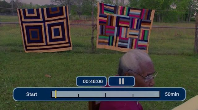

  19. Does DTVPal DVR have a progress bar? If so, what does it look like?

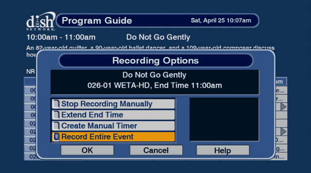

  20. If I press record while watching a liveTV program, will the DTVPal DVR save the buffer to the recording?
    In the F206 software, Dish Network added the option for "Record Entire Event." This will save the entire buffer to a recording, although the recorded list screen will only list the duration of the selected event.
    When you click Options....

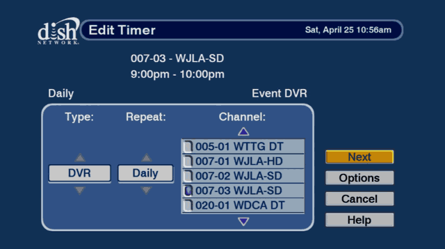

    If you hit record on a future show listed in the guide, a single, non-repeating record timer is created for that program.
    If you hit select on a future show listed in the guide, then you are given the option to create a repeating timer, as below:

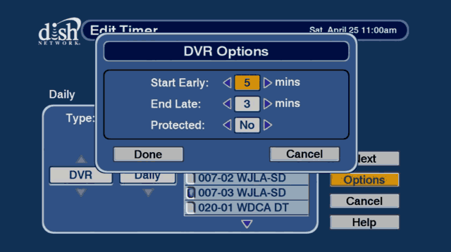

    If you click Options....

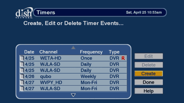

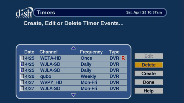

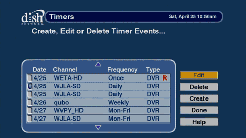

  24. Does DTVPal DVR provide a record schedule, to list what upcoming programs will record?
    The DTVPal DVR lists upcoming timers, as seen below.

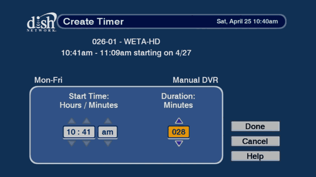

  25. How does the "time-based recording" used by the DTVPal DVR differ from the "name-based recording" found on TiVo and other DVRs?
    With time-based DVRs, you deal with dates and times like a VCR. With name-based DVRs, you deal only with program names.
    The DTVPal DVR (shown right) uses "time-based recording," which records by setting a single or repeating timer for a specific day at a specific time like a VCR. When you use the guide to create a recording for House on the DTVPal DVR, it creates a repeating recording for Tuesday 8-9pm on FOX. Nowhere on the DVR is this identified as a House timer; it simply records that same Tuesday 8-9pm slot regardless of whether House is showing that week, regardless of whether it is a new or old episode, and regardless of whether it is a special extended episode that runs longer than an hour. If FOX decides to show an episode of House on Wednesday, or at 9pm, then you'll miss that episode -- unless you modify your timer. If FOX decides to show a special extended length episode, such as a two-hour special on Tuesday from 8-10pm, then you'll only get the first hour -- unless you modify your timer.
    The above screens show what you get when you select a program from the guide.

    Modern name-based DVRs also allow you record all future programs that match a title or keyword search, regardless of the date, time, and channel. The DVR does this by continuously searching a built-in database of all upcoming programs for the text you entered using an on-screen keyboard. With this functionality, you can record the next showing of a certain movie or documentary, regardless of where and when it is shown. You can create a single recording for all future games with a particular sports team, such as all NFL games with the Dallas Cowboys, regardless of date, time, and channel. Or you can use a wildcard to create a single recording for all new episodes of Survivor* or Amazing Race*. Some DVRs even let you exclude specific words, so as to record, say, all future shows with Jennifer Aniston, except Friends.

    Automatic rescheduling for conflicting programs is another difference between name-based and time-based DVRs. Time-based DVRs like the DTVPal DVR provide no means to automatically reschedule conflicting recordings; if a conflicting program is showing at a later time, you have to find and create a manual recording for it. Such is unnecessary on name-based DVRs, which record your two highest ranked programs (refer to screen above) and then automatically search for repeat airings of any lower-ranked programs that conflict. If the conflicting series episode is showing later that night, or later in the week, or even several weeks later, then a DVR like the TiVo will automatically find it and schedule a recording without any action by the user.
    The above screens show what you get when you display the record schedule.

  27. How many recordings can I schedule?
    A maximum of 40 record / remind timers are allowed.

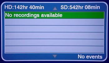

  37. Is there a disk space indicator to show how much space is left?
    Yes, the DTVPal DVR estimates the amount of HD and SD record time remaining on the My Recordings screen.
    Be aware that different channels (and even different programs on the same channel) are broadcast at different bitrates, and thereby require different amounts of space on the drive. You might be able to record 40 hours of content from one HD channel but only 30 hours from another HD channel. Sports and other live broadcasts tend to require more space than movies and episodic series.

    7. allow you to delete specific channels (sub-channels) from the list of channels; or

  9. How do I remove channels from the program guide?
    You can remove and rename channels under Setup -> System Setup -> Channel Setup -> Channel List.
    Keep in mind that deleted channels can no longer be tuned. If you simply want to hide a channel from the guide, without deleting it, then you can lock channels with the parental controls, and those channels remain hidden until you unlock the DVR.

  11. Why can't I adjust the early/late padding on a weekly timer?
    There are two types of timers on the DTVPal DVR, event timers and manual timers. You can only adjust the padding on repeating event timers. Event timers are created when you highlight a program in the guide and hit SELECT.
    To create a repeating event timer with the ability to pad start and end times:
    1. Highlight the program in the guide.
    2. Press SELECT (and not RECORD).
    3. Change the repeat to Weekly.
    4. Select Next, etc. to finish.
  12. How do I create a new record timer for a program not in the guide?
    You can manually create a single or repeating timer through the Timers menu under DVR -> Daily Schedule -> Timers. Click create.
    Once you've clicked create, you'll get the following menu:
    As with a VCR, select the channel and the type of timer, and then click "Next" to choose the start time and duration:

  14. How do I edit/remove a scheduled recording?
    You can edit or delete timers through the Timers menu under the DVR -> Daily Schedule -> Timers. Select the timer(s) and click delete.

  3. How much capacity do I get with a 1TB internal drive upgrade?
    Upgraded with a 1TB drive, the DTVPal DVR reports 142HD hours of capacity, as seen below:
    DTVPal DVR with 1TB drive upgrade (image by otaviewer)

    You simply need to replace the old drive with the drive. Replacing the drive is simple, once the case cover is removed. Unfortunately, removing the case cover on the DTVPal DVR requires some effort.
    Instructions to remove the cover, courtesy of AVS member otaviewer in this post:
    - I unplugged the power
    - Removed the smart card from the front so I didn't accidentally break it
    - Removed the visible screw on the case's bottom
    - Pried off the rubber pad on the case's bottom which is closest to the green and yellow RCA jack and unscrewed the screw underneath
    - Pried off the rubber pad on the case's bottom which is diagonal from the one just pried off and unscrewed the screw underneath
    - Looked in the slots on the bottom of the case with a flashlight to see that an object could be stuck in them and bent slightly to unlatch, except for the three inner slots with green circuit board visible which can be ignored
    - I unbent four medium-thickness 1.5" (2" long measured with a ruler) cotter pins, the kind obtainable from a hardware store, to a 90 degree angle
    - Inserted one end of the cotter pin straightly into either one of the two slots closest to the back of the case, to the point where it stopped on its own
    - Carefully applied sideways pressure (relative to the case) to the cotter pin so the part of the cotter pin outside the case moved away from the case and the part of the cotter pin inside the case moved toward the other rear slot
    - At a certain point while bending the cotter pin sideways and applying slight downward pressure, the cotter pin slipped farther into the case. I let it slide in a bit more. This unhooked the latch in the slot and allowed me to remove my hand from the inserted cotter pin during the rest of the steps.
    - I repeated this with the other three slots using the other three bent cotter pins. Noted that the slots in the front only allowed me to insert the cotter pin slightly past the point where the cotter pin stopped on its own.
    - I Inserted a flathead screwdriver in between the top and the bottom of the case at the closest corner to one of the back cotter pins
    - Twisted the screwdriver at the corner to pry the top and the bottom of the case apart slightly but not enough to damage the case
    - At the same time, with my other hand, used another flathead screwdriver to unhook the closest of the two tabs on the rear of the case. That corner of the case now opened up farther
    - Removed the screwdriver from the corner of the case
    - Inserted the screwdriver slightly to the outside of the tab that the other screwdriver is in, and used it to pry apart the top and bottom of the case just to the point where the screwdriver fits in between the top and bottom of the case
    - Removed both screwdrivers, and noted that the top and bottom of the case remain somewhat separated
    - Repeated the last six steps with the other rear corner
    - I separated the top from the bottom of the case at the back of the case with my hands, without much effort, and noted that this caused the front of the case to also separate
    If you have suggestions to improve / refine these instructions, please post to the thread.
