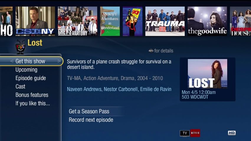

Single and series recordings are created through a program guide selection, a Browse TV category selection, or by searching 14 days of program listings. The Browse TV menu organizes upcoming television programs by genre, but goes well beyond that; it offers more than two dozen specialized categories, including award winners, what’s new, most popular, best bets this week, and 4-star movies. Search integrates results for upcoming TV shows, movies, actors and actresses, and all available content from Internet video providers –such as Netflix—enabled in settings. First word matches are no longer required and results are sorted by popularity (“best match”), minimizing the character input necessary.
Unlike most DVRs, TiVo also allows users to create custom series recordings to record only those programs that meet specific criteria input using a USB keyboard, keyboard remote, or on-screen keyboard. Such custom series recordings—known as wishlists—are useful to record only those sporting events with one’s favorite pro or college team, regardless of date, time, and channel. Other uses include series recordings for all new award shows, bowl games, golf majors, grand slam tennis, MLB/NBA/NFL/NHL playoffs, NASCAR races, NCAA tournament basketball, or presidential debates.
Every series and custom series recording can be set to record new episodes only, or new and repeat episodes, with its own independent start and end time padding. Users are able to set the number of episodes to keep, and whether to keep each recording until space is needed or until manually deleted. The DVR maintains a built-in recorded history to prevent duplicate recordings of the same program.

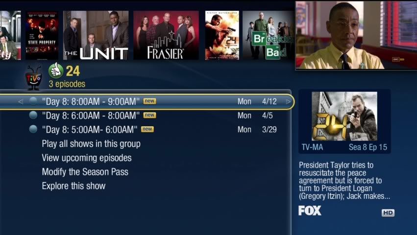

All series and custom series recordings are listed and prioritized in a menu called Season Pass Manager. Users rank their series recordings in that ordered list, and those rankings determine what two programs record when three or more conflict. If three programs conflict, the TiVo records the first two and searches for a later showing of the third program. The TiVo automatically records the next airing of the conflicting program, so long as it is shown again in the next 28 days.

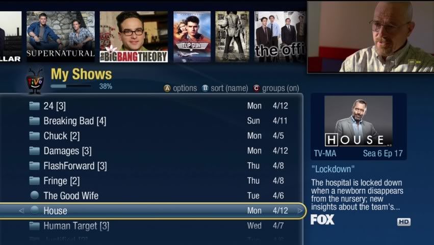

The list of recorded programs –called My Shows—is sortable by either name or date, toggled with one press of the remote. Multiple episodes of the same program are grouped into folders to reduce clutter. Within each program group, recordings are listed by the date recorded with their episode title. A disk space meter indicates the amount of space consumed by user-scheduled recordings.
Shown with name sort; click for high-resolution version. Click here for date sort.

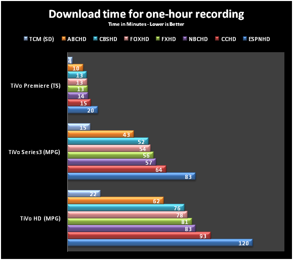

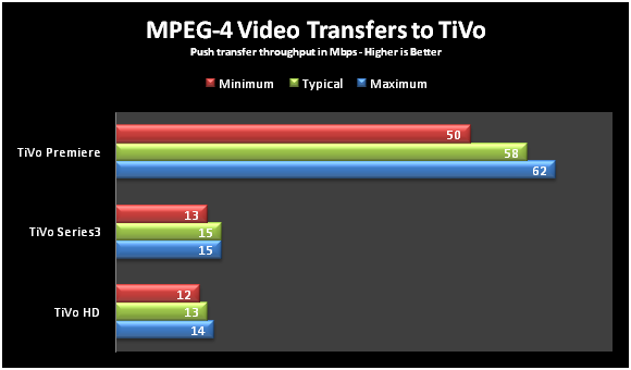

    The Premiere's "Series4" platform features a faster dual-core processor, 2D/3D graphics core, and memory bus, plus newer versions of almost every component. This new hardware provides three to six times the throughput for multi-room transfers and recorded file downloads.

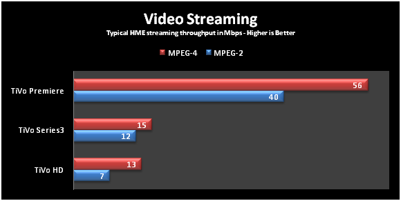

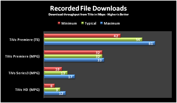

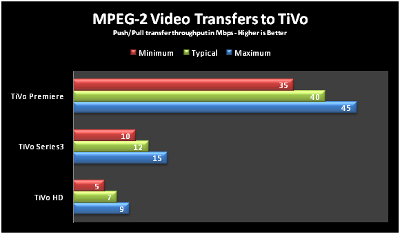

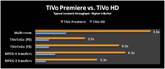

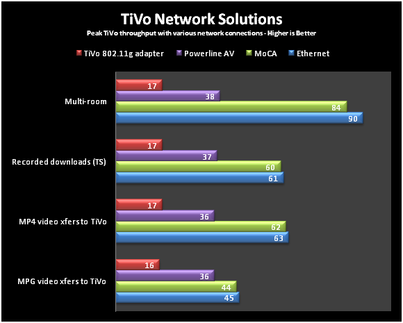

    Refer to the performance section below to see what impact the new processor has on network performance.

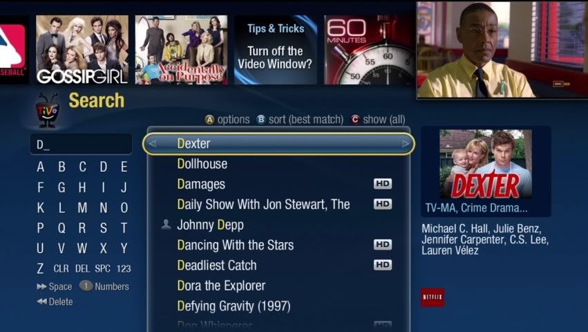

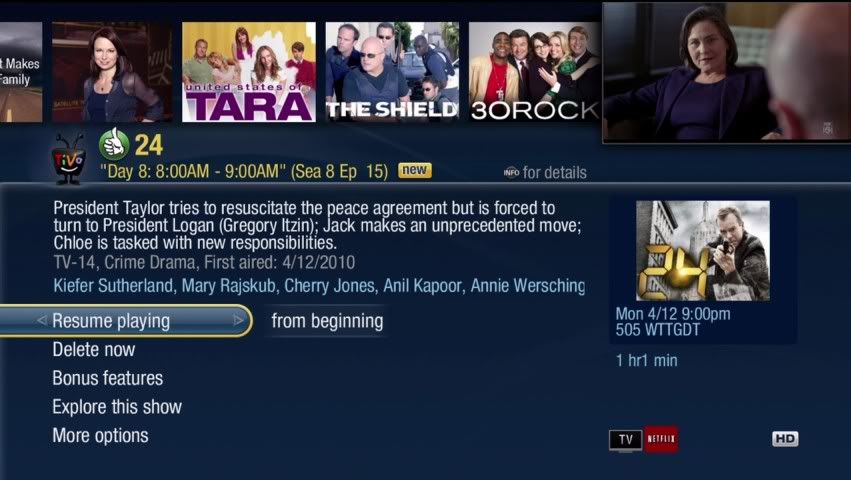

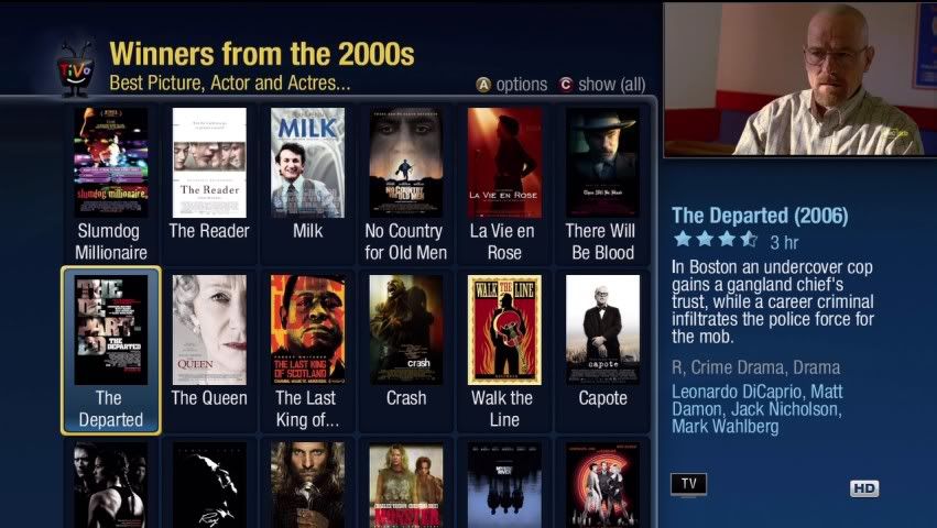

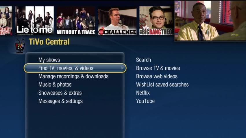

    The most obvious change with the Series4 platform is the interface. TiVo uses the faster processor in the Premiere to support a new high-definition interface with a video window, sharper fonts, and high-resolution graphics. Improvements with the new multi-pane interface include:
    • VIDEO WINDOW in the corner of all HD menus displays the current recording or live TV channel. Users can pause the video window, or toggle the window on or off from any menu using the SLO MO button on the remote. A settings option will disable the video window.
    • PREVIEW AREA in menus provides additional information about the selected movie, series, or episode without the need to transition to a new screen.
    • POSTERS and IMAGES throughout the interface make it easier to identify actors, series, and movies.
    • DISCOVERY BAR is shown at the top of many HD screens and displays suggested TV series, movies, collections, and TiVo tips, based on what is popular or similar to the selected program, or content previously recorded by the user. Limited customization is available at launch, and further customization is planned for future updates.

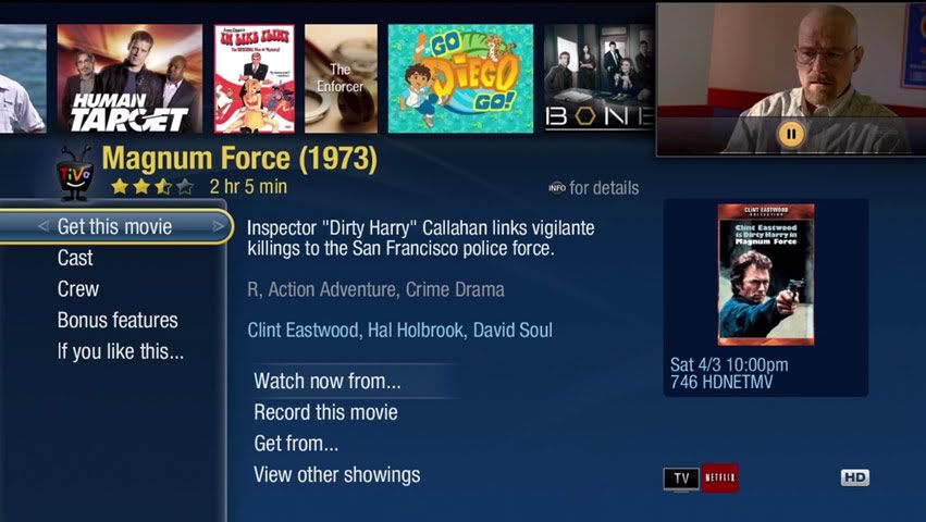

    • SEARCH integrates results for TV series, movies, actors, and web videos. Results include television programs showing in the next 12 days, as well as content from Internet providers enabled in Video provider settings. First word matches are no longer required, and the new engine searches every word in every title. By default, results are sorted and displayed by popularity to minimize the character input necessary; sort by name remains an option.

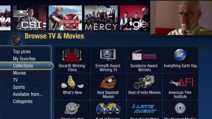

    • BROWSE TV organizes available and upcoming content into categories. Categories include traditional genre selections for TV series, movies, and sports, plus two dozen specialized “collections.” Collections include categories for award winners, what’s new, and most popular. As with search, the Browse TV menu displays those programs showing on television in the next 12 days, plus matching content from any Internet providers enabled in Video provider settings.
    • DISK SPACE METER on the My Shows screen indicates the percentage of disk space consumed by user-scheduled recordings. This disk space meter is enabled by default, but can be hidden.

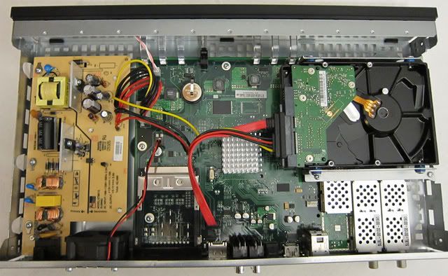

  3. What is inside the box?
    Click image for high-resolution 1600x1200 PNG.
    Code:
    1.  Broadcom BCM7413         System chip
    2.  Numonyx JS28F640P30B85   8MB Flash ROM
    3.  Micron 9WG27             128MB DDR2-800
    3b. Micron 9WG27             128MB DDR2-800
    4.  Micron 9WG27             128MB DDR2-800
    4b. Micron 9WG27             128MB DDR2-800
    5.  NXP SAA7164CE/3          Dual NTSC decoders + [email protected] encoders
    6.  Altera EPM3032A          CMOS EEPROM
    7.  Micron 46V16M16-5B       32MB DDR400 SDRAM
    8.  Micronas DRX 3944J       QAM/VSB demodulator w/ POD interface
    9.  Micronas DRX 3946J       QAM/VSB demodulator
    10. Microtune MT2131         Silicon tuner
    11. Microtune MT2131         Silicon tuner
    12. CMD2030-AOTR             HDMI 1.3 transmitter
    13. WD3200AVVS               320GB SATA-2 hard drive
    Second pair of DDR2 memory chips reside on opposite side.
    More high-resolution internal shots available here.
  4. How does processor performance compare to other DVRs?
    The Apple iPhone and iPhone 3GS are included for comparison.
    All DVRs atop the list are based on dual-core or dual-threaded CPUs. To achieve maximum performance on those platforms, the DVR software must be written and optimized to take advantage of both processor cores. Such optimization is likely to be an ongoing process.
    The Premiere is currently unable to deliver the performance shown above, as one of its two processor cores is disabled in the 14.1c software. TiVo expects to enable the second core with a software update later this year.

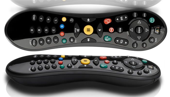

  5. What changes were made to the remotes?
    The new remote adopts the layout and design of the premium "Glo" remote, but adds four new buttons (yellow, blue, red, green). The new colored buttons act as shortcuts for various options in the new user interface. The ASPECT button was relabeled ZOOM.
    The DVR switch is no longer present, so it is not clear how one controls multiple TiVos with a single remote.
    Click for high-resolution version. Or click here to see XL remote.
    The TiVo Premiere remote has no backlight or IR learning capability, whereas the XL remote offers those features. Aside from silver trim on the XL remote, the aesthetics and ergonomics appear to be identical.
    Note a new variation of 30sec skip, called 30sec scan, is now enabled by default on the -->| button. Customers no longer need to enter a special remote code to enable this feature. For further information on changes to trickplay functions, see the user interface section below.

    The TiVo 802.11n adapter is available now ~$90 MSRP. It plugs into the Premiere's ethernet port, and functions like any other 802.11n wireless bridge. It does not occupy one of the TiVo's USB ports, but instead draw its power from an outlet using an AC adapter. The older 802.11g adapter is still compatible, but will not take full advantage of the Premiere's network connection.
    There is nothing to stop one from using a third-party MoCA or 802.11n wireless bridge, such as a Linksys or Trendnet gaming adapter.

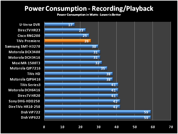

  11. As an ENERGY STAR compliant DVR, how many watts does the TiVo Premiere consume?
    With early software, the TiVo Premiere dissipates 23 watts in standby and 26 watts while recording.
    The System Information screen reports an internal temperature of 30-31C in room where the ambient temperature is 21-22C.

  14. What external drives are supported?
    The TiVo Premiere only supports the Western Digital My DVR Expander (eSATA), available in a 1TB version for $129 from Amazon.com, Best Buy, and Newegg. This adds 145-150 HD hours to the Premiere.
  15. Will the internal hard drive be upgradable like past TiVos?
    End-user internal drive upgrades are not possible with existing tools. DIY tools such as WinMFS and MFSLive enable capacity on larger replacement drives by creating a new partition with the extra space. Prior TiVos recognized the new partition and used it to store recorded programs. The Premiere does not, so new methods must be found to utilize the added capacity on a replacement drive.
    Weaknees and DVRUpgrade discovered such a method, and both offer pre-upgraded Premiere DVRs with 2TB (317 HD hours) capacity, as well as pre-prepared 2TB drive replacements. Weaknees also sells an internal plus external drive configuration with 4TB (639 HD hours). Both opted not to publicly disclose the new method or tools for competitive reasons, so DIY enthusiasts must wait for the appropriate method and tools to find their way into the public domain.
    For now, Western Digital’s My DVR Expander (1TB eSATA) is the only option to increase capacity, outside of pre-prepared drives sold by DVRUpgrade, Weaknees, and some ebay sellers.

  25. What changes were made to the main menu?
    All menus now shows a video window in the upper right-hand corner. This video window can be temporarily hidden, paused, or disabled.
    A second panel now displays options for the highlighted menu.
  26. What changes were made to the recorded list?
    The recorded list is now called "My Shows."
    A disk space indicator is shown just below the My Shows text and optionally hidden through a setting in in My Show Options.
    Programs are sorted by the user's choice of name or date, toggled with one press of the remote. Program folders/groups are also toggled on and off with one button press.
    A poster image, rating, and genre are shown for each selected program folder. For individual episode selections, the poster image, TV rating, episode number, episode title, episode description, and channel logo are shown in the right pane. Pressing PLAY on a highlighted recording bypasses the main information screen and starts playback. Pressing PLAY on a highlighted folder plays the contents sequentially, from oldest to newest, while pressing SELECT displays the folder contents (see below).
  27. What information and options are shown for a specific recording?
    Pressing SELECT on a highlighted recording opens the episode screen, where the rating, genre, key actors, and original airdate are shown as part of the description. In the right pane, the recorded date and channel are shown with the program duration and a poster image. For every recording, options are given to resume playing (if previously viewed) and start from the beginning.
    Pressing INFO shows more information, as in seen here.
  28. What is the new Browse TV menu?
    The Browse TV menu organizes available and upcoming content in a range of categories. Categories include traditional genre selections for TV series, movies, and sports, as well as twenty specialized "collections." Collections include Oscar winning films and Emmy winning TV series for each decade, Sundance award winners, what’s new, fun for foodies, date night, ’09 box office blockbusters, and animated classics.
    Click for high-resolution version. Click here to see the movies tab.
    The user can mark specific categories as favorites, and those categories appear under the second menu, My favorites.
    Selecting a subcategory on the BrowseTV menu displays the programs showing on television in the next 12 days, plus any matching content from Internet video providers enabled in settings. A button on the remote toggles content display between all, free, and watch now. "All" lists results for TV, plus any programs from enabled video providers; "free" lists results for TV and Netflix; and "watch now" lists content available from Netflix, Amazon, and Blockbuster VOD.
    Click for high-resolution version. Click here to see the 4 star movies results.
    The user can highlight any program to view a description. An icon at the bottom right of the screen indicates the source of the program, be it TV, Netflix, or some other pay provider (if enabled).
    Pressing SELECT displays the main screen for the program, with options to watch or record.
  29. What changes were made to search?
    Search displays results for shows, movies, web videos, and actors. First word matches are no longer required, and the new engine searches every word in every title of every program.
    Click for high-resolution version. Click here for a two-character search example.
    By default, search results are listed in order of popularity. A button on the remote toggles between sort by popularity and sort by name, while the button toggles between all, free, and watch now. "All" lists results for TV, plus any programs from enabled video providers; "free" lists results for TV, web content, and Netflix if enabled; and "watch now" lists content available from Netflix, Amazon, and Blockbuster VOD. Selecting a search result opens a screen for the actor, movie, or television series.
    Each series screen includes menu selections for Upcoming, Episode guide, Cast, and Bonus Features. The “Upcoming” menu lists episodes on television in the next two weeks, with new episodes identified by an icon; episodes scheduled to record are marked as such with another icon. The “Episode guide,” shown below, lists all series episodes by season; when a specific episode is highlighted, icons indicate whether that program is upcoming on TV, available for instant streaming from Netflix, or available for purchase from Amazon. The “Cast” menu lists the actors and actresses with portrait images; clicking SELECT on a portrait opens the search screen dedicated to that actor or actress.
    Movie screens in search display menu selections for Cast and Crew. As with a series, “Cast” lists the actors and actresses with portrait images; clicking SELECT on a portrait displays the screen for the actor. “Crew” lists the director, writers, and producers with portrait images, when available.
    The actor screen, also used for crew members, offers limited biographical information and a portrait image, plus menu selections for TV, Movies, and if applicable, Production credits. Each menu displays the corresponding content showing on television in the next two weeks; it also displays any content with the actor or crew member from Netflix, Amazon, and Blockbuster, if those video providers are enabled.

  31. What do you see when you select a MOVIE in search?
    In addition to the MPAA rating, genre, and key actors, the main screen for a movie displays options to schedule a recording, "Watch now from Netflix," and/or "Get from" Amazon or Blockbuster, depending on where the program is available and what Internet video providers are enabled in settings.
  32. What do you see when you select a SERIES in search?
    When you select a SERIES in search, the program screen for that series is displayed.
    Video window turned off in above shot. Click for high-resolution version.
    This program screen includes submenus for upcoming episodes, episode guide, and cast. Click links for screenshots.

  37. How does multi-room viewing compare?
    The current implementation of multi-room viewing on the TiVo Premiere is just like that on the TiVo HD and Series3, except it is much faster. Typical multi-room throughput on the TiVo Premiere is three to five times that of the TiVo HD, reaching as high as 90Mbps.
    All Premiere tests run under Classic interface in 14.1-01-3-746.
    At such high throughput, MRV on the Premiere works very well for unprotected content. Unfortunately, the TiVo Premiere does nothing to address the issue of protected recordings, as it still relies on copies which CableLabs’ expressly forbids on such content. CableLabs only permits streaming of protected content and only with certain forms of encryption (ex: DTCP-IP).
    Federal law requires that recordings from local channels be left unprotected, but also gives cable providers free reign to protect what they want on cable channels. Some large providers, including TWC and Brighthouse, now protect virtually all of the cable content on their systems, rendering it incompatible with the current multi-room implementation on the TiVo Premiere.
    If TiVo has any plans for multi-room streaming with DTCP-IP, as Moxi introduced last year, they aren’t saying. Confronted on the issue, TiVo acknowledged the serious problem of copy protected content, but would not say what they were doing to address it, or when customers might see a solution.
  38. How do recorded file downloads (TiVoToGo) compare?
    TiVo serves up the recorded files for unprotected content through a built-in https server. This server and its file transfers run as a background process, so they do not interfere with the operation of the DVR. With the TiVo Premiere, you can record two different HD channels, watch a previously recorded HD program, and download a HD recording to your computer over wireless, all at the same time.
    A common complaint about download capability on past TiVos related to its “speed” or throughput. Network throughput on older TiVos was limited by CPU performance and system I/O, and further reduced by the on-the-fly remuxing into MPG. Recordings on the TiVo are stored in a proprietary transport stream format, and TiVo decided it was best to remux these transport streams into a PC-compatible MPG. Remuxing of the transport stream into MPG format doesn’t affect quality, but it slows the transfer considerably since it is done in real-time as a low-priority background process.
    The TiVo Premiere significantly improves download throughput through the combination of the improved processor, superior I/O, and the ability to download in MPEG-TS format. First seen on Australian TiVos, downloading in transport stream format minimizes the on-the-fly processing needed for the TiVo to send a recording to a computer. The result is significantly improved throughput.
    The current version of TiVo Desktop 2.8 does not support TS downloads, so anyone using that program will only see the TiVo Premiere (MPG) rate noted above. For now, TS downloads are only possible through the third-party kmttg program or the TiVo’s built-in https server. A video comparison of download throughput on the Premiere and TiVo HD is found this page at Youtube.
    Assuming one uses kmttg or the TiVo’s built-in https server to download recorded files, they can expect download times comparable to those below. Be aware that these results were obtained under the stock 14.1c software with the classic UI; results could change with future versions of the software.
  39. How do PC video transfers to the TiVo compare?
    The Premiere dramatically improves the performance of video transfers from computer to TiVo. MPEG-2 transfers are now up to 40Mbps. MPEG-4 transfers are up to 60Mbps.
    The MPEG-2 numbers shown above apply to "pull" transfers for PC videos and recordings selected through the TiVo’s recorded list using TiVo Desktop and pyTiVo. It also applies to recordings "pushed" to the TiVo using pyTiVo or Streambaby. I was able to watch Elephants Dream from w6rz.net in full 1080p24 via both push and pull with no delay, once the TS file was remuxed into MPG format with Streamclip.
    With this level of performance, it is finally feasible to download and store recordings on computer storage for playback. High-definition MPEG-2 recordings from antenna and cable run a maximum of 19Mbps, meaning the Premiere can pull those recordings back from a computer at twice real-time.
    These numbers apply to MP4 videos "pushed" to the TiVo using pyTiVo, Streambaby, or TiVo Desktop’s auto-transfer folders. It is not known whether the Premiere possesses the ability to pull MPEG-4 files directly from the recorded list; if it does, no tools exist to take advantage of that capability.
    Be aware that TiVo Desktop Plus will only push MP4 videos with AAC audio. It re-encodes MP4 videos with Dolby Digital audio into MPEG-2, slowing the transfer to MPEG-2 rates, assuming your computer can re-encode the video fast enough to keep up. Streambaby and pyTiVo will both push MP4 videos with full Dolby Digital 5.1 audio as is, without processing.
  40. How does streaming performance compare?
    Streaming throughput is the same as it is for the push/pull video transfers compared above -- a max of 40Mbps sustained for MPEG-2 and 60Mbps sustained for MPEG-4.
    TiVo does not yet offer built-in support for streaming PC video playback. Enthusiast Kerry Griffin sought to fill the void with his own streaming video application for the TiVo. Dubbed "Streambaby," the free Java applet allows HD TiVo owners to browse, play, and fast forward through virtually any kind of video file stored on their computer, without waiting for any transfers. Compatible videos – such as MPG and MP4 files—are available for streaming at full quality, while other video files are converted to MPEG-2.
    With past TiVos, streaming throughput was so slow that users were forced to compromise on playback quality. Most HD video files had to be recompressed on the fly – with quality loss—to fit within the throughput limits of those boxes. With its superior throughput, the TiVo Premiere eliminates the need to compromise quality during streaming playback of most videos.
    The Streambaby application does have one key limitation—a 1.1GB streaming limit. It must pause for several seconds and re-buffer after every 1.1GB streamed. The TiVo Premiere does not eliminate the 1.1GB buffer limit in Streambaby. That limitation is specific to Streambaby, and won’t be addressed until TiVo makes the appropriate documentation available.

  42. What is the best way to network the TiVo?
    The TiVo Premiere’s new HD interface requires a network connection. The network connection is used to retrieve guide data, poster images, and other content from the TiVo’s Internet servers; it is also used to search available content from Amazon, Blockbuster, Netflix, and other online sources.
    The Premiere has a single 10/100Mbps ethernet port. It has no built-in wireless. For those customers unable to run an ethernet cable directly to the Premiere, TiVo offers wireless adapters in 802.11g ($40) and 802.11n ($90) versions. The 802.11g adapter plugs into one of the TiVo’s two USB ports, while the 802.11n adapter connects to the TiVo’s ethernet port and draws power with a separate AC adapter.
    Tested throughput with TiVo’s 802.11g wireless adapter varied from 12Mbps to 17Mbps with a D-Link DIR-655 router, depending on distance and location. As evident from the chart above, 802.11g wireless is unable to take advantage of the improved network throughput on the TiVo Premiere.
    Powerline networking with a pair of Netgear Powerline HD adapters yielded double the throughput of the TiVo 802.11g wireless adapter, but only a fraction of the 200Mbps claimed by the product. File transfers between two computers, networked with the same adapters, produced similar results.
    Another alternative to wireless networking is Multimedia over Coax Alliance (MoCA). Popular among A/V enthusiasts, MoCA creates a 150+Mbps network over the existing coax cable in one’s home. Each MoCA adapter has COAX IN, COAX OUT, and a 100Mbps ethernet port. The coax from the wall connects to the COAX IN on the adapter; the COAX OUT and ethernet ports connect to the TiVo Premiere. One can also run ethernet from the MoCA adapter directly to a 100Mbps switch with 4+ ports to network additional devices. The same wire configuration is repeated for each room with a TiVo Premiere, or where a high level of throughput is desirable and a direct run of ethernet cable is not possible.
    In homes with cable service, one additional MoCA adapter is required to connect one’s Internet router (i.e. Internet connection) to the MoCA network. Rather than running coax direct from the wall to the cable modem, the coax runs to the COAX IN on the MoCA adapter and the COAX OUT connects to the cable modem. An ethernet cable connects the cable modem to the WAN port on the user’s router; an ethernet cable from the MoCA adapter connects to a LAN port on the router. Diagram. In a home with Verizon FiOS, no additional MoCA adapter is required, as the Verizon-supplied Actiontec MI-424WR and Westell 9100EM routers incorporate MoCA in their design. Diagram.
    Multimedia over Coax Alliance (MoCA) adapters from Netgear and Actiontec are sold by Amazon.com and other Internet resellers. Adapters typically cost $75 to $90 each, or $140-$180 in packs of two. Verizon FiOS routers with built-in MoCA, like the Actiontec MI-424WR, also function as MoCA adapters; when available for $20-40 on ebay, these represent an affordable alternative to retail MoCA kits. The Actiontec MI-424WR has one coax input and no output, so a separate 1GHz or 2GHz splitter is necessary if using that device in place of a retail MoCA adapter; the coax from the wall is connected to the splitter, with one splitter output going to the Actiontec and the other to the TiVo or cable modem.
  43. How does the new HD UI affect network throughput?
    Preliminary tests show that download throughput is much more inconsistent under the new high-definition interface, with frequent drop-offs of 20% to 30%.
    The second of the Premiere’s two processor cores is temporarily disabled under the current TiVo software for stability reasons. TiVo plans to re-enable the second core with a future software update, but it is unknown what impact that will have on network throughput. If throughput is currently I/O limited, rather than CPU limited, than enabling the second core may not do much to improve throughput. On the other hand, if throughput is CPU limited – as appears to be the case when running the HDUI—then enabling the second core could noticeably improve network throughput.
  44. What is the power consumption?
    The TiVo Premiere consumes 23 watts in standby and 26 watts while recording under the 14.1c software. This represents a substantial reduction from the TiVo HD, Series3, and many older cable DVRs, and it was sufficient to meet the ENERGY STAR tier1 specifications that took effect on January 1, 2009.
    The Premiere does not meet the more stringent tier2 specifications that take effect on January 1, 2011. There is no “grandfather” rule for ENERGY STAR certification, so all units manufactured after January 1, 2011 must meet the new standards if they are to carry the ENERGY STAR logo.
    If TiVo intends to manufacture and sell the Premiere after January 1, then it will need to revise its design, or find some solution to reduce total daily consumption in order to meet the new ENERGY STAR requirements. The tier2 energy allowance for a product like the TiVo Premiere should work out to roughly 160kWh/yr, or 18 watts average consumption if no sleep or idle mode is used.

I can't imagine there is much practical difference between the XL and the standard unit. The THX cert shouldn't amount to anything.
I hope you can easily swap the HD's on these. Buying the cheaper one and swapping in the larger drive from my S3 would be tempting. I'm anxious to see what these support via e-SATA and internally as well. I'm capped at 2TB now.

Originally Posted by b_scott View Post
I don't think that's true. I almost always transfer faster than real time
The older TiVo Series3 can always transfer in realtime, with throughput of 25+Mbps. The TiVo HD has less memory bandwidth (refer to second chart) which reduces throughput to 16-24Mbps, depending on what is being done with the DVR. That allows real-time transfer and viewing for content compressed by broadcasters and cable providers at <16Mbps, but won't always do so for higher-bitrate content.
Note streaming also requires more than real-time throughput to function effectively with full trickplay control, including the ability to 30s skip, FF, and REW through remote recordings.
