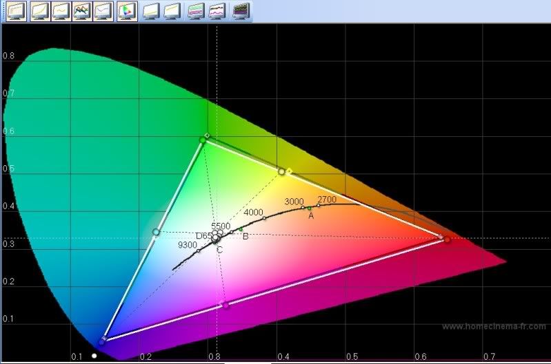

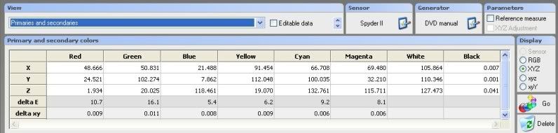

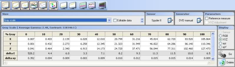

these are the measurements after Bob did all the changes to the set. If you follow Kal's gude of grayscale for dummies, grayscale is very close on being with in tolerable deltas, only two IREs is above 10 delta, so technically I could've had left it like this.
And here are the measurements for colors, once again they are very respectable.

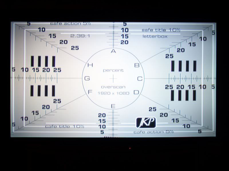

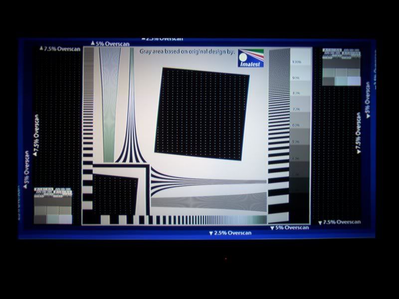

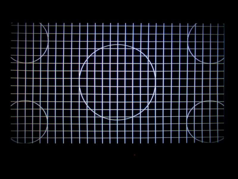

I first touched up on the covergence and adjusted the circles to a tolerable error, they are very close.
Overscan changed, now it is at 0% in the bottom, not intentionally but that's the way it turned out.

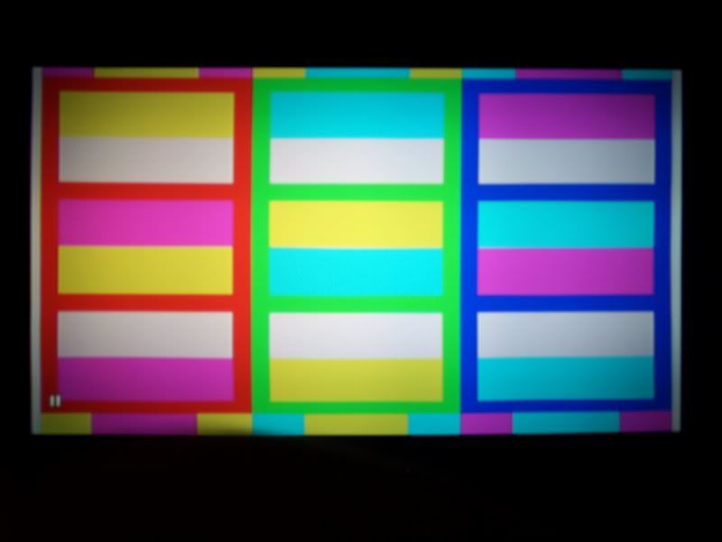

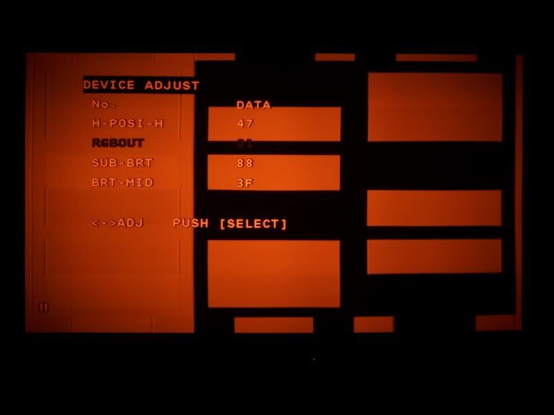

Here are some shots of the color decoding. It looks better in person than in the shots and based on the readings green needs to be adjusted ... work for another day.
And I learned ... the pattern I was using is JUST for blue. (don't laugh too hard Bob).

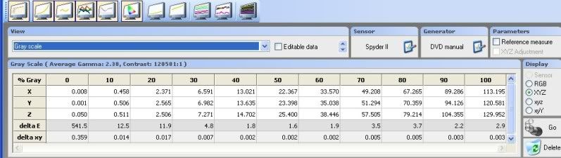

After touching up grayscale and color here are the measurements.

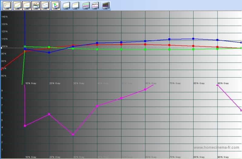

Here are the graphs.
These first ones are before I touched it up:

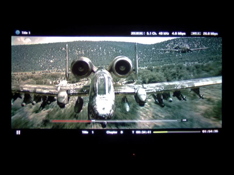

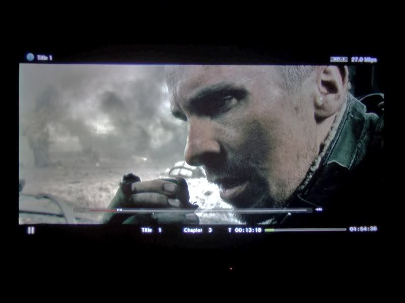

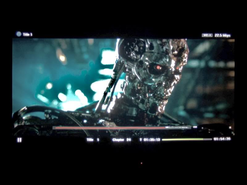

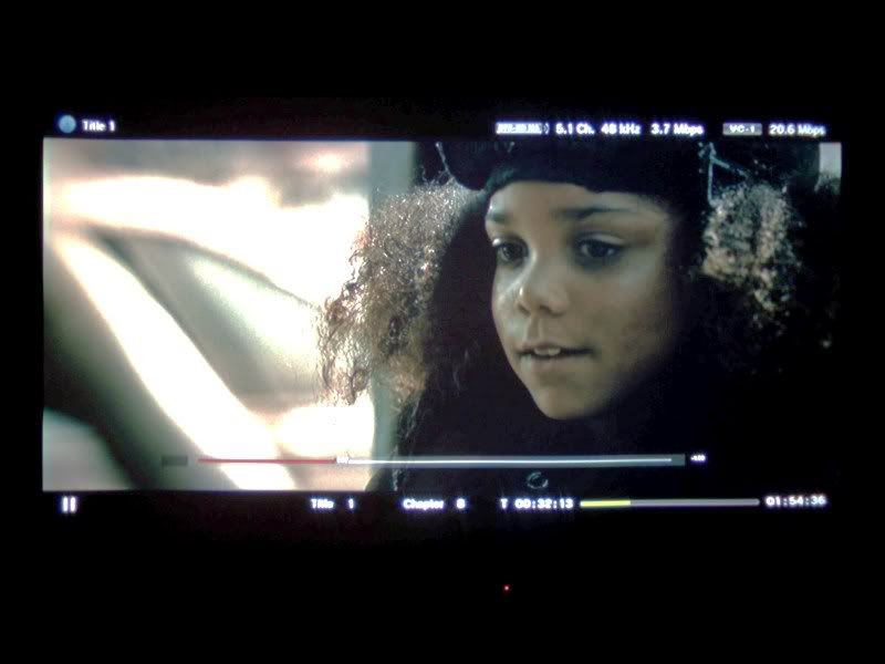

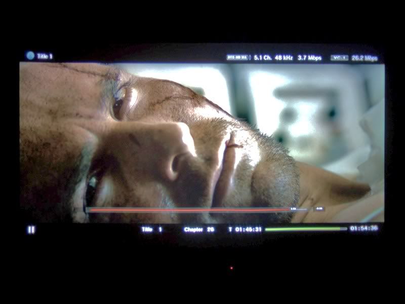

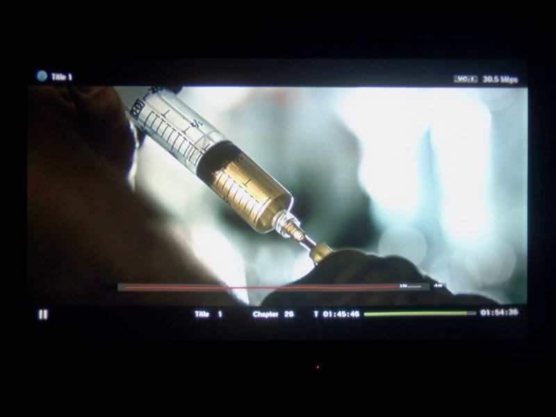

And finally some screen shots, maybe not the best material, Terminator Salvation, the entire movie has a dull greyish feel, but thats what I've picked so thats what it is.

Hey superleo,
those calibration numbers look super (leo) with all your delta E for grayscale and color, even your gamma is more inline too. I could not get my delta E for 10 to 30 ire as close as yours. If you may I have a couple of questions:
Can you post a zip file of your hcfr cal here? I'd like to see the whole shebang, others might too...
In the "display" of HCFR I noticed you used "XYZ" I believe you are to use "xyY"? Maybe it really doesnt matter, I dont know...
Did you use the spyder II, and how long was your read time for the 0, 10, 20,30 ire windows?
Anyway, you and Bob did a nice job.... Is the difference subtle or great overall compared to where it was before this last calibration?

Comparing the prior and after pictures posted here it looks like your mechanical focus was off and Mr. Bob raised the sharpness quite a bit.
Just for fun I'm attaching some of my calibration files.
I use pro mode on my pioneer elite as it allows to me to get rid of false contouring of STD mode. Though STD was used initially to get the set calibrated to 2.22 average gamma and then using greyscale controls in user menu calibrated the pro mode. I also attached calibration file with correction applied to greyscale on PC (PRO mode on Pioneer) and PS3 in RGB mode over HDMI with Pure digital enabled (STD mode on Pioneer). Basically color decoder is out of the picture and therefore no way to control color/tint(not needed really) minus sharpness control (that kind of sucks). I found it's the best to use excel calculator for color adjustments where primaries can be entered to calculate secondary targets (available in calibration thread). Color errors are minimal in RGB mode with Pure Digital enabled (though it's hard to judge with only colorimeter in hands). BTW I keep the screen shield on my Pioneer and it's tinted, so I loose about 20% of light output. I tried recommended 30-40ftL range but it's way too bright for me as I watch my tv with light turned off.
Thanks, I appreciate the comments. I know this is what everyone says about their sets, but I can tell you that it really looks great after Mr. Bob's work and final (never final) touchups. I still want to get primaries alittle tighter, well green in particular, I think blue is where it needs to be (thanks again to Bob) and red, for these sets is excellent.
These Hitachies only have Blue CUT no Blue DRV, so once you get it close on the low end anything you do on the high end really affect the low end. I have it at one click adjustment either way (like Bob would say), but I'll keep trying to get it closer.
I'll take some reading with the Eye-one, thus We, LastButNotLeast and I, already did some comparisons between the Spyder and the Eye-one, and if you give the Spyder enough time to read, the differences are minor, at least with my SpyderII.
Another thing to consider on my set; I do not have any external processor, all the adjustments are directly from the set and the Hitachi's electronics, at one time or another I've considered adding a Lumagen or the likes for gamma and color adjustment but the itch hasn't been bad enough I guess.
Your numbers are great, although with an external processor, not easy, but easier to obtain, nonetheless outstanding.

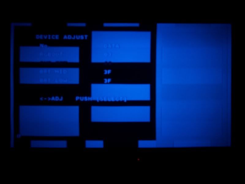

Leo -
Looks like your blue is not fully optimised. The red and green are pretty close, and perhaps altering the blue will make them fall into place perfectly.
But the blue does not look fully right, in these pix -
