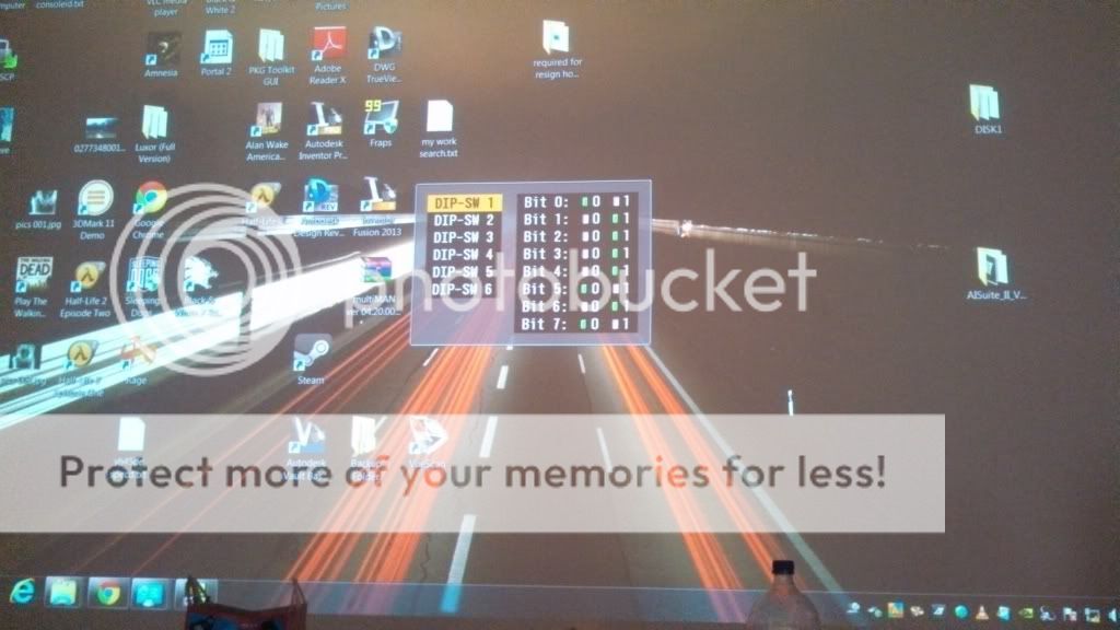

Thanks spowers777, I was able to get into the hidden menu now. Moved to DIP-SW6 and set Bit 5 to "1" (green bar on the "1"). Still no submenu called Extended. I went back to the hidden menu to check Bit 5 and it is still at "1".
BTW My other bits under DIP-SW6 were at follows:
Bit 0: "0"
Bit 1: "1"
Bit 2: "0"
Bit 3: "1"
Bit 4: "0"
Bit 5: "0" --> set to "1'
Bit 6: "0"
Bit 7: "0"
nphan is offline

The DP-SW settings don't unlock the "Extended" menu
First off, thanks for posting info on how to get into the secret menu. I at least had hope that I could converge the colors like the more expensive models in the family. It makes no sense to me why Epson did not include that option on the lower models.
Here's the bad news. I have a buddy with the Epson 8500 that has the Extended menu that allows you to converge colors at different points on the screen. You can look up the users manual if you want to see how it works. I had him get into the hidden menu and check his dip switch settings. They are exactly the same settings as the 8350 you have posted above as well as the 8100, the model I have.
So my only conclusion is that the dip switch settings in this hidden menu are not the way to expose the Extended menu. Also, the fact that Epson sends used replacement projectors to people and don't bother to check and calibrate the convergence leads me to believe that there might not be a way to do it, or they're really lazy.
If anyone finds a way to converge the colors, please post it here.
On a positive note, playing with the advanced sharpness settings did help a lot to hide the misalignment. Just a few clicks to the left helped mine.
