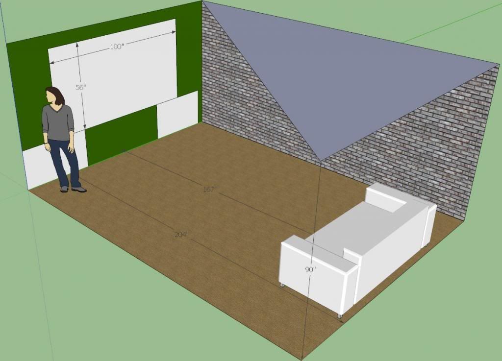

My main question now is projector placement and if that has any effect on my projector choice. I have decided on a 115" diagonal 16X9 screen, and my room dimensions are below, along with some photos for reference.

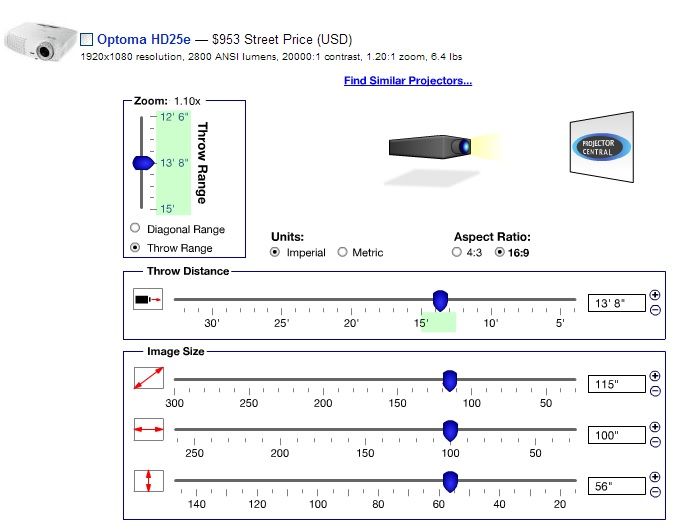

If I used the calculator here properly it looks like the Optoma HD25e will allow me to mount the projector further back in the room:
I could not find the HD131Xe in the calculator's options but I assume it is the same as the HD25e.
The calculator does not specify mounting height, is that something I need to take into consideration?
Given that I would like the projector mounted as far back in the room as possible, does that eliminate the BenQ W1070, or did I miss something?
Between the Optoma HD25e and the HD 131Xe, is there a large difference between the two for my room, and also in terms of picture quality?

Go to the full PC website and use the pro calculator and it will show you image offset for any projectors that have a fixed offset, as long as it is known....
http://www.projectorcentral.com/Optoma-HD25-LV-projection-calculator-pro.htm
http://www.projectorcentral.com/Optoma-HD131Xe-projection-calculator-pro.htm
http://www.projectorcentral.com/BenQ-W1070-projection-calculator-pro.htm
Anyway, it works out to 9" for the HD25 as well as 9" for the HD131Xe (same zoom range).
The W1070 has closer throw and it has a bit of optical lens shift that allows the lens to be a few inches above the top of the screen. If your ceilings are low, or you want the screen higher, this is a really nice feature.
All measurements and calculations are measured from the front center of the lens itself. Throw distance, offset, etc.
It's worth saying that your screen is a bit small for your seating distance, but it does look like you are perhaps a bit limited on wall space. I would try to go a bit larger if possible.
