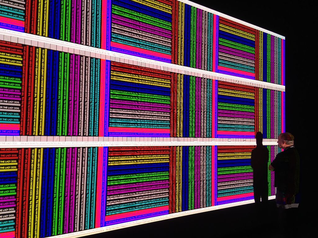

CHRISTIE ECLIPSE HIGH CONTRAST 4K HDR RGB LASER PROJECTOR | REVIEW
SUMMARY:
Not only is this without a shadow of a doubt the best video projector in the world, this is quite literally the best video image performance that I have ever seen in my life to date. Period. End of story. Goodbye. The End.
It significantly outperforms not only all other projectors, but also all other video display devices that I can think of with respect to overall video performance, across all formats, from televisions (whether OLED, LED LCD, MicroLED or otherwise) to modular emissive video walls.
In my opinion, this is the new video reference gold standard against which all other video displays should now be compared. It is quite literally the ultimate video display and with it Christie has set a benchmark of near insurmountable Everest proportions.
MEASUREMENTS:
CONTRAST:
ON/OFF contrast and ANSI contrast by no means tell you the whole picture as far as contrast performance of video content is concerned. Why? Because neither ON/OFF nor ANSI are in fact directly applicable with respect to actual video content. ON/OFF contrast and ANSI contrast are the two extremes of the contrast range that relates to video content. The ON/OFF Contrast only gives you the black level on a completely black picture. Whilst this is useful with respect to obtaining and comparing what is best black level performance capability of the particular display device, this does not tell us what is the typical contrast and/or black level performance for the majority of actual video content. Similarly, the ANSI Contrast only gives you the black level at what is typically the extreme upper limit of video content brightness. Hence, typically over 99% of video content falls within these.
Consequently, in order to gain a proper understanding and to be able to properly assess and evaluate what is the comparative contrast and associated black levels performances regarding different display devices we really need to be taking measurements with respect to the contrast performance in-between the ON/OFF and ANSI contrast; namely the full range of ADL (Average Display Level) contrast.
Where ADL is defined as being the average on-screen brightness after gamma correction; and the ON/OFF contrast corresponds to an ADL of 0%, and the ANSI contrast corresponds to an ADL of 50%.
The following contrast measurements were taken at actual usage light output levels:
NATIVE ON/OFF CONTRAST = 21,150,500:1
1% ADL = 83,649:1
2% ADL = 44,545:1
3% ADL = 34,730:1
4% ADL = 19,461:1
5% ADL = 15,452:1
10% ADL = 8,228:1
20% ADL = 3,771:1
ANSI CONTRAST = 1,035:1
To put things in perspective as far as comparative contrast performance is concerned. I've had to make the CONTRAST axis logarithmic in order to be even able to fit the Christie Eclipse's crazy contrast performance onto the chart! And by the way, this is the DYNAMIC Contrast performance of the best performing SONY and JVC home theater projectors versus the NATIVE Contrast performance of the Christie Eclipse:
LUMINANCE:
● PEAK LIGHT OUTPUT = 30,000 LUMENS
● 5.365m / 17’ 7” WIDE 0.9 - 1.0 GAIN SCREEN , WITH CIRCA 16,500 LUMENS LIGHT OUTPUT:
- WHITE LEVEL = 440 NITS
- BLACK LEVEL = 0.00002 NITS
GAMUT COVERAGE:
● %AGE OF BT.2020 COLOR GAMUT = 92.2%
- Both the RED and BLUE are beyond BT.2020; with the GREEN falling slightly short:
INPUT LAG:
● LATENCY = 16 ms
PHOTOGRAPHS / SCREENSHOTS:
All of the photos have been taken using a professional photography calibrated flagship Nikon camera, in HDR, as unprocessed and unedited raw images, accurately capturing the actual projected image black level, with the white balance precisely matched to the projection screen. Hence, with respect to these aspects, in addition to the image sharpness and detail delineation, the photos are accurately representative of what the projected images look like in person.
However, despite using HDR photography, the magnitude of the luminance dynamic range of this projector is so incredibly large that it was impossible to capture the full extent of this; and also similarly the chroma (color) gamut coverage of the projector is very considerably wider, deeper, and greater than the capabilities of the camera. Hence, with respect to these aspects the photos are by no means even close to what the projector looks like in person in these regards; where the only way to see what are their actual respective performances is to view the projector in person.
(N.B. in order to view the images with the best accuracy this is best done via a calibrated video display)
*** If viewing this using your a mobile device you can simply zoom in with respect to the photos to see them in their full high resolution; or alternatively to view and/or grab the full size photos simply right click on whichever image and select VIEW IMAGE from the menu window. You can also then left click to zoom in and view the image in 1:1 ratio ***
ANALYSIS & GENERAL PERFORMANCE SCORES (OUT OF 100):
● MASCIOLA HDR10 SINGLE PIXEL 4K RESOLUTION TEST PATTERN PERFORMANCE : 100
N.B. THE COUPLE OF SMALL SMEARS ARE DUE TO THIS BEING A PRE-PRODUCTION PROTOTYPE AND WILL NOT BE PRESENT WITH THE PRODUCTION UNITS
● QUICK BROWN FOX TEST PATTERN PERFORMANCE: 100
● NATIVE 4K SINGLE PIXEL GEOMETRY TEST PATTERN PERFORMANCE: 100
● BLACK PLUGE TEST PATTERN BLACK LEVEL PERFORMANCE: 100
● WHITE & BLACK GRID TEST PATTERN PERFORMANCE: 100
● INTERSTELLAR SDR HD-UPSCALED-TO-4K-UHD (00:53:30) PERFORMANCE: 100
● JOURNEY TO SPACE HDR 4K (00:35:50) PERFORMANCE: 100
● SHARPNESS & MTF: 100
You can quite literally see the native 4K pixel structure in absolute perfect razor sharpness throughout the entire image for all 8,847,360 pixels. The projected image quite literally cannot be any sharper!
● FOCUS UNIFORMITY: 100
● CHROMATIC ABERRATION: 100
● IMAGE UNIFORMITY: 100
● RGB PIXEL/PANEL ALIGNMENT: 98
● POSTERIZATION (BANDING): 100
● BLOOMING: 100
● STREAKING: 100
● VIDEO NOISE: 100
● MOTION PERFORMANCE: 100
● GAMING PERFORMANCE: 100
TOTAL SCORE = 100
MISCELLANEOUS INFORMATION:
● Initially THREE versions will be available, being: 9,000 lumens; 17,500 lumens; and 26,000 lumens.
● Laser modules will be contained within a separate rack with dimensions W78cm x D80cm x H69cm.
● The laser module rack is liquid cooled, completely silent operation, and comes with 8m or 10m length fibre that connects to the projector head, which can be extended up to 50m long.
● There is an external chiller; this is not silent and can be situated up to 30m away.
● The projector head is big and noisy, so needs to be installed into a projection booth / room. It starts at about 64 dBA but rises from there at higher brightness and ambient temperature environments
● There is only a very small few percentage light loss post-calibration, because out-of-the-box the projector is already very close to D65 white point.
● Speckle is a non-issue. With unity gain screen there is absolutely no perceivable speckle whatsoever; hence, there is absolutely no need to any anti-speckle systems / solutions. The manifestation of speckle has been minimized as a consequence of utilizing multiple different wavelengths of laser diodes for each of the red, green, and blue, in conjunction with avoiding usage of a high gain projection screen material.
● Black levels are so black that there is absolutely no need whatsoever for any masking of black bars; and you literally cannot see where is the divide between the edge of the projected image where there is black and the outside of the projected image where there is no light being projected at all.
● The world-record-breaking projected contrast and black levels performance has been achieved via use of the same patented technology that features within the Dolby Cinema projectors; which is akin to the Full Array Local Dimming (FALD) that some LED LCD TVs utilize. Where, with respect to this projector, there numbers 2,073,600 dimming zones.
● Color depth: 12-bit
● Supports 4K60 with low latency.
● OPTIONAL UPGRADES (with associated one-off additional costs):
- CHRISTIE MIRAGE: adds both High Frame Rate (HFR) 4K120 support and either active or passive (your choice) 3D functionality, with 4K60 into each eye if active; with very high brightness and essentially zero cross-talk.
- CHRISTIE VIEW GAMING: In addition to supporting single player gaming at 4K120 (wherein it is worth noting that it has been confirmed by SONY that the upcoming Playstation 5 will support 4K120 gaming), via use of active glasses you can have 2 players see the whole screen at 4K60, but a completely different screen to everyone else, in other words it will be akin to each of the 2 players having their own full size Christie Eclipse gaming screen at 4K60.
● Multiple lens options covering a wide array of throw distances versus screen sizes
● 3-year warranty.
● It is Class 1 Risk Group 3.
● Shipping 2nd Quarter 2020.
