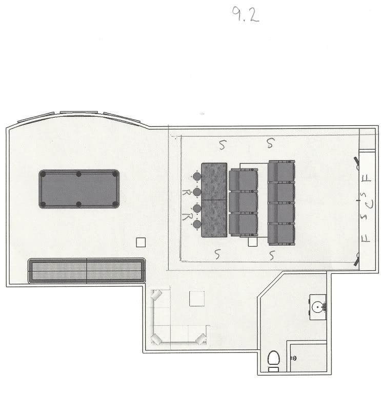

The room is 44' long but as you can see only half will be used for the theater. I have yet to buy the components so I am currently debating if 9.2 would work better for this room or is it overkill? I welcome all input...
Because of the setup, the speakers will be in the ceiling.... The "square" around the seating are soffits.

Diminishing returns. Not sure it would provide an improvement that was noticeable let alone worth the additional cost and trouble. The listening area isn't all that big.

Where would you locate the sides in a 7.2 setup like mine...AND does your view change if I tell you that the small square next to the 3 seats is a 12x12 concrete pole that will be in the way, as an example in the 7.2 the 2nd row would be partially blocked....
thanks.

I would start by trying them where you show the second set of side surrounds in your 9.2 setup and experiment between that starting point and inching them forward until they are parallel with the back of the second row seats....if it weren't for that pole! Sheesh, 12 X 12, that's a pretty big hole in the sound field that close to the seating.
Given the pole, I think I'd start experimenting at the front edge of the front seats and moving them as far rearward as the front seat backs. That way, at least the front row gets an optimized sound field. I assume the front row will be the first ones occupied if you don't have a big crowd watching. Only experimentation will tell you the optimum position.
How high is the ceiling under the soffit?

Pardon my ignorant interruption, but isn't your 9.2 setup really 7.1 with extra surround speakers and sub? What I mean is, do you have the extra horsepower and management needed to balance all that? (not that you don't; obviously, I don't know.)
That is to say, for this to work right, you aren't planning on just splitting your surround wires to power two speakers are you? (or wire them in series, for that matter.)
Or maybe I don't have any idea what I'm talking about...
I guess what sparks the comment is that the only 9.x playback system I'm familiar with is PLIIz, and your pictures don't show that, so I assume this is totally custom, yes?

Do you guys think the OP would be better off having one pair bi/diole speakers for his side surrounds as opposed to 1 or 2 pairs of monopole speakers. Just thought this might give a more enveloping experience for him especially if he placed the null where the 12X12 pole is located and then the other speaker directly across from that one.

Flick I have now started looking into that option....anyone have experience in something similar to my set up?

I have something like that, but my pool table is to the right where your bathroom is, in a space 14ft wide, 21ft long open to the seating area. (the whole right side of my seating area) And I have a bar area where your pool table is. The seating and bar area is 45ft long and 19ft wide. I tried the 7.2 with Paradigm adp's bi/diole in the middle of my seating area hanging from the ceiling, never really got the that enveloping sound. (too far from the front and back walls for the sound to reflect) I've now moved to 2 sets of monopole side speakers hook up to a Adcom speaker slector for the protection circuit. The sound is much better, but still not like in a smaller room.
IMHO nothing could be "overkill" in a room that size.

I didn't go with ceiling surrounds because I didn't feel there were any that would play loud enough for my room size. I went with Paradigm Onwall monitor 5's The 2 in the front sides are mounted at the ceiling on an angel aimed to the middle of the room sideways, because of the open area. The back 2 sides are on the wall up and down right where the back side wall starts. The rears are hanging from the ceiling aimed to the middle as well.
thanks.
Personally I would get rid of the pole and use microlam beams. But mostly beacuse I do not like support beams in my house.
I did use steel in one of my bigger rooms but microlam would have been just as good.
