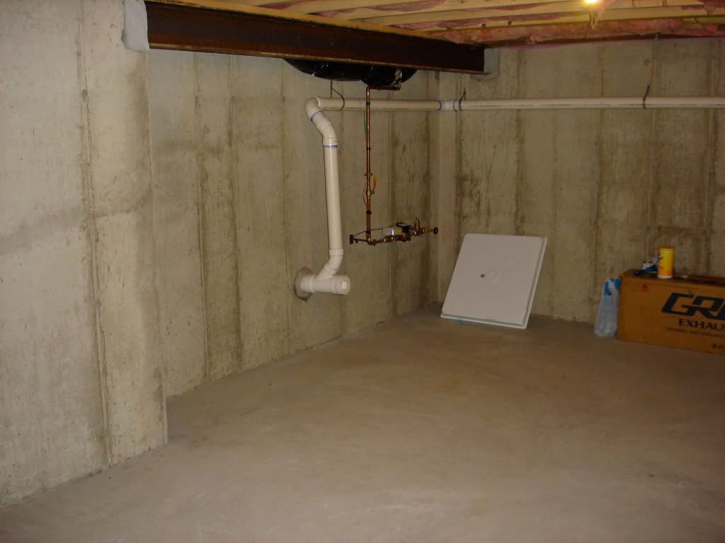

Here are some pictures I just took. I really don't know the best way to lay this out and figured I'd let you guys give me some suggestions.

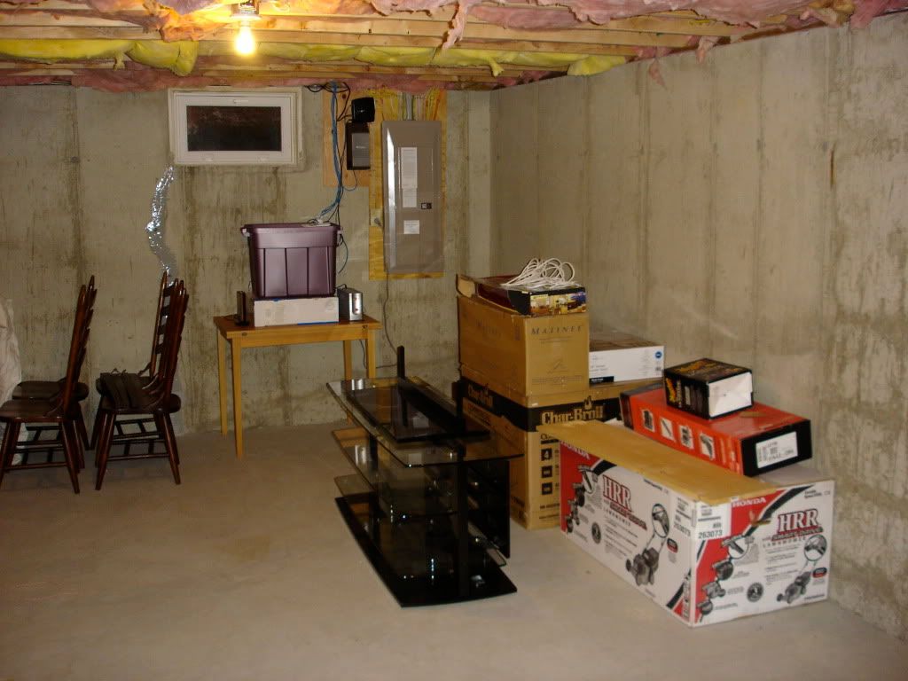

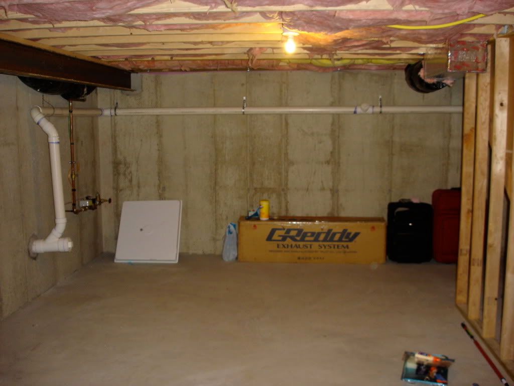

Looking at the area I want to use for the screen.

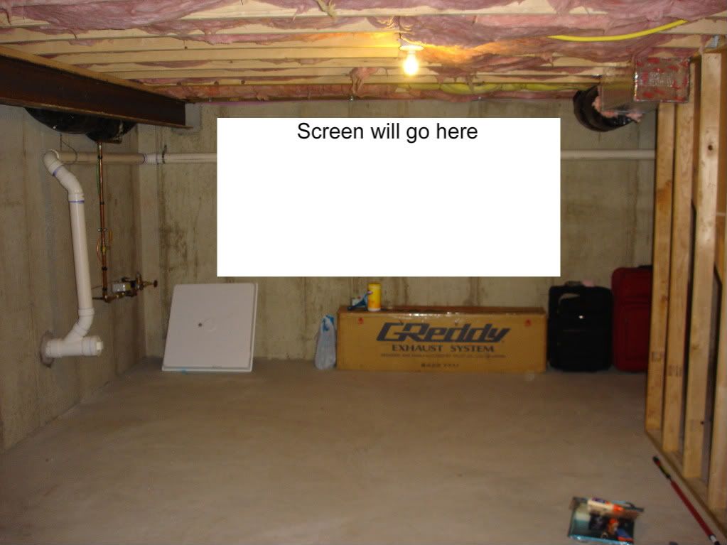

2nd picture with a text box where I want the screen.

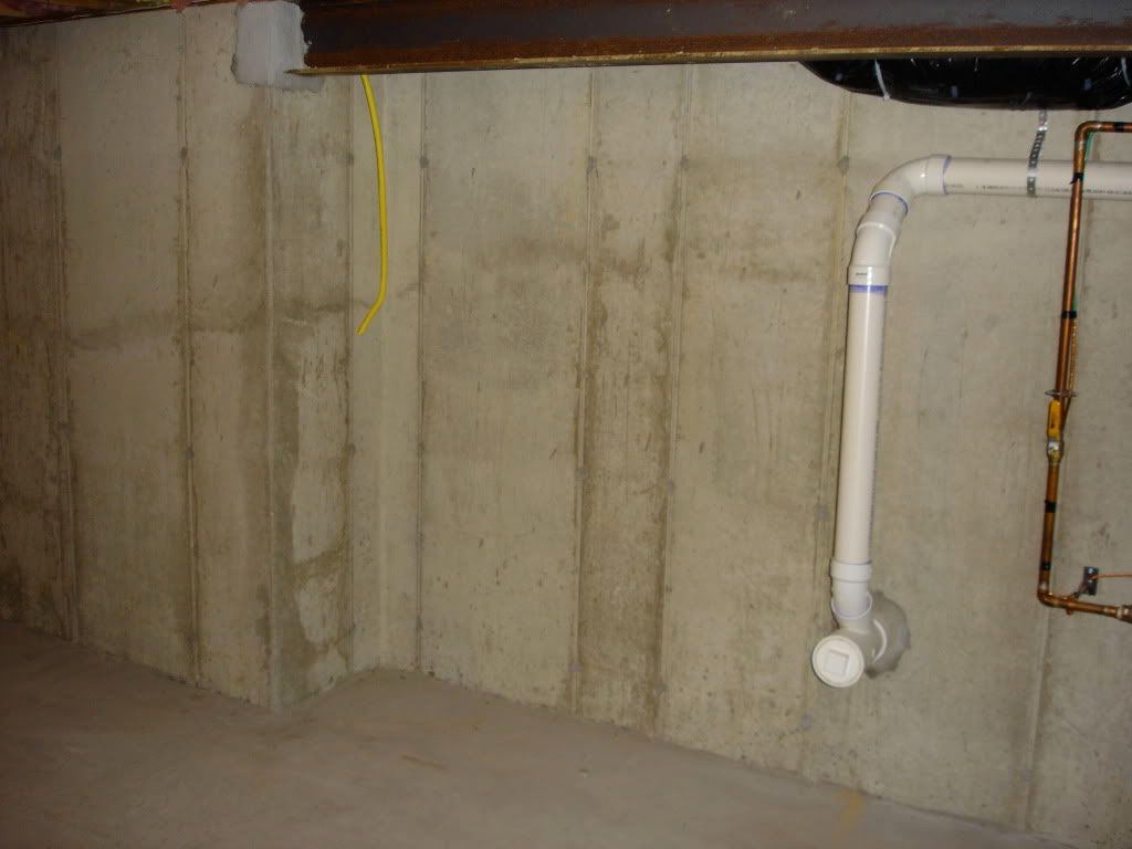

Left side of the front area. The wall pushes out 20" for the water main and drain. This 20" is not included in the 10'7" Width of the room. I will need to have access to this stuff though incase of plumbing issues. That needs to be worked into the design.
Another shot showing the foundation bumping out.

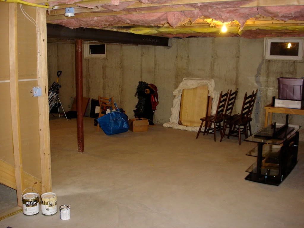

Back area of basement. The back 10' of this from the electrical box toward the camera could be a possible bar area.

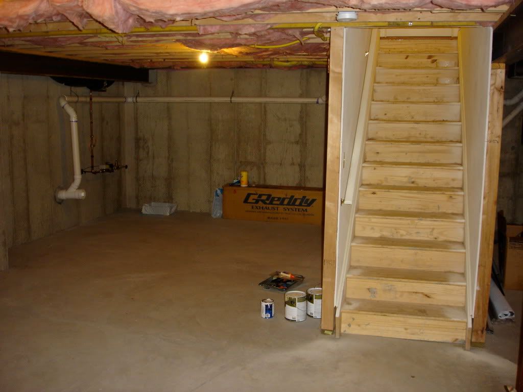

Same area, just a more left view. Showing the steps coming down.
A shot from the back of the basement toward the theater area on the left. The right wall of the theater will be up against the left side of the steps.
These are some shots to just show you guys what I have to work with. As far as materials, I'm not sure what I'm going to use for the ceiling. I'm throwing around the pros and cons of drywall and drop ceiling. I wish they were higher than the 7'2" I measure, but it's what I have to work with.

Could you rework the waste line? Ninety degree angle up, where it exits the wall. Then the cleanout, and continue straight up to a ninety to connect to the straight line. Then hide the works in a column. I'd also box all the waste line in the theater. Plywood box/GG/drywall/GG/drywall. The cleanout would get a cover with double steps and gaskets.
Or the bump out could be used for the av rack.
7'2" ceiling height is very workable. You have no soffits to deal with. Offset seating and low back seats can help with sightlines.

Tedd, thanks for the info. I can rework the waste line if I have too. I'd really like to avoid doing that as I'd have to hire a plumber since I dont' want to tackle that on my own. I definitly need to have access to the cleanout so either way I'll have to make access.
