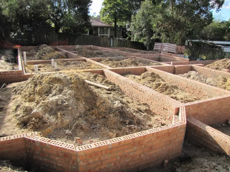

House build is finally underway. The theatre is above the double garage on the far right. It's a Dennis Erskine design with clear dimensions inside the acoustic shell of 9650 x 6350 x 3475mm (31'8" x 20'10" x 11'5").
Photo shows the foundations complete ready for forming up the ground floor slab.

We didn't do any bore holes before starting so the engineer's design was for concrete strip footings bearing on the soil about 600mm below ground level.
When they started digging it became obvious that just below this level, and covering the entire block, was weathered sandstone. So they dug a little deeper and then poured the concrete strip footings on rock.
This makes for an excellent foundation and hopefully I won't have any settlement issues. The only problem with the rock is digging under the driveway for the OSD tank is now going to be expensive !
