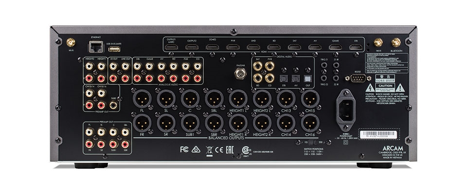

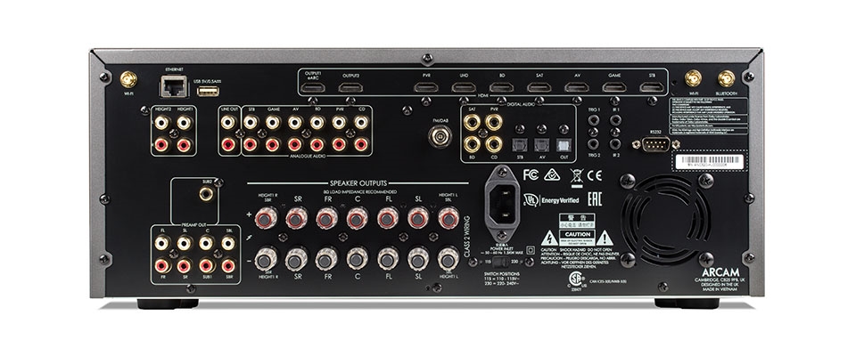

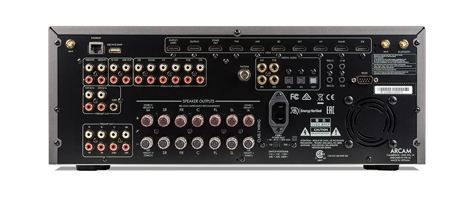

AVR10/20/30 & AV40 image front (all look the same except for the logo in bottom left corner):
AVR10 image back:
AVR20/30 image back:
AV40 Processor image back:

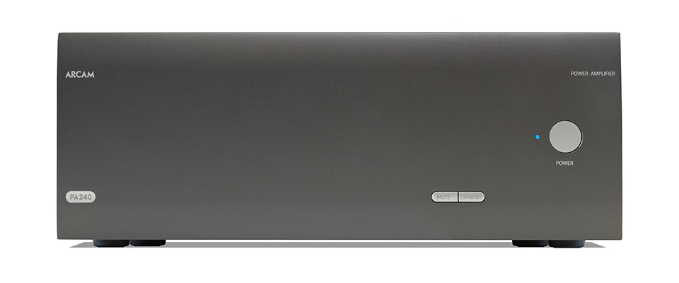

PA240/720 power amplifier image front (both look the same except for the logo in bottom left corner):
PA240 image back:
PA720 image back:
