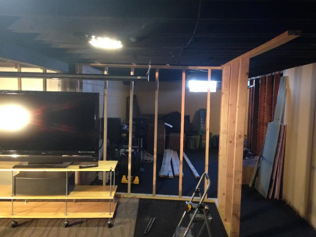

This picture is standing in the back of the room looking toward the front screen wall (wall not built)
Same shot with wall built
You can see the metal beam and the screen temporarily mounted...the LCD tv will be mounted to the "screen wall" and I'll drop the screen in front of it when using the projector. I just received my DVDO Quick6 HDMI switcher that has dual HDMI outputs that mirror each other. I did a dry run of everything today and I'll do another tomorrow just to make sure everything is working before the drywall goes up.

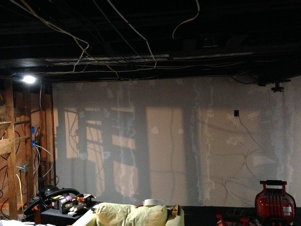

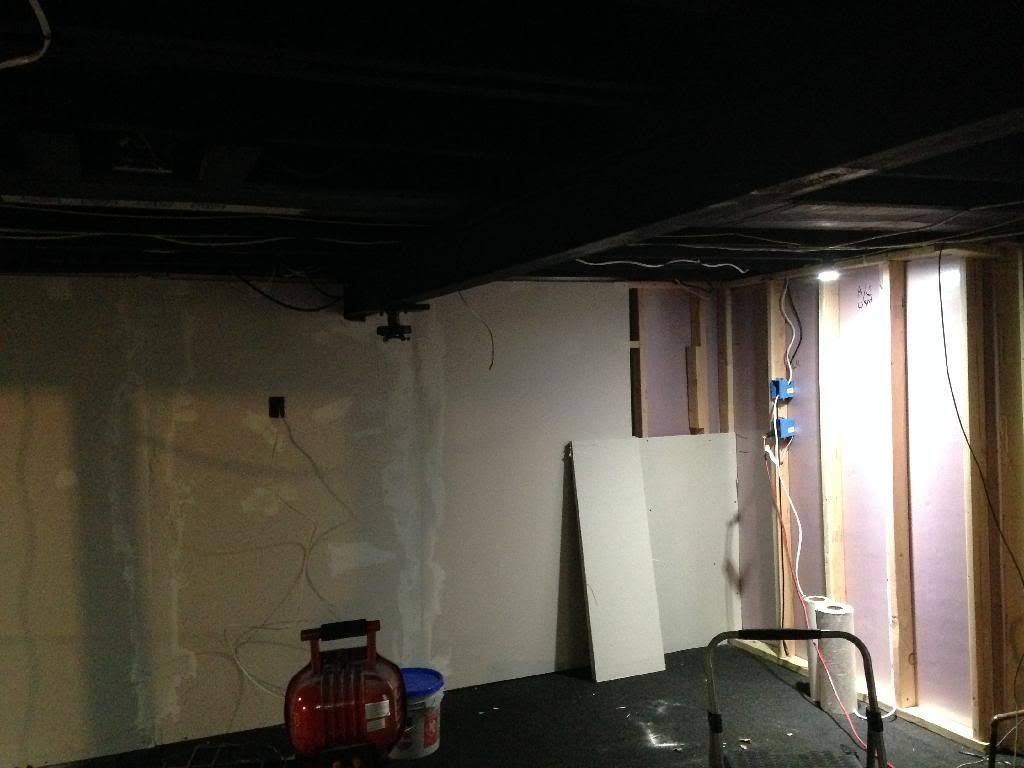

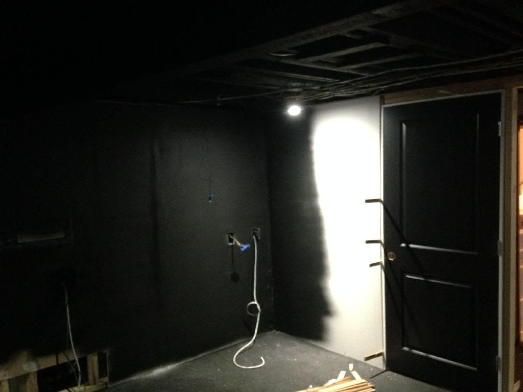

Just a few update pics...started drywall this week, the winter up in Detroit has been brutal this year, it's been ruff getting motivated. I've got a friend coming over tomorrow (Saturday) to help finish the drywall. I'm hoping to finish mud/sanding this week, then painting and tying in the electric.
[/URL
I'm using 1/2 plywood on the screen wall where my 65" LCD will be mounted

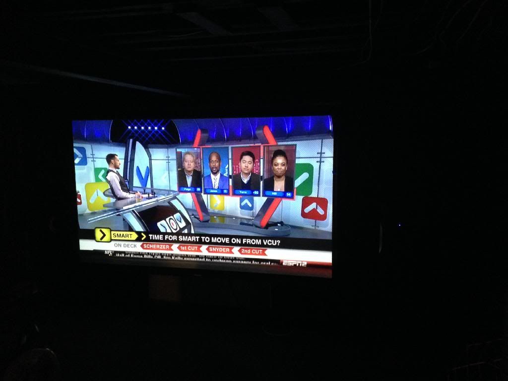

I've got a ton of work done, I finished all the electrical switches, mounted the projector and fired up the system for the first time since I put up the walls and painted. I didn't have my center or rear back speakers but it sounded pretty good. The picture from my Epson 5030 is just beyond my exceptions.
Door installed

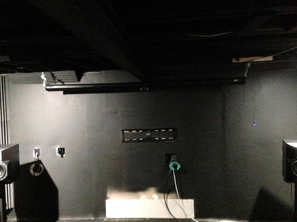

Front screen wall...screen mounted.

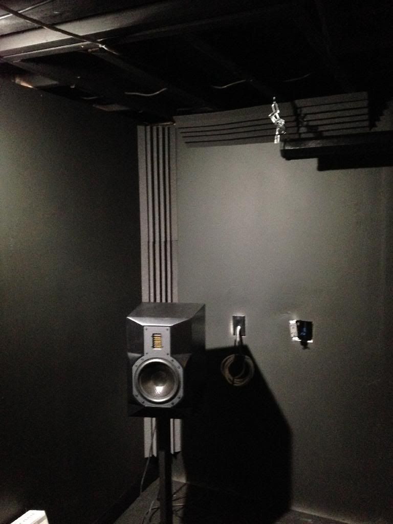

Left front Emotiva Stealth 8

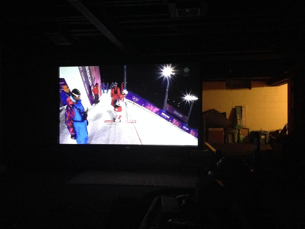

A little ESPN

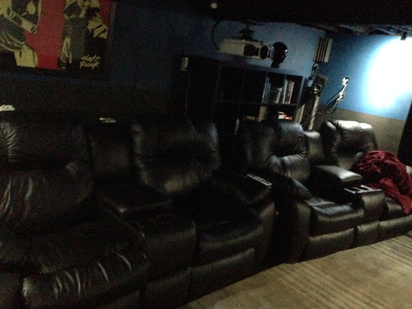

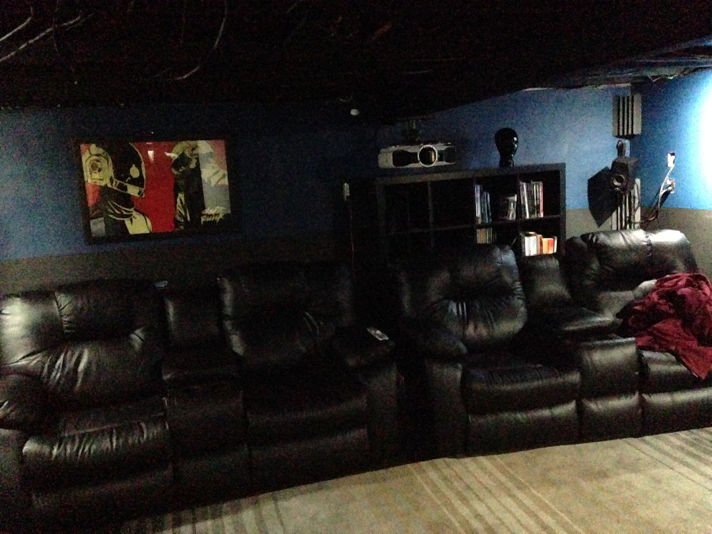

Getting close to finishing!! I had to wait to purchase my seating before closing up one of the walls....There was no way the love seats would fit in there if I hadn't. As it is, it's a bit tight but comfortable.
From the screen wall
I just have a couple more pieces of drywall to cut and hang, then it's mud and paint. Hoping to be done later this week.

You need some updated pics with the Triton Ones and the new screen!:)
