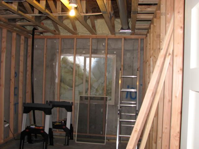

After months of perseveration about the pros and cons of building a home theater I have begun. I am a total amateur with little or no skills suited to construction. I have gained an enormous amount of insight from this site and I have already stolen many of your great ideas and plan to shamelessly continue. A major source of inspiration is rsprance's "Arthouse", not only because I have similar dimensions but because his application of frugality and style is a major motivator for me. There are many others out there that have given me much in the way of ideas if not just pure jealousy!

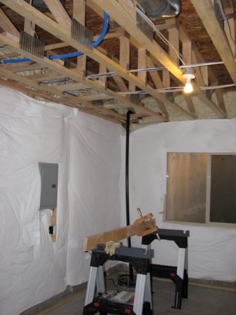

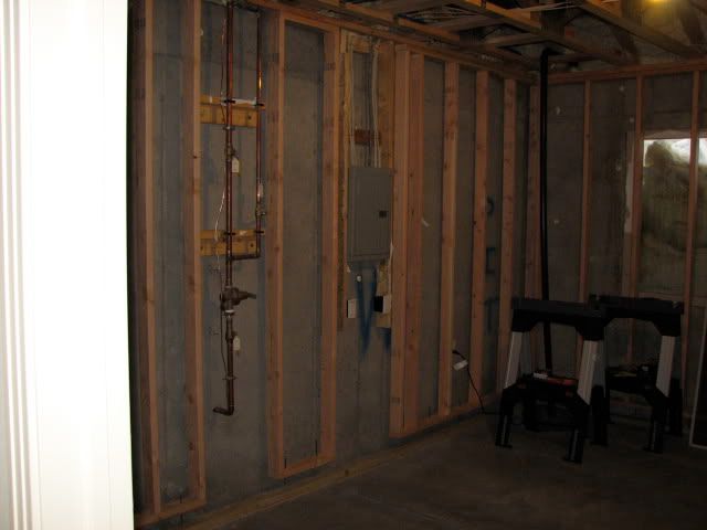

OK so here goes...wait, I already have a question. I am using a Mac and do not yet know how to upload photos in a format that the viewer does not have to open. Anyone familiar? Ok, so until then you will need to open my attached photos.
The photos show the screen wall (wall with window), the back wall, and a look into the ceiling. Should I keep the insulation that the contractor put on the walls? This is a basement and three of the insulated walls are poured concrete. The floor joists run parallel to the length of the room and as such I needed to "block" the joist to the concrete via what you see. This was very confounding to me but my contractor gave me this idea. I live in Colorado so the walls will need to be "floating". The room is small and I am not certain if I should build these in place or build then erect.

Anyone have an opinion on the insulation in the photos? Should I take out the bulk insulation and install insulation between the studs? I could then use the insulation that I have taken from the walls and put in between the joists.

OK so a fair amount of progress today. I decided to remove the contractor installed insulation on the concrete walls. I will use the recommended R13 on the walls and R19 in between the joists. I also managed to frame the room today (with the help of my buddy Sean G). Not bad for a days work. The floating walls that I was dreading were not terribly difficult.
So I have a few questions for anyone that wants to answer:
Currently I have 16'8" from the rear wall to the front this is not accounting for the whisper clips on one wall and the drywall that will be 2 sheets of rock mated with Green Glue...so the room will actually be 16'5" or so. I would like to hide my boxy speakers (see photo) behind a acoustically transparent screen. I presume I would need to build a false wall? The depth of the speakers is 12". Any suggestions on this. If I were to have a false wall I could acoustically treat the actual wall entirely. Do I have this correct? I also have those two subs that are considerably lager to contend with.
