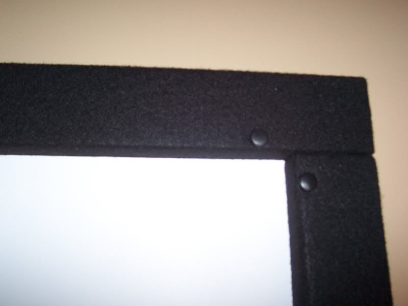

Here is mine (felt):
With camera flash:
See less See more

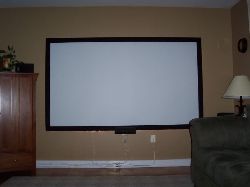

I went with a felt that I found at Walmart. It is fuzzy but you can't really tell unless you look close. No screen tests as I haven't obtained my projector yet. But here are some photos of the screen itself.
See less See more
