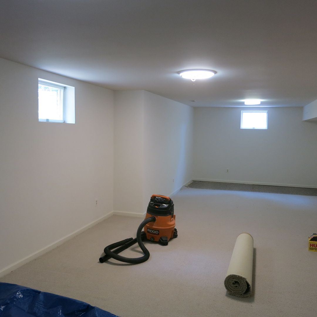

The bad news is that the room was already finished, The good news is that Onevoice2 had the desire to do it right. Clips, channel, DD and GG. All penetrations treated and beefy door, Flex duct connections for supplies and a dead vent powered return.
Before

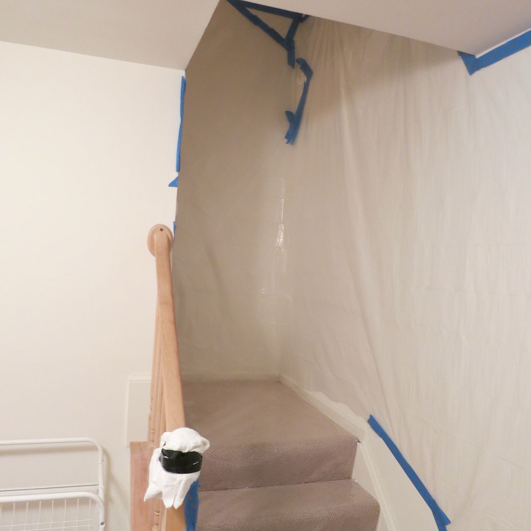

Can we actually get drywall down this stairway? We did a test sheet today and the answer is Just Barely

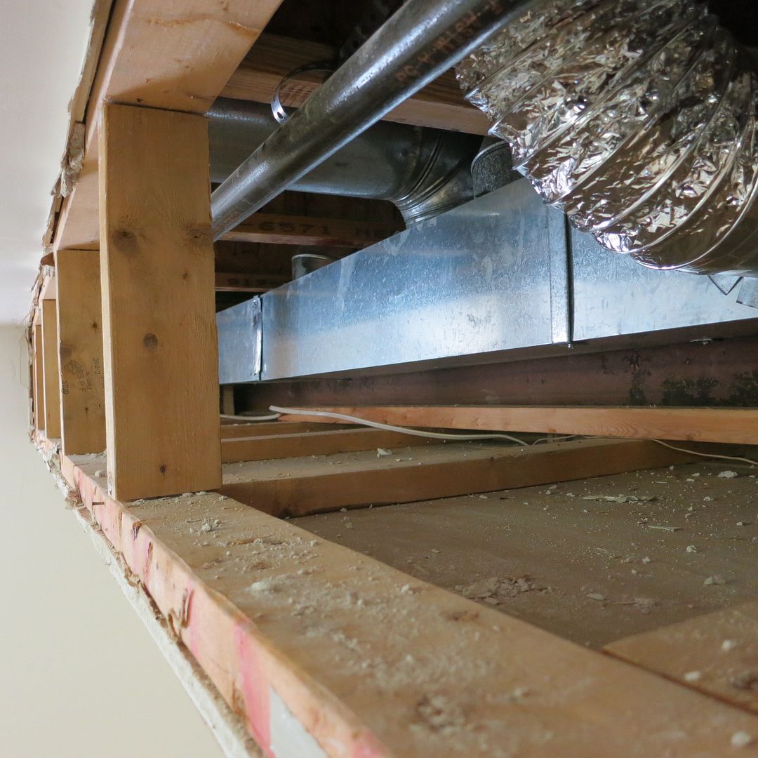

When I looked at that soffit my initial reaction was I can't believe they need something that big. I drilled a couple of holes and stuck in a scope and there looked like a lot of air.
When we got the side off the answer was pretty obvious. The soffit was much larger than it needed to be.
