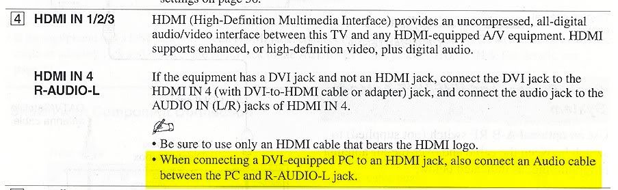

So here is a new problem that I have not solved yet.
On the Bravia 4100 LCD 40 there are 4 HDMI inputs.
I want to use the LCD as my PC desktop and with help from members here I have that looking good, the video part.
Well the Bravia's 4th HDMI input has separate audio inputs, designed per the manual specifically for those wanting to input pc audio when using DVI-HDMI from a PC.
Problem is, as soon as I plug in that DVI-HDMI cable, it cuts the audio. Meaning if I plug in audio cables in first, without the HDMI connected, I hear audio. Then when I plug in the video (HDMI) it cuts the audio.
1st I tired a DVI-HDMI adaptor end and it cut the audio, then I got a specific cable DVI-HDMI, it cuts the audio.
There is no setting or configuration I can find anywhere to fix this issue.
Does anyone here have any ideas or suggestions?

I'm not sure if you read the entire thread. I know what a DVI cable is, that was why I was asking how it would affect cutting off the audio when plugging in, when of course a DVI cable does not have audio. yet as soon as I plug in the HDMI end of the DVI-HDMI cable, the audio goes dead. Is it the TV cutting the audio? or the Nvidia 9800 GTX? Im guessing its the Bravia LCD, because if I plug that audio into something else I can hear it.
With the configuration I need for this application, using some other audio input is impossible, as the video needs to come from the source via a DVI-HDMI, and the only HDMI input with additional audio inputs was input 4. (See picture in first post)
