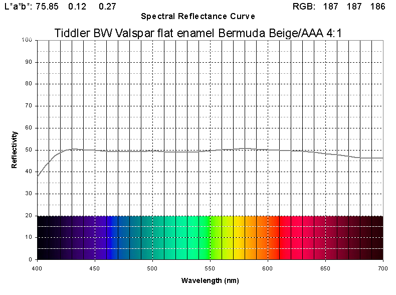

As demonstrated in the spectral plots above, it can also be mixed with a Bermuda Beige tinted base paint to produce a neutral gray.

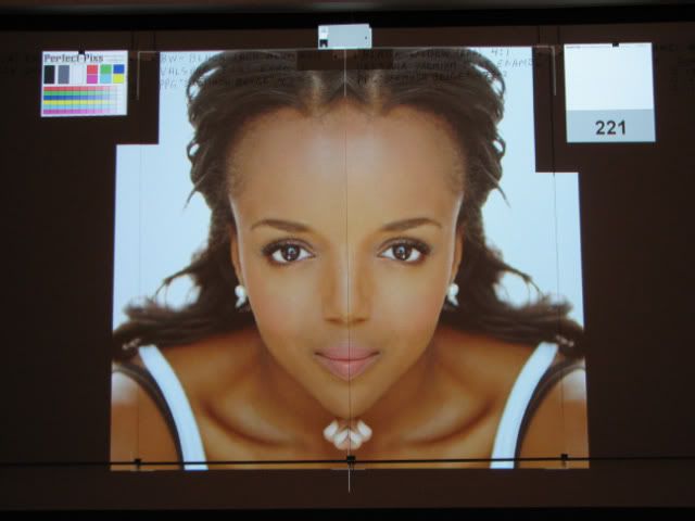

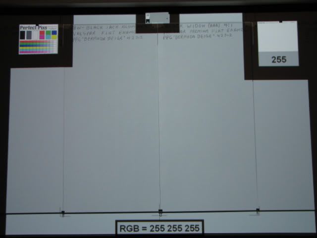

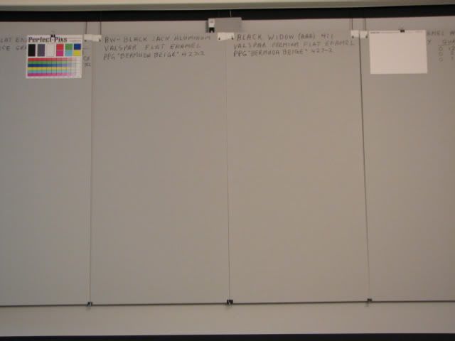

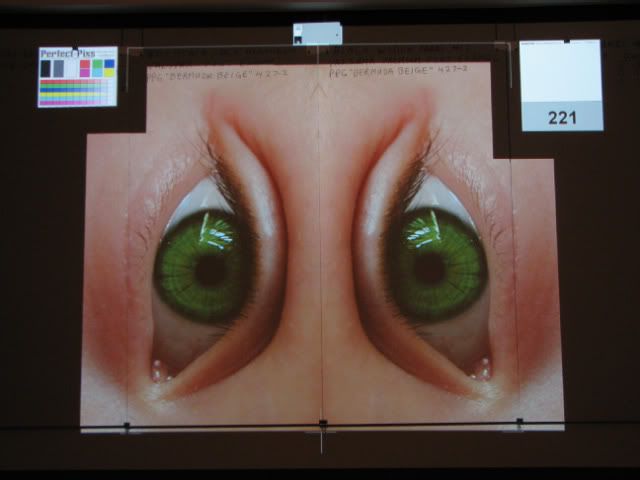

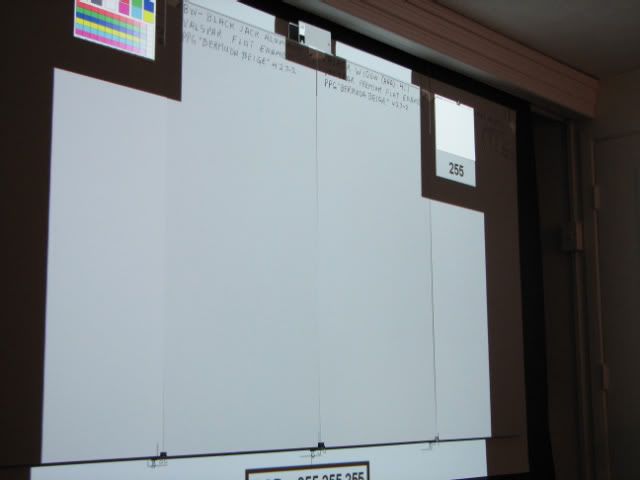

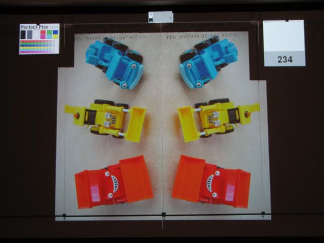

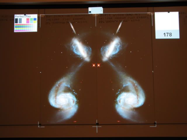

Here are my comparison photographs of BW-BJA on the left and BW-AAA on the right:
All room lights on full
Camera Flash
Projected White Light
Projected White Light Off Axis (~45deg)
Click images to view full size.
Note that the BJA does not add as much gloss so the image is not quite as bright. Mind you the difference is not that big, as you can see from the above photographs.
Both aluminum paints are quite thin and help the paint to level out in the same way that a polyurethane does.
The biggest difference is that the Black Jack Aluminum is believed to be a leafing type of flake while the Auto-Air Aluminum Base Fine is believed not to be. Leafing flakes lay flat and more parallel to the surface. Thiat means that the BW-BJA should not just be back-rolled, it must be down-rolled to align all the flakes.
