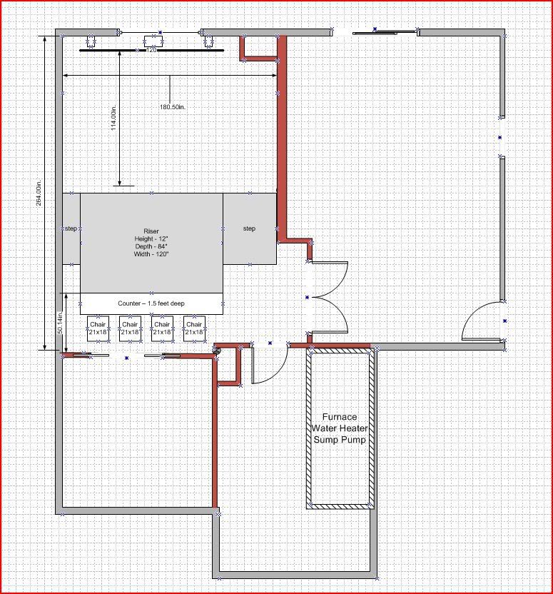

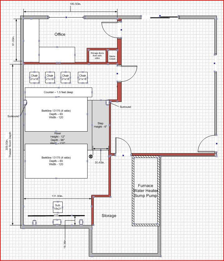

So this is my first post. I got the approval from my wife to start on a home theater but now I need to decide on a layout. I'm hoping to start building in the next few months. I will also be finish the rest of my basement while I'm at it. I'm split between two floor plan options. I've attached my options.
I like version 5 more but there are a few things that worry me.
  1. The space between the column by the front row and the wall is only about 30 inches.
  2. I would like two rows of 4, but the space between the outside wall and column is 126 inches. From what I've seen, 4 Berkline 13175's are 120 inches wide. That would put the seats right by the wall.
  3. Will the view be acceptable being surrounded by that deep of walls.
  4. I can't afford an pre-made AT screen so I want to go the DIY route. I'm thinking about Dazian Coated Celtic Cloth but hope it won't affect the sound too much.
  5. I was hoping for double doors but I don't think I can fit them in because there will be a post inside the wall.
Here are the positives with version 5
  1. Deeper room
  2. Won't have to wall in/deal with the window in the theater room
  3. Seating rows are farther from the screen
Here are some other notes
  1. I'm thinking about Paradigm speakers in a 5.1 setup. Titan Monitor for L/R. CC-290 for C. ADP-190 for surround. Unsure of the sub, but won't be Paradigm.
  2. I will have a drop ceiling about 12" from joist, leaving me with 8' ceilings.
  3. Thinking about a Denon AVR-1910
  4. Will try to do a DIY rack
  5. Need opinions on projector. My two options are the Panasonic AE3000 and the Epson 6500UB. I like the AE3000 for the zoom memory feature and the Epson for the long lamp life and brightness. I'm thinking about going with the Epson because from what I hear, the AT screen needs a brighter image and the lamp life looks promising as well. Any opinions?
Thanks for any input. From what I've read already, there will be lots of good input.
Version 5:
Version 6:
Floor Planv5.pdf 53.064453125k . file
Floor Planv6.pdf 50.3525390625k . file

From your list, you seem to have a great understanding and feel for the issues that you will experience. The width of the seating is a concern, but you know, it's entirely a personal decision. You can push the seating up next to the wall, BUT you will not have the best sound experience from that location. Is that significant to you? Personal choice.
30 inches from the column to the wall is not bad. I've seen smaller. It should work fine. Losing the double doors is actually preferred from a sound containment perspective.
  1. Deeper room
Deeper may pose a sight line or tunnel problem, but you should be ably to mock that up and see if it will be an issue for you. All of the positives will work out OK.

What is that bump out used for? Is it hiding something? It may cause you an issue with symmetry in the room. The screen wall will not be symmetrical, but I don't know if it will bother you. It would drive me bananas, but I'm a bit weird that way.

The bump out does bother me, but there's no way I could get 4 seats/row and keep it symmetrical with the post right by the first row. I could go 3 seats/row, take out the bump and move the screen over, but I'm not sure if it's more important to me that the extra seats. I could take it out, but again, the wife wants all the storage room she can get. I'll try talking her out of it.

One of the pics show the depth of the riser as 96". 84" is more than enough which is what I have. Some use much less but 78" is a common number as well. The deeper the riser, the more distance between rows and the more difficult time you will have keeping both rows happy with screen size.
I would also square off the room as symetry is king (in my book).

If I did square off the front of the room, would you guys keep the screen where it is, centered with the seats, or would you move it to where it's centered on the wall, where the seats next to the wall will have a worse viewing angle?

Yes, the distance from the wall helps create an accurate surround sound stage. Chairs bumped up against the wall will degrade this, but all HT building involved tradeoffs. Only YOU can weight whether the cost is worth the benefit.

I would like the screen centered on the wall. I had less variables I could change so I ended up going with 2 chairs in the front row (instead of 3) and 4 in the second row. The front two are centered on the screen as are the two behind them and they are definately the prime seats while the other two are definately overflow (as would have been the 3rd seat in the front row had I added it). I won't be sitting in any of them...
My screen wall is 154" wide and I will have 115" of screen width (125" 2.35 screen). Link in my signature.
