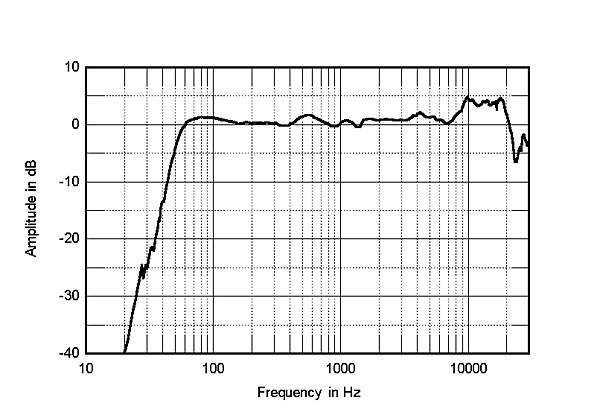

That "S" sound you hear is called sibilance and yes it's exceptionally annoying. Some of us have some crazy high resolving systems (whether built or bought) and they can quickly point out bad recordings or poor streaming compression (a very common culprit in sibilance).

Those Klipsch units can definitely be irritatingly bright. Do you have any other speakers you can run and make a comparison? It really just may be that the horns are too aggressive for your listening taste.
