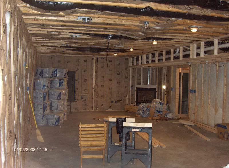

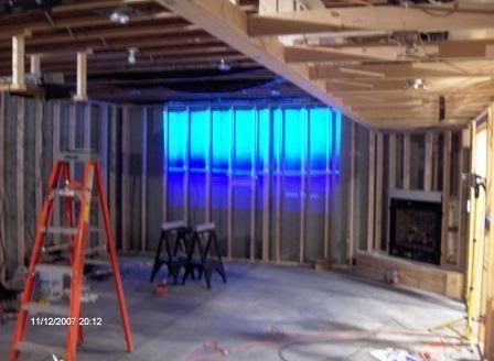

Does a textured ceiling make a difference? I have a combination bar/HT room that is 42 long x 19 wide with 9 foot ceilings. I want to do as dark as I can on the ceiling and screen wall (WAF). I am leaning towards a textured ceiling, what my drywall guy calls a knock down. Basically it's a big fat nap roller that leaves mud hanging down then they go right back over it and knock it down. If I use a flat paint on this texture is it going to make a difference while 1) watching a movie? 2) hanging out at the bar enjoying a cold beverage? This is my first shot at anything like this and need some opinions.
Scott
Here's a couple of photo's of the room looking towards the screen wall.
