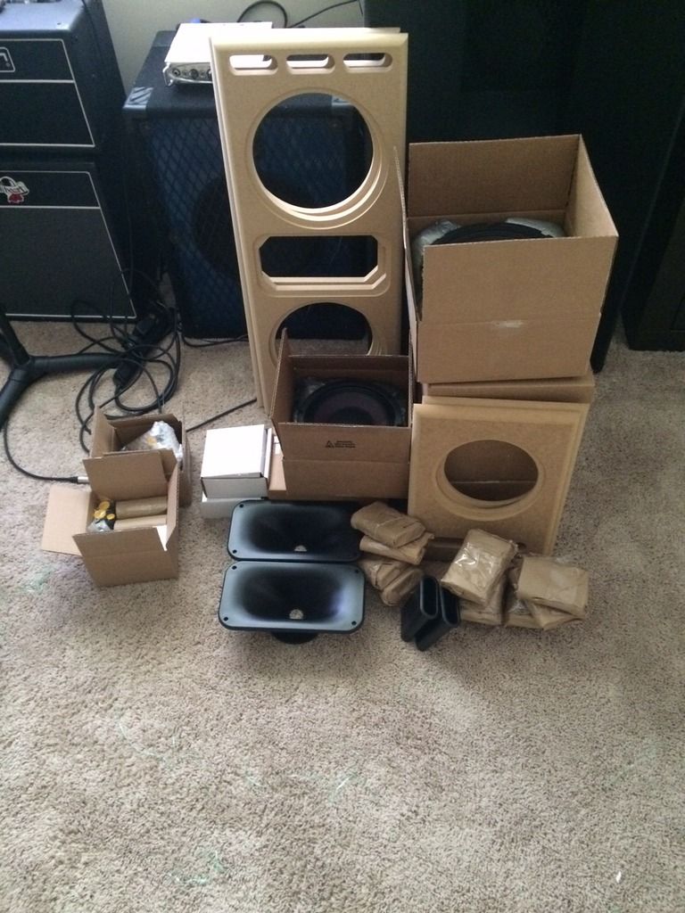

Pile of parts:
1 of the crossovers for the Max:

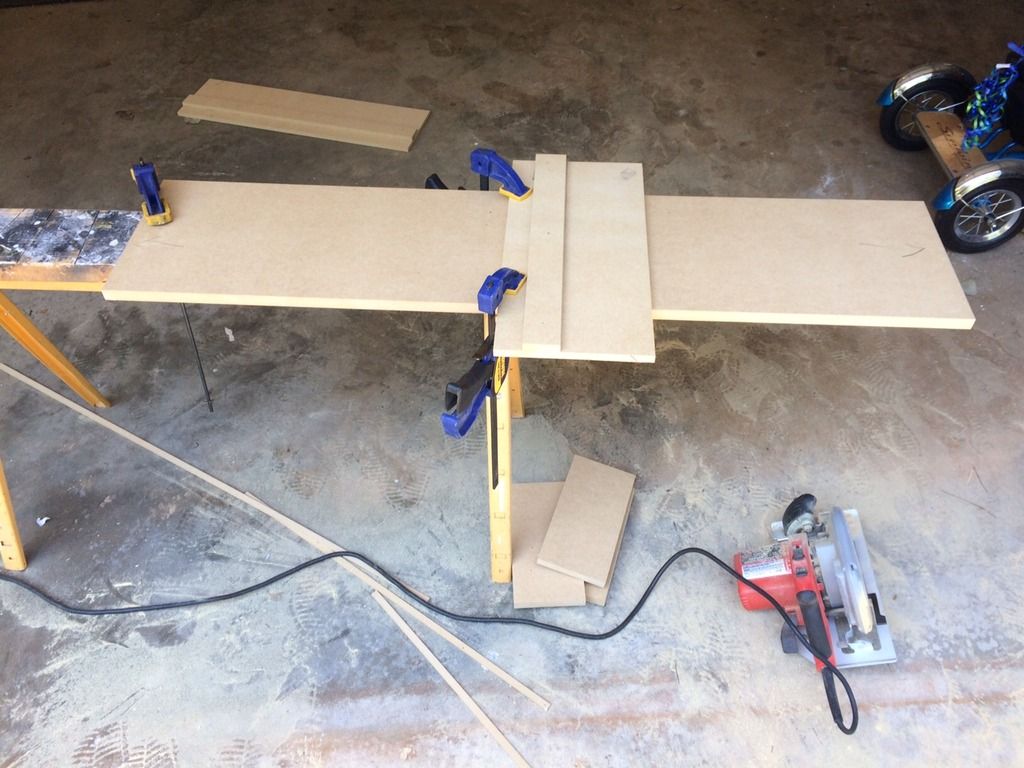

I had Home Depot rip all the panels 1/2" over width and then trimmed them on the table saw at my dad's house. All the exact cuts are 11" wide. Everything else will be trimmed flush with a router.
Saw guide setup:

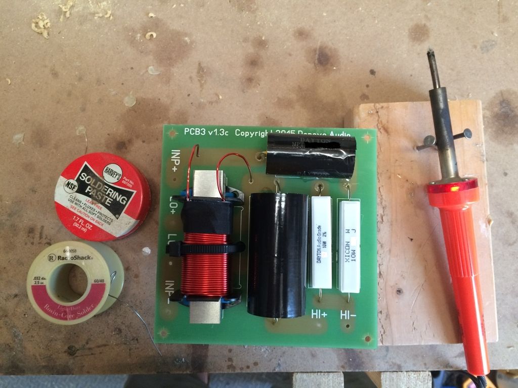

As stated above, correct solder doesn't need flux paste....IMHO, and I've built at least a few projects in my day(mostly mic/rf amplifiers).

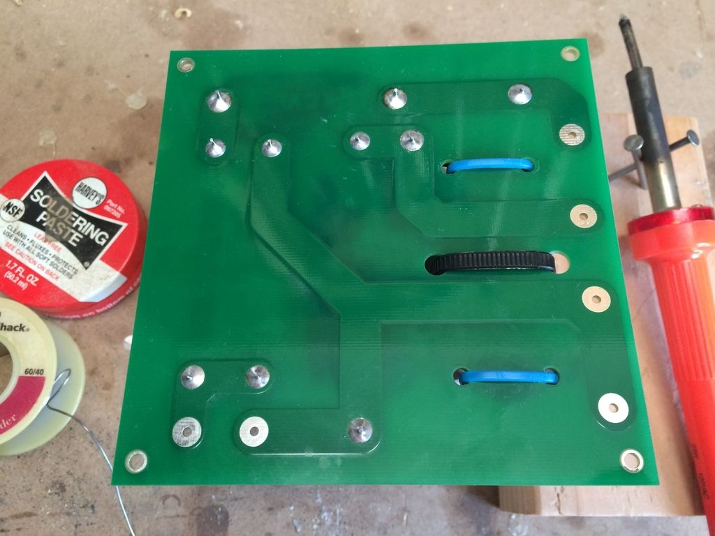

You shouldn't need soldering paste. The solder is flux core.
Tim
I just find a little dab of flux makes it flow better. I'm no expert on soldering though.

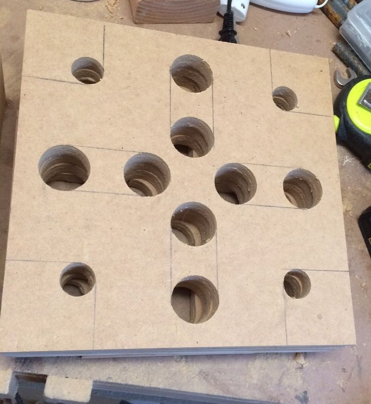

Then on to bracing. So I decided I could remove a little more cancer dust from these without losing any strength:
I'm sure it'll work either way with the pads being so far apart. Just a little extra work. What I do is touch the iron to the pad, then bridge the iron to the pad with a touch of solder. Then touch the solder on the opposite side of the pad.
Heat (or lack thereof) is probably what makes it seem like the paste makes it work better. But hey. whatever works. Everything is looking great!
