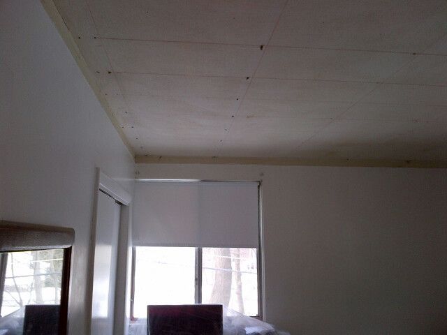

Ok, finished taking the ceiling down today. Here's what the joist's look like. Is it ok to remove the furring, or are they some kind of support and or fire break?
And if they are being used as support, could I remove just the ones (or part of the ones) that are in the way of my RSIC-1's?

back to your question can you remove them?
Not sure why they are there, not a fire break, really don't add anything structurally other then possible stiffening the floor to minimize floor bounce for the tenants benefit above.
From the online reference tables I looked at, 2x8 floor joists spaced 12 inches on center are sufficient to handle the load for a 12 ft span assuming they are well supported on both ends so the furring isn't needed for that purpose. It may have been added to make it easier to hang the drywall. Allowable spans for the 2x8s would be around 14-15 ft depending on species and grade of lumber used.
Ok, great. I'll proceed as planned then and remove the furring. Thanks, Jeff.

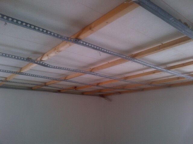

I finished installing the Roxul and some of the clips. Now, I have a dumb question. Should I use standard 24" oc spacing for the channels and cut to fit the middle sections (two 6' sections)? Or space the channels to use 8' sheets on each pass. going 8 and 4.5 then 4.5 and 8?
See less See more
2
The second one probably makes more sense.
