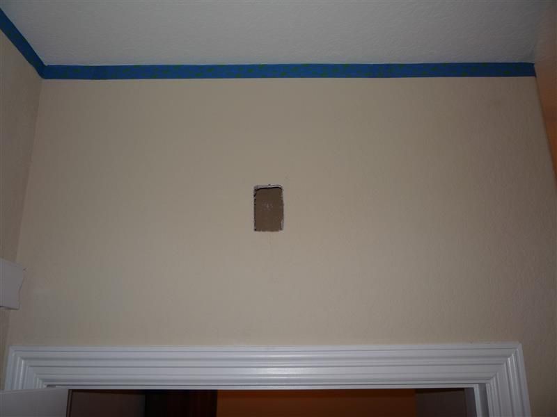

As there's only one entrance/exit the room, the logical place for it is right above the door (see red circle).
Problem is that I thought of the sign after the house was built; there was no power run to that location. How to get power there? Darn good question. In fact, one that I spent a couple of days trying to answer. What I did not want to do was have to break sheetrock, run the wire and repaint. Trying to go from the nearest outlet to that location would've required 4 or 5 separate holes in various walls to run the wire from an outlet to the sign location. No way, man. I suck at sheetrock work and don't like doing it. The only other choice was to go UP THERE...in the crawlspace under the roof and run the wire. I was not looking forward to that.
So first I had to drill a hole for the wire to come through the wall. Did that and realized "How am I going to reach through this little hole and drag the wire through?" What a dummy. So I cut a proper hole for an "Existing work outlet box."
Don't have a shot of the box installed, sorry. I reached up into the hole thinking the crawlspace was open above it...thought I was home free. Nope. There's a board up there. So now we have to drill a hole through the board in order to fish the wire through and down. Would never find the right location up in the crawlspace to drill DOWN from, so we have to drill UP. But how? Can't fit the drill through that 3x5 hole...so how to do it? Right angle attachment to the rescue!
Well, that didn't work too well. The angle of the bit was too acute and I wound up not going straight up, but diagonally OUT...right into the stairwell. See the red circles? Looks like I'll be doing a little spackling. Oh well. I solved the problem by removing the right-angle attachment and adding a 12" extension to the long spade bit. I was able to drill relatively straight up and into the attic.
So, back to getting power. It just so happens that there's a convenience outlet in the mechanical room. This picture was taken from in the mechanical room, looking out into the HT. Note the red, circled outlet on the left and the red circled location for where the exit sign would go.
I didn't take any pics while dragging the wire through the crawlspace, but I am proud to say I did not put my foot through the ceiling. I did however, inhale about 16 ounces of blown insulation. That stuff SUCKS. I have 10" of insulation in the crawlspace. Trying to find studs to step on required kicking the insulation out of the way while I hung onto the rafter for dear life. CLOUDS of that crap blew up in the air and right into my nose. I should've worn a mask but it took two minutes just to crawl up in the space to begin with...too late, oh well. I dragged the wire through the attic, stuck it down into the hole and done. But not before cutting my skull twice on roof tile nails sticking through the roof. It's not your project until you bleed on it!
Here's the 14ga Romex running into the outlet box.
I tacked it down with proper Romex staples and that was that. See red oval.
I'll have to take the sign down to paint, but I just had to see what it looked like. :eek: It's not only a red exit sign, but it has LED emergency lights too, powered off an internal battery.

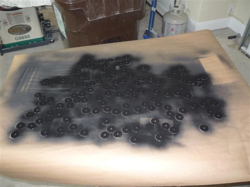

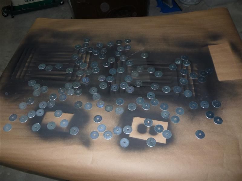

The sign is actually a little too bright, so I'll be adding some window tint film to the inside to darken it up a little. Finally, I did a little bit of work getting ready to put the Linacoustic up and paint the ceiling. I'll be putting the Linacoustic up with drywall screws and fender washers. Can't have shiny washers reflecting through my screen wall, so:
Shiny washers.
And not shiny any more washers.

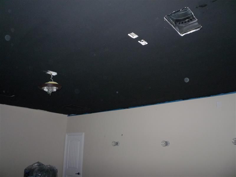

Painting time!

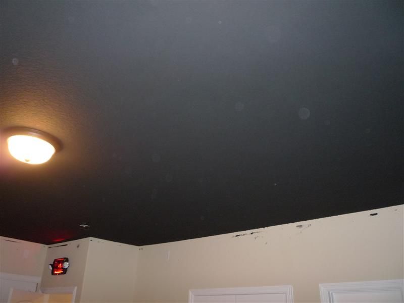

I started the painting or more accurately, the re-painting today. This room was a finished room...with a white ceiling (OMG!) and yellow walls like the rest of the house. 100% totally WRONG for a theater room of any kind.
I painted the ceiling today. What was special about it (to me anyway) was that I used a paint not often mentioned here. I used Roscoe Velour Black/6003. This stuff is expensive as in $80/gallon expensive. I got a headache just buying it, so I had high expectations of it, based on what I've read online.
Keep in mind that pics often don't represent real life. I took the pics in this thread about an hour after I finished painting. It's now about 5 hours later and it actually looks better than the pics suggest.
So here we go. I'll give my honest thoughts on this paint.
It's biggest selling point is that it's "an artist pigment black" as in, inky, deep black. That I can absolutely attest to. This stuff when dry, is like...flat velvet in appearance. Black, bottomless and not shiny at all. I do not see any chalky spots. Unfortunately, I have textured walls and ceilings in the house. I think if my ceiling was a flat surface it would look even better...and would've taken less paint to cover it. Keep reading.
The second biggest selling point is that it's super-concentrated and must be diluted with water. How much water is up to you. This stuff is like cold molasses syrup right out of the can. I literally had to scoop the paint out of the can to mix it at room temperature. Roscoe suggests a 1:1 mix but I read a few different threads on both HT and Stage forums that 1:1 results in a runny mess. I can attest to this as I tried it with my first batch. 8oz paint and 8oz water. I got soup. Black as hell soup but not usable, especially trying to put the stuff on the ceiling! Barely would stay on the roller. I found a 3:1 mix was the best ratio at least for ceiling applications. You have to mix really well. I mean stir until your arm seized up. It does not mix readily with water, but DOES mix nicely...eventually.
I also found out that a textured ceiling sucks up paint almost as bad as bare sheetrock or MDF. I'd soak the 9" roller and wind up with about a 4 foot long strip before the roller got dry. My 374sf (17x22) ceiling went through about 95% of the gallon of paint even in diluted form with just one coat.
As you can see in the pics, there are a lot of "pinpoint" holes in the paint and you can see the white paint underneath. Obviously, white shows through dark colors easily and draws your eye to it. If not for these spots, I would not retouch it at all. I am fairly sure that that I can dilute the 3/4" of paint I have left in the can a little more and take care of all the white spots. I originally planned on Mouse Ears for the ceiling and have a gallon of it already...which now I have no idea what to do with it. I COULD put a second coat on the ceiling, albeit with the Mouse Ears, but what if it's chalky or shiny? I seriously don't think you can get a better black ceiling than this unless you can do two full coats of Roscoe, which I'm not inclined to do. Cost, time, etc. We will see how it looks after touchup tomorrow. If I can cover the pinholes, the ceiling is done.
Here's some pics. Don't worry about all the missed spots near the front wall. I will be extending the Linacoustic up on ceiling at least 24"into the room. My screen wall will be 36" deep, so why not use the Linacoustic I already have? (100 feet of it). Keep in mind the paint has dried a lot since the pics and actually looks better. Sorry for the dust particles...I didn't see'em when shooting pics.
BTW: the tops of the walls are taped off with blue tape. If it looks like I have paint on the walls near the top of the walls, I don't. The paint is on the tape. There ARE a few drips on the walls though. This stuff does NOT wipe off at all. You drip on something, that thing now has black spots forever. Luckily I'm painting the walls and replacing the carpet. :eek:
And finally, a pic of something my wife got me for Christmas. It will go above the entry door to the theater. :D

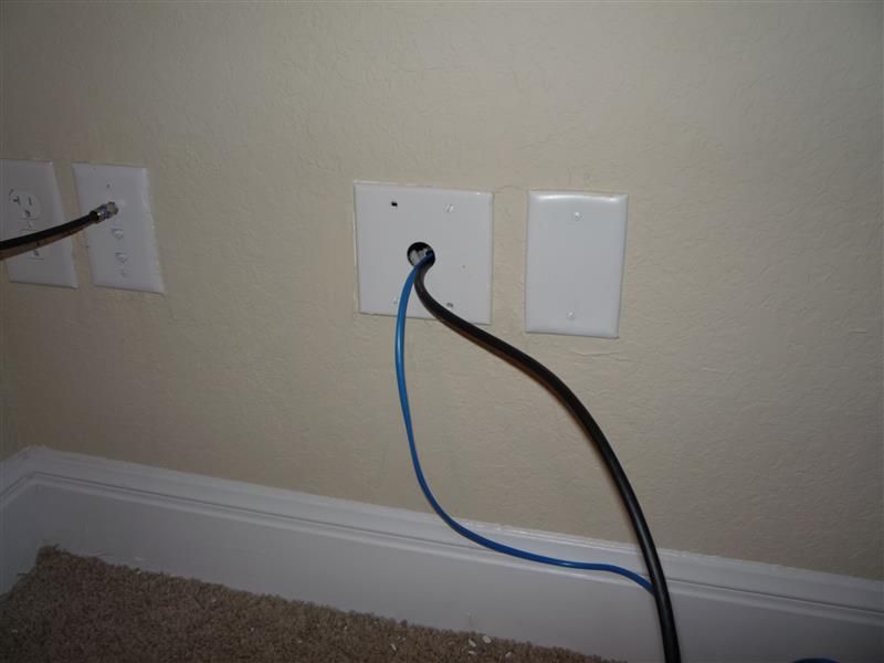

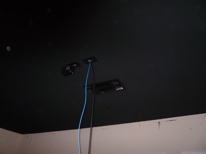

Ran the HDMI cable and a CAT5e cable through the conduit. You can see the spaghetti of speaker wires back there too.
Black AC vent.
Light back up.

I'll be posting a few new pics later tonight. I had my first "oops"...drilled through the stairwell wall while trying to drill a hole up into the attic to run a 110v line for the EXIT sign. /facepalm

That is way too many fender washers for the scene wall, I can't imagine using more than 50%.
You really think so? I'm putting up 153 square feet of 1.5" Linacoustic. I'm not using any adhesive; just the drywall screws and washers. Is there a general rule of "attachment points" for putting up Linacoustic? Thank you for your input; I want to do this correctly the first time.
· Registered
Joined
1,185 Posts
Discussion Starter · #15 ·
LOL! Then I guess all of the 120 I spray painted already won't get used. Oh well...I never throw hardware away. I even keep the extra screws and oddball hardware that comes with DIY furniture, TV stands, etc. Which would explain why I have 3 parts organizers with the little drawers overflowing with stuff I haven't touched in 15 years. But hey, I WILL need it all someday!

Now that I have some daylight coming through the windows, I was able to take a critical look at the ceiling. It needs another coat of paint. There's just too many thin spots where I can see white peeking through. You cannot see this with the lights off but it's pretty obvious with the lights on. It's something that someone like me would spot in your theater if I was there, and that bugs the daylights out of me.
So now I have a choice. I either use the gallon of Mouse Ears that I already have, or spend another $100 on another can of Roscoe. I am leaning towards the former. I already spent the money on it and if the ceiling comes out chalky or I don't like it, then I'll just paint over it. All I lose is a few hours of my time.
Did I mention trying to paint a white, textured ceiling is a PITA?

Are you using a split foam roller on the ceiling?
I'd add another coat or two, to the ceiling, as the projector will also highlight any light spots on the ceiling.
As for your dedicated (performance hard core) room comment, have you considered making some sort of window
plugs, or panels to negate the windows? Curtained, they might leak light, while they also over-absorb high frequencies.
And, they will raise the noise floor of the room, while also introducing audible issues while they act as low pass filters.
The mouse ears could be used to paint out the front AT wall framing and acoustical panel frames. It needn't go to waste,
if you buy another can of Roscoe.
