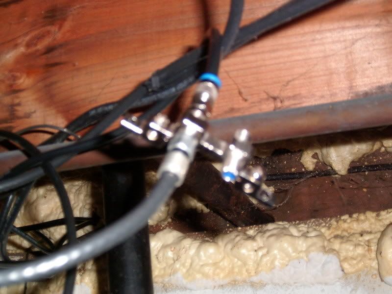

OK let me start off by saying that about a couple weeks ago I had a thunderstorm roll over my house and the receiver lost the signal. I called customer support and they told me to reconnect all the wires. What fixed the problem then was reconnecting the wires to the little silver splitter thing in the basement (I connected the wires to the other connections on the silver device). So today I had another thunderstorm roll over. I went down in the basement and did the same thing as before (I connected the wires back to the old connections. There are only to inputs and two outputs on this silver device I am talking about). The result of this is my receiver still cannot get a signal. I reconnected all of the other connections from my receiver to the satellite and nothing has worked. Now to add to this confusion, this is the signal for my HD receiver. I have three other SD receivers receiving SD signals in the house and they all work just fine. What could be the problem here. I don't think its my receiver.

Can you get the markings off this silver device you are referring to so we can determine what it is also?
There are no markings. There is a picture of it.

That's just a ground block (which isn't even grounded), should have no impact on loss of signal. I'd have to go with alignment issue, bad output on the dish, etc.
