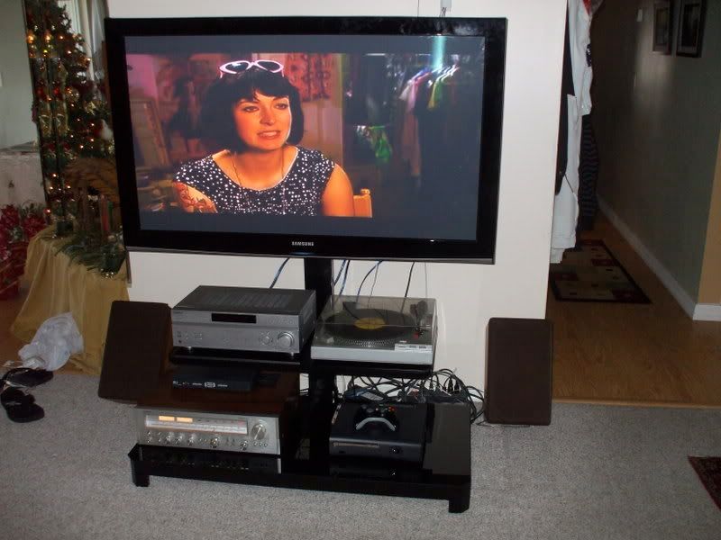

So, I've been in to car audio for 3 years now, but am now discovering the realm of home theater. I just bought a Samsung PN50A450 for $900 and cannot stand listening to the $99 Sony HTIB that we got from Walmart a few years ago.
I just built a box/table for my 15" Treo SSi, 5.5 cubes tuned to 17 hz with a 250 watt plate amp.
Now, on to the receiver and the rest of my 5.1 setup. I'd like to stay under $500 for both if possible. I was looking at Fluance for the towers/center/surrounds and possibly Sherwood or Onkyo for receiver.
http://www.fluance.com/fluanceavhtb.html
http://www.amazon.com/Sherwood-RD-61...1914532&sr=1-2
What would you do with a $500 budget? I can build towers and wire stuff up, or I can buy a package of stuff, whatever would be most bang for my buck.
