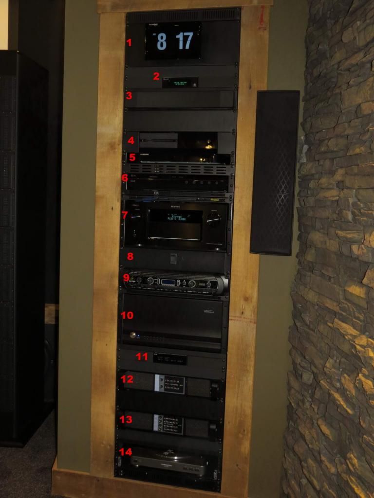

- Wanted my equipment visible. I have a bit of OCD and enjoy the occasional glance over to see the status of the equipment. I especially like the feature of the Denon’s where you can display the number of channels the AVR see’s coming IN and also the number of channels it is processing going OUT. Due to having a small room-within-a-room design (for the rack), I reciprocated that design feature on the opposite side for symmetry.

1) Media Server display
2) HTPC display/IR
3) HTPC fanless case front
4) Xbox One
5) Bluray Player
6) HDDVD/Bluray Player
7) Denon AVR-4520ci
8) drawer
9) Behringer iNuke NU1000DSP
10) Sherbourn PA 7-350
11) Fan & Temp control for amps below
12) Sanway FP-14000
13) Sanway FP-10000Q
14) Turntable on extendable tray
