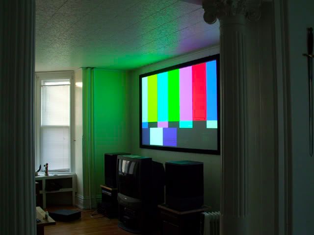

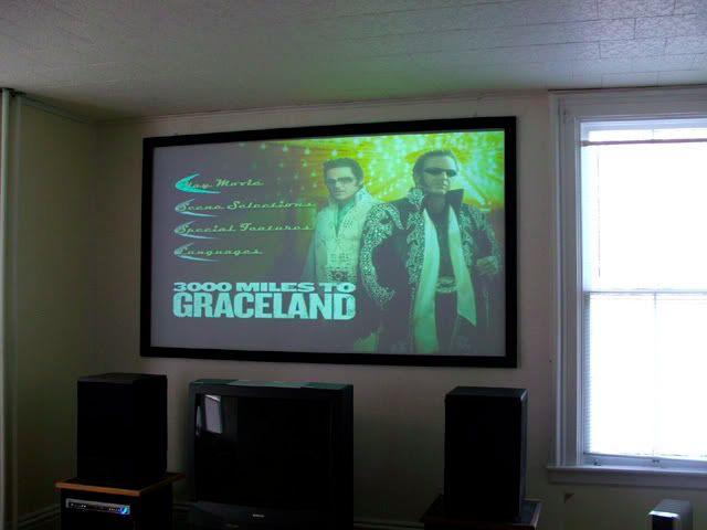

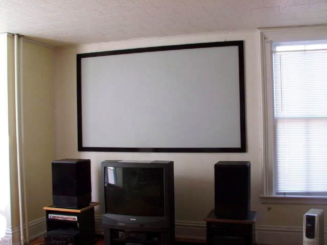

Here is my contribution to get this kicked off:
Room Condition: white walls, cathedral ceiling, wide viewing area
Light Control: little to none, tons of ambient light
Projector: Evo, 800x480, 300:1 contrast, 1000 lumens
Projector Mount: Ceiling, pointing about 5 deg downward, 7-8 ft in air
Screen Make: DIY fixed
Screen Material: White Parkland Polywall, black felt wooden border
Screen Size: 96" diagonal (15:9)
Height off Floor: Roughly 4 feet
Approx DIY cost: 1x3 wood, paint, poly, parkland, brackets, felt, glue = $65
Alterations: 2 coats gray paint, 2 coats polyurethane
Recipe if applic: Behr quart #1050, lb 0 4 0, yo 0 1 0, Behr quart poly
At night, low lights
At night, w/room lights on high
During day, worst conditions possible

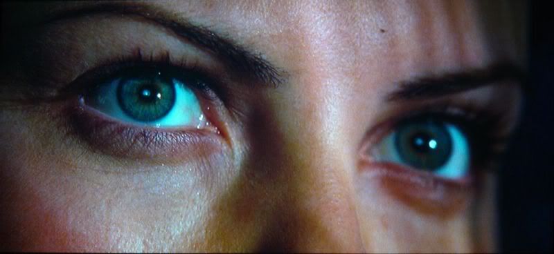

Fifth Element, no lights

Here are a few screen shots that aren't the best. I don't have a great camera, but will get better pics in the future. The DVD player is an Oppo 971 and the projector is in low lamp mode with Brilliant Color off and iris off as well. Only brightness and contrast calibration performed using the GetGray DVD.
Nemo at School
Nemo Bruce
Non Superbit 5th Element
Here are some pics of my room.
http://www.avsforum.com/avs-vb/showt...&post9796602
