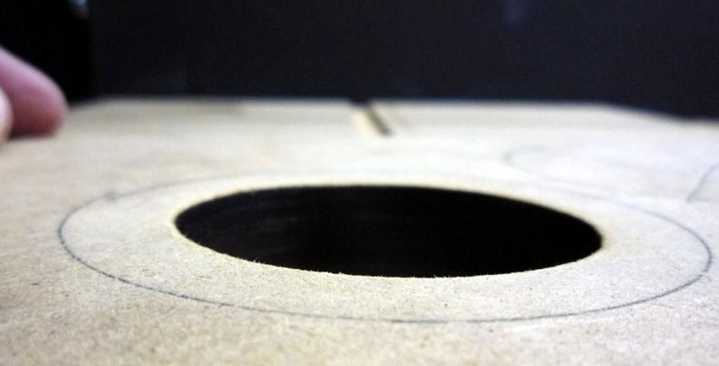

So I setup the drill press with a 2" holesaw (2" cutout as recommended by PE for this cup part#260-283).
I quickly remembered why I don't like to use holesaws in MDF; the wood burns. :mad:
And this is what your holesaw looks like. That MDF dust and the chemicals used to bond it to make "wood" just melt. This will take some cleaning to get nice again.
Additionally, it leaves a raised ring on the backside. But a quick scuffing with 60-grit sandpaper fixes it right up.
And smooth again. This step was not necessary; I could've just left it. But I would know it's there and this cabinet would not sound "as good as the others" b/c of it. OCD? You betcha. :D
Terminal cup fits OK, but it is a smidge too wiggly in the 2" hole for my tastes. But in order to get a 1-7/8" hole I would've had to break out the router and the Jasper jig...no thank you. The cups would look nicer recessed into the back...we'll see if my OCD kicks in or if common sense prevails. :D No one is going to look at the backs of these and say "Ooooooh....you didn't recess the terminal cups...you failed. LOL!

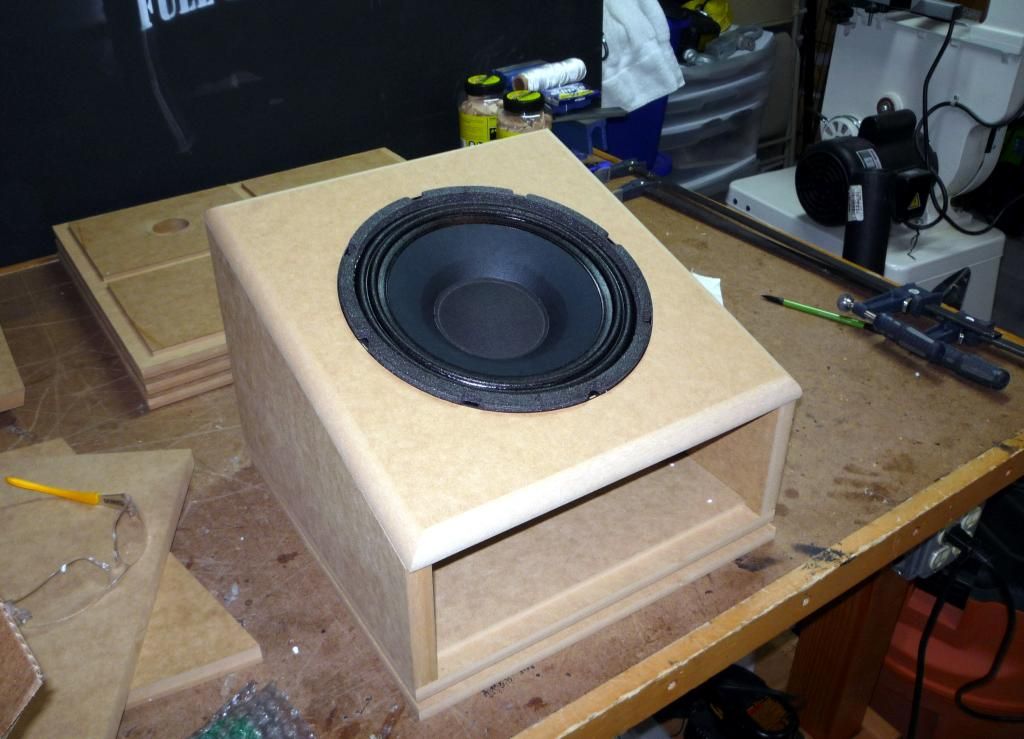

I mocked up the enclosure with the drivers, minus the bottom/top panels, so I could see where I would have room for the terminal cup and crossover. Being this is a slant-front box, with a very small bottom half of the enclosure, I knew these parts would have to go up top.
Front view.
Back view with terminal cup and crossover board in place.
So away to drilling the back panel of the Volt 10's I went. At the end of the night, all the machining operations for these 7 speakers were done. It doesn't look like a lot of progress, but laying things out, thinking of what could interfere with what, all that takes time and you know how it goes. "3 hours of work for 3 inches of progress." But we love it, don't we?

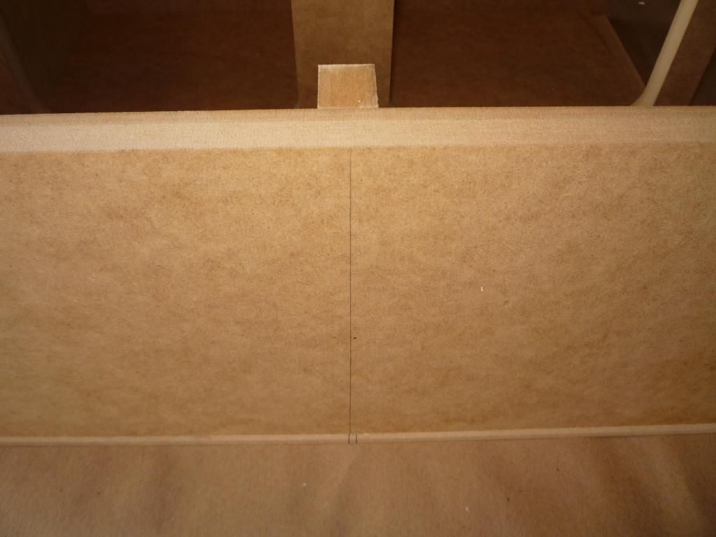

Started off by marking nail lines on outside panels, to help me put brad nails where they should go.
Did this on all sides of the cab, including the baffle. Time consuming and boring as hell, but I only had about 10 brads that missed the mark and went in sideways and shot in/out of cab. For 7 cabs, that's not bad at all.
So where do I start? OK, I learned something today. I have never built a cab using panels that were already rounded-over. The 88 Special and Volt 10 kits both come with a baffle that is already rounded over. This initially gave me fits when trying to nail the thing down.
This is a pic of a Volt 10, before I figured out you have to pretend the round over isn't there and try to hold the brad nailer as perpendicular as possible.
I used 1.5" brads and yes, my PSI setting on the compressor was correct. I just was holding the gun wrong for the roundover. I have a lot of work to do with the Dremel/cutoff wheel to sand those brads down.

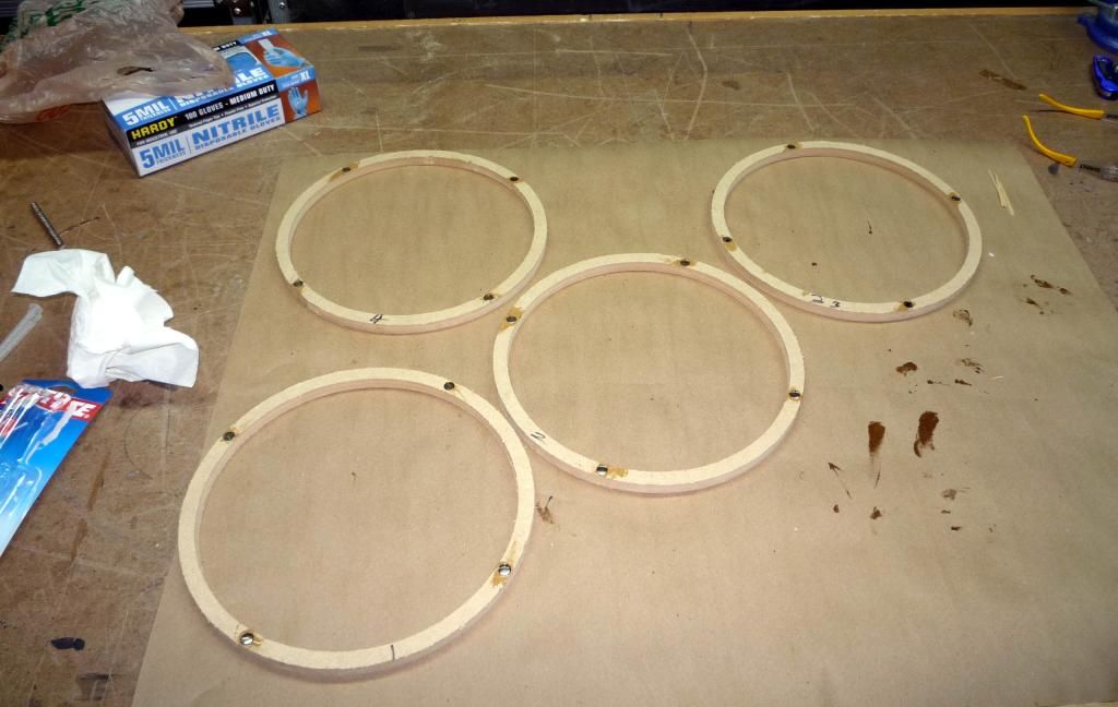

Rings, rings, rings.
I spent about 5 hours tonight doing something...must've been worthwhile and awesome because I spent about 5 HOURS doing it. What was that I did? Was it...
The baffle for my awesome 4x10 subwoofer cab?
No. Not it. So it must've been...
The baffle for my awesome 6x10 subwoofer cab?
No, no...crap, what DID I spend my entire Friday night doing? *AH-CHOO!!!!!* Ah, right! Inhaling MDF dust! I made MDF rings for speaker grills for my Volt10's. And I got to make them twice because I suck at basic math and forgot to calculate for the diameter of the router bit! I'm so lucky!:rolleyes: Should've just had to make 4 rings. Should've just had to have used a single 2'x4' piece of 1/2" MDF. But noooo.

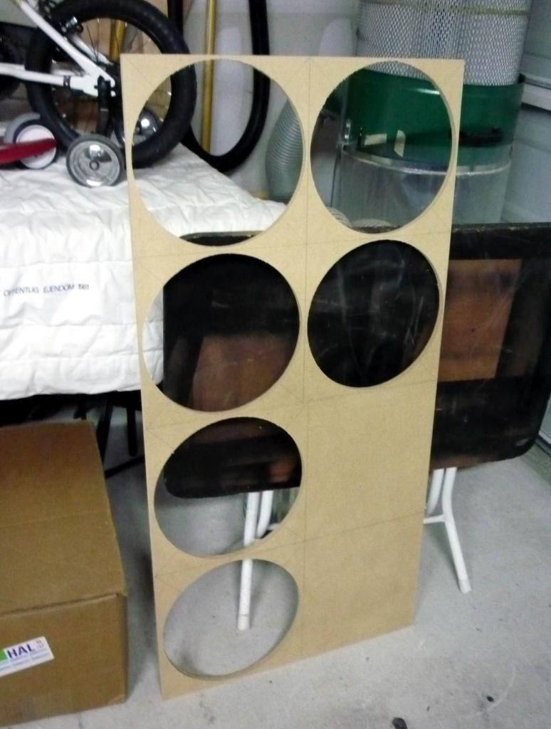

I bought a single 2'x4' piece of 1/2" MDF thinking "I've made rings before...all 4 will fit on 1/2 this sheet and if I mess up I have the other half!" I was so smart...only need one sheet." Yeah, right. Found myself going back to HD two hours later for more MDF. /bangs head on keyboard Guess what? You can't fit 25" of cutouts on a 24" wide piece of wood. AMAZING.
So enough melodrama. I wound up with these. Look carefully, Oh DIY crowd, and ye shall be intrigued. ;)
I finally got the rough draft of my Volt 10 grills/rings done. The holes/shiny round things you see are 9mm x 3mm Neodymium disc magnets from EBay (I paid $14 shipped for 50 of the little buggers). The magnets are Epoxied in.
I won't drone on about my initial mistake; suffice to say I suck at math and they were too narrow to fit the magnet. (really need a "head on keyboard"GIF on this forum!)
I cut the rings using my router and my trusty Jasper Jig. The TOOL works perfectly; it does exactly what you tell it to do. Assuming you are correct, you'll be happy with the results. If you're not correct...ah, yah. :( This picture shows a perfect disc. And it's the wrong size. LOL!
So how's all this work, anyway? You cut out a disc/circle, out of which you will cut your ring. INSIDE said ring, your driver will fit. Here's the leftover disc, after I've cut the ring loose from the outer diameter. I hate MDF. See all that dust? That's from ONE freaking cut. I hate MDF.
4 hours later I wound up with these four properly-sized rings. Note that they already have 4, 3/8" x 1/4" deep holes in them for the magnets.
How do I know they are properly sized? TEST them, my Dear Watson.
Here is a ring and the magnet sitting there, waiting for a home.
3/8" hole
Magnet next to hole
Magnet in hole
Drill 16 holes (4 holes in 4 rings), squirt in a dab of this 5-minute Epoxy.
Stick the magnet in each one, ensuring every magnet goes in the same way/direction ( polarity!), and wind up with this.
Tomorrow I will sand down the rings and round-over both upper corners. Then I will drill corresponding recesses in the Volt-10 baffles, embed/epoxy the magnets, ensuring to observe polarity so the rings actually STICK to the cabs.
After that is spackle/sand/spackle/sand the cabs, then prime, then Duratex.
AND THEN there's putting the grill cloth on the rings, crossovers to build, cabs to stuff, drivers to break in, etc. Got at least 3 weeks left here, folks. Stay tuned. Thanks for looking.
