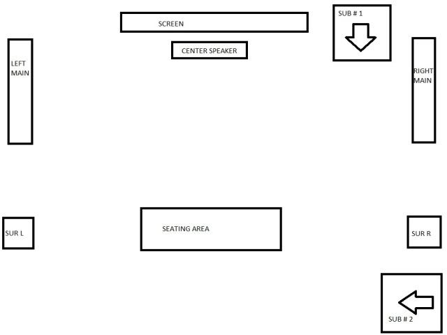

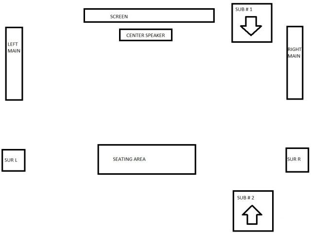

I have had two MFW-15's for over two years now in the same spots. I recently started reading a little more into sub placement and realized how I had them positioned may not have been the most effective. I only have two choices for placing the subwoofers in the room due to other things in the room that cannot be moved. The sub in the front of the room near the screen cannot be moved and has to stay where it is. The sub in the rear of the room can be moved to the opposite side of the wall or turned around so that it projects towards the sub in the front of the room.
Just by looking at the pictures I provided, which of the two "possible" setups would look to be better? In the first picture is how I currently have the sub's and yes the rear sub is pointed in the opposite direction towards the wall. It would be difficult for me to try out different positions because I would have to order longer cords and I do not want to do that unless it would "probably" sound better there. If I turned the rear sub to fire towards the front of the room as in picture # 2, would they cancel each other out and not good?

good read here
http://www.audioholics.com/tweaks/ge...-calibration-1
Mid walls work fantastic
its worth the effort if you can swing it
Mid-walls will probably provide you with the flattest response, but at the expense of less output. It's best to experiment and find which sounds best to you.
I have both of mine seated inside to my mains in the front of my 10x20 ft room, about 2.5 feet from each corner. The "sweet spot" is pretty much anywhere I sit.

I thought only subs at all 4 wall midpoints would cause a loss of output but that subs at 2 wall midpoints would be ok in that regard. I've gotta find that white paper and read it again.
Edit: I do agree that of the three present #3 seems like it would provide the flattest response, but you still need to try it out by listening and measuring (if you are inclined to do so).

All rooms react differently as there are so many variables to be accounted for (what walls made of, other stuff in room...). The places shown to be good and recommendations are a great starting place. The only way to really find best place is to try several different setups with measurements. Of the three shown I would guess opposite corners, but this is just a guess as nobody can tell from pics which will work best in your room.

good advice...also a strong argument for multiple subs. i have a trinity located halfway on each sidewall, a s/c reference to the inside of each front main and an MBM12 directly behind listening position...
flattest response....mucho output
actually could use another MBM to keep up with the other subs...
as always...headroom is king
of your present choices, i would look at option 3 as well...

Thanks everyone... Unfortunately due to other things in the room I can only position the subs in those three different configurations. I guess I will buy a longer LFE cable and extension cord to try out the sub like in picture # 3. How do i take measurements of the subwoofer to see which location provides a "flatter response?" What kind of equipment would one need?

If you don't have all the equipment, symmetrical placement usually works well.

At one time I had mine placed in your option2 config. In my room, it caused about a 20db loss of output! Didn't work for me.
After dozens of configs, I ended up in the middle of my front wall and symetrical on either side of the center channel. I'm not flat, but hoping to EQ that.

B Feelgood, #1 & #2 look problematic, and there really isn't much difference between the two. I like #3. I have heard MFW-15's in this configuration, although that doesn't mean anything in YOUR room. I would try #3 first, though.
Put one in the corner and turn the other one off. Dial it in and move it around a bit. Then switch it off and do the same to the other one. Fire em both up and let it rip. Run room correction software at this point if needed.
