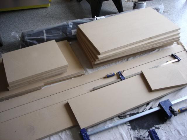

3 sheets of 1" MDF all cut up and ready to rock

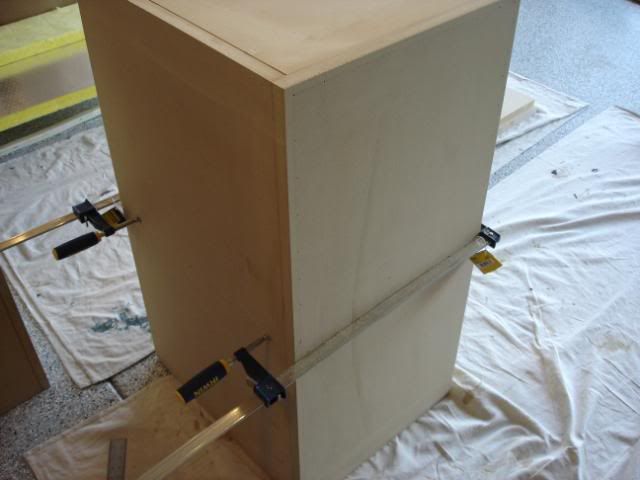

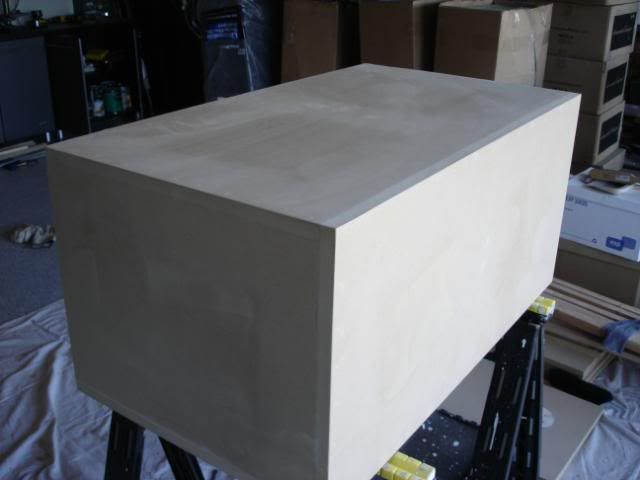

Some of my nailgun/glue/clamp mojo
[/IMG]
[/IMG]
[/IMG]

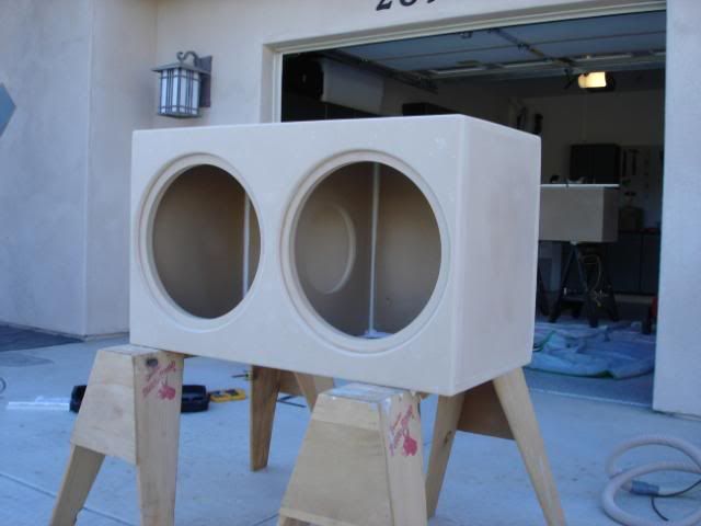

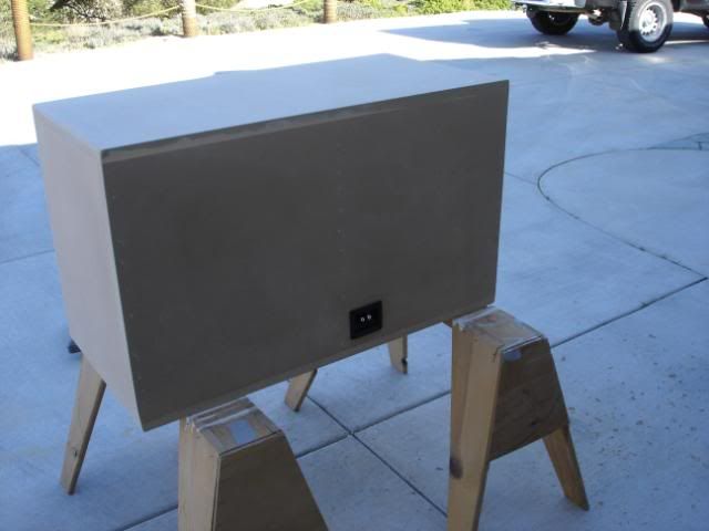

Cabinets ready for finishing
[/IMG]

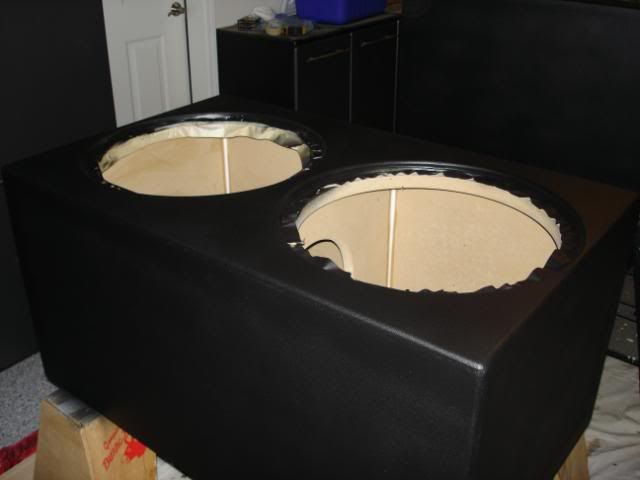

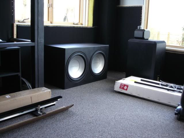

2 of the boys in their new home, all cozy and snug
[/IMG]

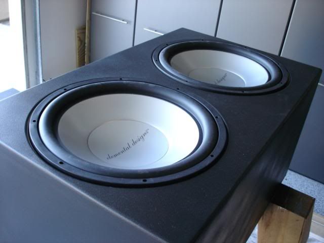

One of the subs in the yet to be finished theater.
