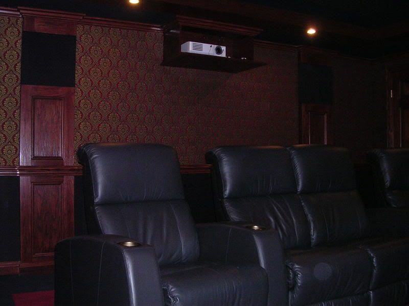

Well, it was 2+ years (started in November '06) in the making, but I'm finally getting to starting my construction thread. The problem is the construction is done (well mostly, we're never done). So I guess this is my construction is done thread.
First, let me just say I *never* could have done this without the help of everyone on AVS. Forget the fact I could barely use a hammer when I started on this trek, but the inspiration alone was enough to get me going. I know everyone does this and I'm sure I'm forgetting some people, but I need to thank some people by name.
Thanks to swithey, chinadog, mbgonzomd, bpape, jikkjack, sandman, ronnie_jackson, eq_shadimar, garykagan, w00lly, strange_brew, and arron_hinni. Also, some non-AVS people like Charlie, John K, Jeff, Johnny D and Frank. All you guys answered many questions for me over the two years. Thank you. I really appreciate the help and so does my family.
Ok, enough gushing (can you tell I'm excited about my HT?). On to the important stuff. Quick summary here with some details and pictures to follow.
- Drywalled room dimensions: 16' 6" W x 18' L x 8' 6" H
- Finished dimensions: 16' 2" W x 15' 6" L (30" behind the screen wall)
- Projector: Panasonic PT-AX100U
- Screen: SMX 2.35 AT 110" viewable
- A/V Receiver: Pioneer Elite VSX-01
- Speakers: Ascend Acoustics 340SE L/C/R and HTM-200 SE for side and back surrounds
- Sub: Hsu VTF-2 MK3
- Blu-Ray: Pioneer BDP-51FD
- Gaming: XBox 360 with HD-DVD drive
- TV: DirecTV HR21
- Power Protection: Belkin PureAV PF31

First and foremost, I wanted this to be a DIY project. Saving money was one reason, but I just felt I could do it myself. My family and friends all thought I was nuts because I've never been known as the "handy" type. But after reading some of the construction threads here on AVS, I really wanted to give it a go. And did!
Some other key elements I wanted in the theater:
- Fixed screen in a dedicated room. At first I started with a real open floorplan for the basement. I figured it would be better for entertaining, but the basement space just wouldn't agree. Mostly HVAC lines and support poles. I know I could have moved them, but I couldn't get the significant other on board with that idea. In the end, I'm very happy to have gone the dedicated room route. It allows for much more use in the basement as other members fo the family can do their own thing in the other rooms.
- 2.35 anemorphic screen. After venturing into that forum, I just know that I needed to rid myself of the dreaded black bars.
- Hidden speakers and acoustically transparent (AT) screen. I liked the clean look of hiding the speakers and really liked the idea that the sound would come from behind the screen, not somewhere around it.
- Stage. It just seemed cooled. In my picture above it's hard to see, but it's there. The sand was a PITA though.
- A black/red/oak motif. I wanted something that was classy and reminded me of the old home town theaters. I'm not sure that's what I've done, but I really like how it's come out.
- Two rows of seating. This one is still in the works. Given my room dimensions and desire for a AT screen, this has been tough. As of this post, I'm still not sure if I'll do a back bar or a riser with seats.
- Light tray for downward lighting and in-movie lighting. Here I stole from Ronnie and Sandman. I have can lights in the tray with a blue led rope light in the tray. Works great and I love the ambient blue lighting during movies.
- Acoustically treated room. Both for good sound and keeping sound in. Thanks for Bryan Pape for his designs and providing me all the materials for doing this. The room sounds fantastic. While it's not totally sound proof, it's dang close. I did the stagger studded walls and green glue drywall sandwich.

So, what did all this look like when I started? Well, pretty empty. I cleaned out the whole basement. Pushed everything into the back area that wasn't getting finished and got it ready to be framed out.
Ok, time for a confession. So this was a DIY project right? Well, I didn't do everything. It took me two years as it was, I needed some help
I had a contractor (thanks Johnny) frame out the entire basement. Then I had a electrician do *most* of the rough electrical. The contractor handled getting a plumber for the full bathroom and wet bar. The contractor also got someone to do the drywall. The drywall guys never heard of Green Glue, never mind actually doing it. I only DD/GG the HT room. All the walls and the ceiling. The ceiling was also done with furring strips over the joists to give me a little more sound isolation.
I ended up doing all the low voltage wiring and rough electrical in HT.
