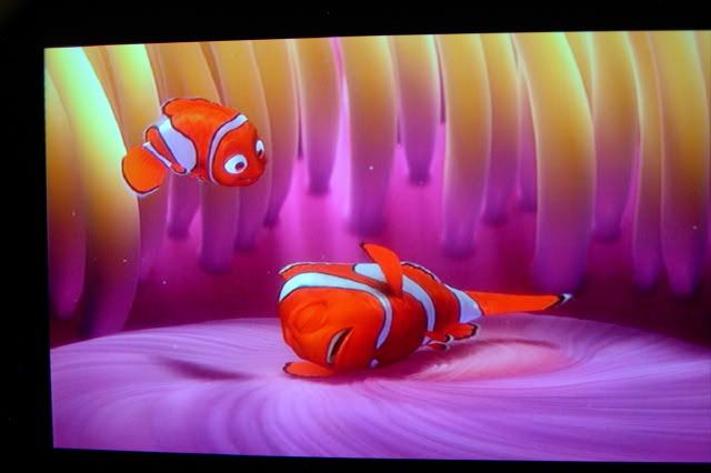

Your hopes are your reality. MississippiMud all by itself is a terrific screen application. It has such an extreme Viewing Cone, that it is safe to say instead that it actually has NO viewing cone.
Illumination across the surface is virtually equal. At least to the point trying to find the discrepency would be redundant.
Here is one extreme example;
http://img.photobucket.com/albums/v4...waysslinky.jpg
...........and another one that is "Non-Digitally" created.
http://img.photobucket.com/albums/v4...ussideways.jpg
And the next one? Well, it just "Eye candy", that's all that can be said about it.
http://img.photobucket.com/albums/v4...mowakesDad.jpg
See less See more
Yep.............looks pretty good to me!!
