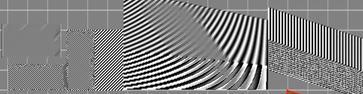

So I tested several line patterns and the most significant parts I combined in one pattern.
Name: Käsescheibchen (I needed a long word for the ticker)

First, don't get shocked - the pattern will NEVER look totally clean and "peaceful". I had to build in points (noise), lines and movements that can not be handeled by today's deinterlacers. And some that will be almost deinterlaced. But just in these parts the different video processors and deinterlacing options show determinable effects.
And please do not try to compare 1080i vs. 1080p Slices in order to get the right answer cause it's irrelevant: not the fastest Computer, video processor or GPU in the world will be able to deinterlace into progressive!
Relevant for "real-world video playback" is only the picture-section I called "video reference" and even these pics are something you will see close to never watching "average TV". Only sometimes in playing fields, race-courses etc.
-> Stripes like these are forbidden in broadcasting since first TV studio till today (wardrobe, stage/studiodesign ...).
With the exception of banners and sports..
But may be - if one day 720p (progressive) becomes lowest standard the stripes will come back? Some 720p stations love it to start with an aggressive "full with lines" trailer all day long - just to bother the interlaced..
All following screenshots in original size (unscaled).

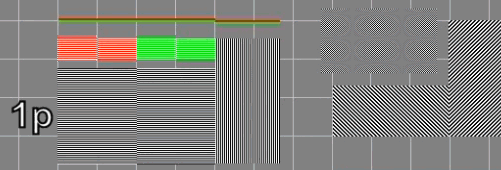

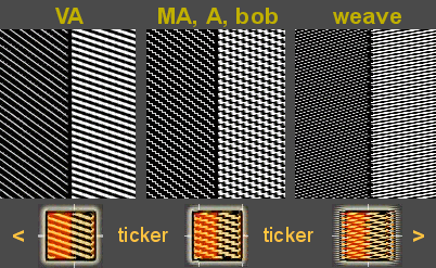

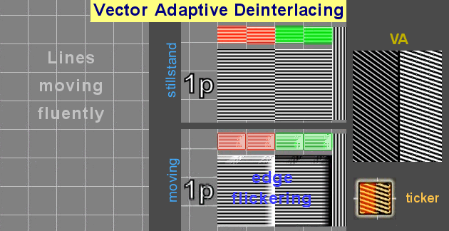

Determine Vector Adaptive Deinterlacing:
If VA is working, the lines in the orange tubnails of the ticker and in the "determine vector adaptive" section should remain lines, also in motion:
As you can see in the above screenshot (original size) the differences between VA and MA are very significant and easy to distinguish.
If you are still unsure exit MPC, enter Catalyst Control Center and switch to Motion adaptive. Then start the pattern again. If there's no difference or Vector adaptive is not selectable in CCC you've got other problems...

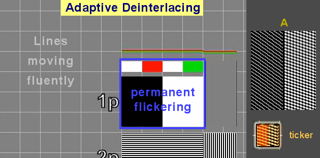

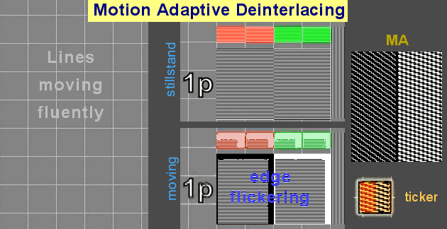

Determine all deinterlacing options of CCC:
IMPORTANT:
  • all options will flicker during the odd (2nd) moving up-down. The comments refer to the even up-downs (see "Movements").
  • some screenshots cannnot show exactly what you see watching the video. Below e.g. Adaptive and bob show a black+white "1p" rectangle. But video play-back will show both in white, flickering.
  • if you really see not flickering plain monochrome 1p fields (no lines) in grey or black+white that means DXVA (hardware acceleration) is switched off or currently or forever impossible in your setup.
-> the lines in the following pics are very tiny so it's important to see them in original size. The browser must not be zoomed in any direction. In Firefox and Internet Explorer just press Ctrl + 0 (zero).
Internet Explorer + AVR advertising might compress some of them anyway - also if your screen resolution is much less than 1920 wide - then you only have the chance to right-click and download them, sorry!

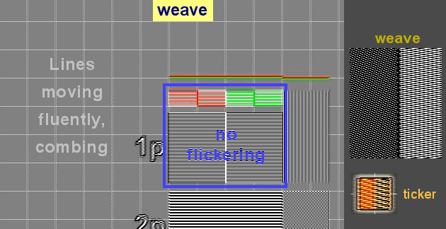

Weave simply adds 2 consecutive fields to one. The even up-downs perform fluently but plus an ugly extra: combing.

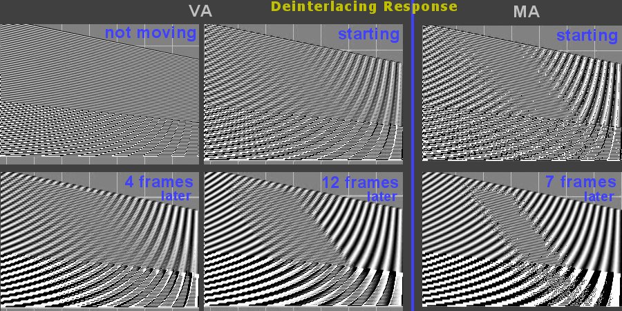

The "response - noise" section, here shown in even (2x2p= 45°) VA movement:
In this area I collected pixel and line segments hardest to deinterlace. But, surprise surprise, on some of them Adaptive or MA do a better job then VA. Glimpse on algorithm combinations rendering real-state, "edge-fluctuation", or different kinds of noise.
Something I call "Deinterlacing Response":
Normally short response time is best, but today's deinterlacers seem to tell us the reverse is true.. Here a weak attempt to explain: the deeper (so slower) the deinterlacer calculates algorithms on certain patterns, the higher qualified he is...
Next screenshot shows a nice Fluxus segment and if it starts moving VA produces kind of a fluctuating deinterlacing-zone. Inside the zone deinterlacing is partly possible.
Cool, "Live" study the calculations progress! Visually analyse the bottleneck of (video-) processor speed.

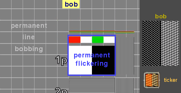

MA does also produce the shadow but much faster and not as wide. Adaptive and bob only flickering (fastest).

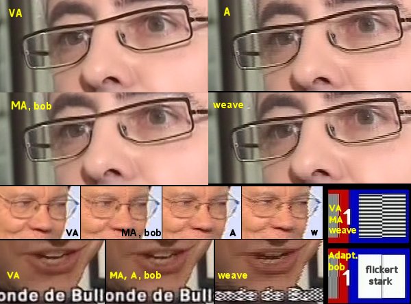

CCC Deinterlacing options: Vector Adaptive (VA), Motion Adaptive(MA), Adaptive (A), bob and weave
-> the lines in the following pic, esp. the blue framed 1p horizontal are very tiny so it's important to see them in original size. The browser must not be zoomed in any direction. In Firefox and Internet Explorer just press Ctrl + 0 (zero).
As you can see in this non-scaled screenshot the differences between VA and MA are very significant and easy to distinguish. Important is the upper fat rim of his glasses:
- VA smooth, MA rippling
Note: the lower thin rim of his glasses will sometimes show very slight rippling even with VA. Regard - switching to full screen appeals like a magnifying glass to the ripples depending on the size of your screen and the viewing distance.

I know some are just going to say I'm wrong or somehow mistaken, but I get vector adaptive deinterlacing for this test pattern with my Gigabyte HD4550 and the beta Cat 8.10 drivers. Yes, I know..."IMPOSSIBLE!" you'll say, "THAT CARD IS TOO WEAK!", but I swear it works. This is with Vista and Aero turned _on_. Perhaps there is a hardware difference in the Gigabyte version of this card?
I think the 4550 is plenty powerful to do it, it's just a driver bug. I was also able to get good deinterlacing with some version of Cat 8.x and my Sapphire 4550 with Aero enabled. The problem with those drivers for me is that there is a bug in all Cat drivers prior to 9.4 with H.264. With DXVA, the video sometimes "gets stuck" at the same couple of frames while audio continues to play. This is no good for me because I use my PC for playback of H.264 streams from Dish network via an R5000 modded Vip211 and SageTV.
And, my 4550 with Cat 9.6 and Aero disabled produces VA with blaubart's test, but then I get terrible tearing with TV. I even tried using reclock to fix the tearing, but it didn't help.
Originally Posted by blaubart /forum/post/16751032
Thank you, that's my interest. Would you say the 9600GT performs something like VA?
Yes, it looks like VA to me. Very good picture. Nice stable diagonal lines during motion. MUCH better than what I'm experiencing with my 4550 and Cat 9.6.

Looks like Motion Adaptive to me, NOT VA. These cards have generally had trouble with the 2 1/2 men clip I mentioned above. There was an older version of the drivers, somewhere around 162.?? that handled it fine, but for a lot of versions after that it was broken. To my pleasant surprise, the 186.18 fix this again.
Nvidia 9600 GT
As mentioned previously, this card does a great job with blaubart's slices test. It also passes the 2 1/2 men clip test.
Nvidia GTS 250
VA deinterlacing and passes the 2 1/2 men clip test. This is now in my family room PC.

To be precise,
- HD 3200/3300 with a HT 2.0 processor: Only Bob and Weave work.
- HD 3200/3300 with a HT 3.0 processor: Motion adaptive works up to 1920x1080; only Bob and Weave work beyond that (i.e. under dual monitor).
HD 3200/3300 with HT 3.0 is the best IGP (as far as HD deinterlacing is concerned).

here is a first vers. of the H.264 Slicies .
Somehow MPC Video Decoder in MPC HomeCinema can't play it, completely black screen. Radeon HD 4670, CCC 9.6, Win 7 x86, x64.
- MPC HomeCinema/Zoom Player+Haali/Gabest splitter+MPC Video Decoder+EVR/EVR Custom Presenter: Black screen.
- MPC HomeCinema/Zoom Player+Haali/Gabest splitter+Microsoft DTV-DVD Video Decoder+EVR/EVR Custom Presenter: Good (VA works).
- MPC HomeCinema/Zoom Player+Haali/Gabest splitter+ffdshow Video Decoder with yadif+EVR/EVR Custom Presenter: Stops working.
- PowerDVD 9 Ultra: Good (VA works).
- TMT 3 Platinum: Good (VA works).
(Microsoft DTV-DVD Video Decoder is Win7's built-in MPEG-2/H.264 video decoder.)

Edit: you could help me if you do a test with this PAL 25fps h.264 1080i video (German Broadcasting):
A short TV-recording which contains the upper lines of the "video reference" section in Slicies as original (also good to easy determine VA) made by DVBViewer (1080i, H.264, 25fps, silent audio) is here .
- how does it run generally on your mashine(s)? comparable with NZ recordings?
- if VA is working the long square line should show no stepping.

However, I think there is one error in the 1080i PAL movie (haven't tried the others yet): at 5 seconds into the movie, the 1p blocks appear always black and white, even in their original, interlaced, representation, it appears to me.
#26 ·
Hi tempel,
meanwhile all MPEG2 Slicies are tested positive in various hard/soft environments, positive means they show rel. precisely what you see in the screenshots above choosing the CCC deinterlacing options (ATI/AMD 3000, 4000 series cards), also good Nvidia HD cards perform VectorAdaptive.
If the 1p blocks appear always black and white (flickering or not?) means generally 1 or more components of the playback chain cannot dissolve correctly (down to 1p) the odd + even frame.
1p ok during standstill + fully black and white only during movement is something I close to never experienced. Sounds like a disabled weave but then you should see combing. What is your setup?
