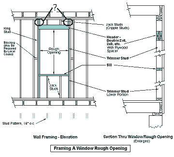

I need to build a small recessed cabinet above a fireplace mantle for a DVD player and cable box etc. To do this, I will need to cut out two studs and install a header, but I'm not sure about whether a trimmer stud above the header is required (see the blue stud circled in the picture). The ceiling is about 15' so I can't put in a stud long enough as I don't want to cut out the sheetrock all the way up. I also want to limit the number of studs I cut out so that only minimal bracing is needed while the studs are out. I plan to attach a 2x10 across several studs while installing the header.
Any suggestions?
edit: This photo is for a window, but you get the idea

Not all the resources indicate the need for the cripples you are thinking about. A factor in this is the amount of weight the wall is supporting, but I can't see much added value with them.

Thanks for the reply BIG,I knew I could count on you! That's good to know as well. It looks like adding the cripple studs at the top might add a little more support. Sort of like a dado compared to a rabbet.
After cutting a hole in the sheet rock, it looks like the studs on either side of my planned cabinet are already cripple studs. There is a header behind the fireplace hearth. So I think I can just cut into the existing cripple stud, and use them for a jack stud for my header.
Here's to hoping the roof doesn't come crashing down when I start cutting
