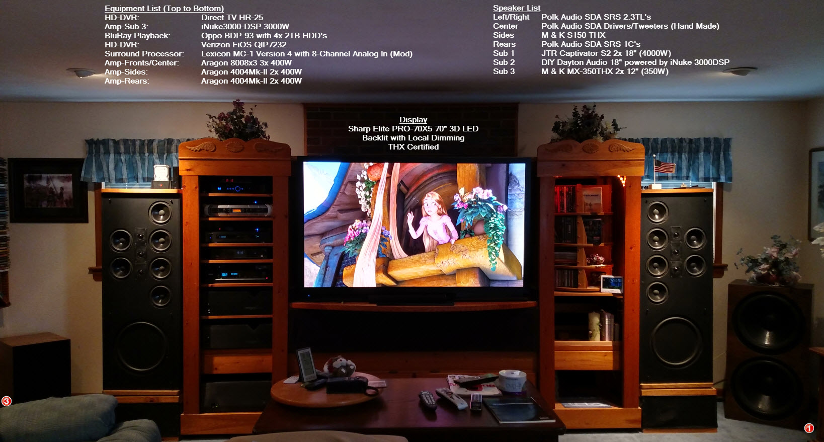

Hi
If anyone is interested, I got my Dayton RSS460HO-4 18" driver
I have it mounted in the Velodyne HGS-18 enclosure.
The Dayton driver has 8 holes, the Velo driver, only had 6.
So I drilled 8 new holes in the mounting flange of the enclosure, and used #10-32 T-Nuts with steel screws to make a good solid mounting. Luckily, all of my drilled holes lines up perfect with the Dayton driver.
The Dayton driver fit perfectly in the enclosure w/o no modifications required.
I also have the iNuke3000DSP amp, but I have not yet received my SpeakOn connectors.
I hope they come today.
Here is a picture of the now DIY sub.
See less See more

Cool! It looks like it belongs in there.
I am looking forward to your impressions after you get it dialed in.
