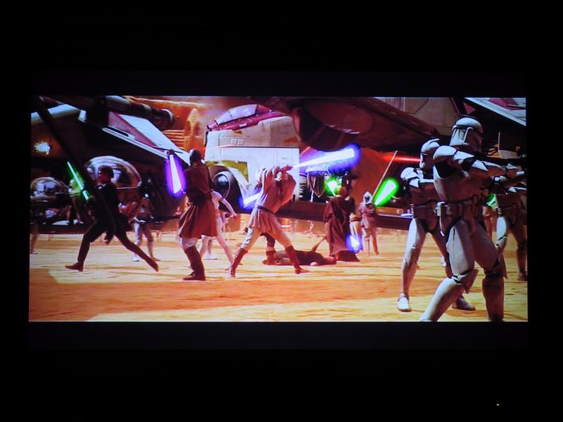

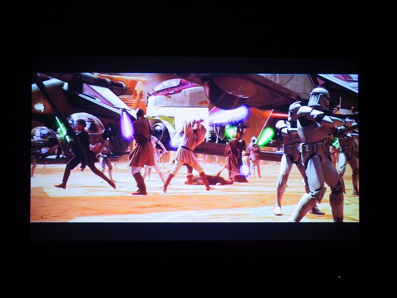

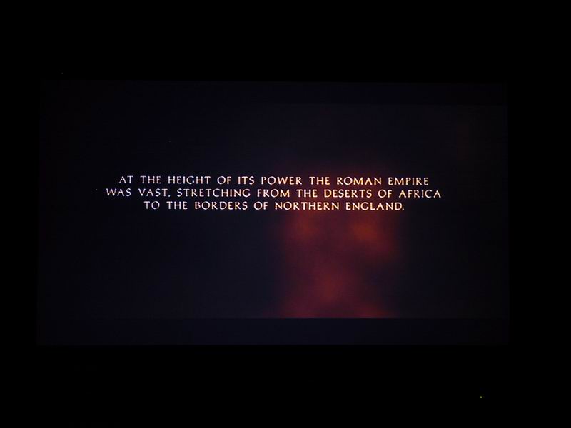

I should start by saying that I am a mild black level junkie. While the black level of this set is really quite good for an LCD, I'm a CRT kind of guy. Anyone who is not a black level junkie will be VERY, VERY happy with this set as-is.
After a week with this display I decided that the black level needed improvement. A full calibration with Avia and SM tweaks were not enough to really tame the black level issue. I think that Panasonic decided to sacrifice black level for a VERY bright display. In its brightest mode this thing has near plasma brightness. This leads to an overly bright bluish gray as the darkest black this set can produce. Contrast is excellent but most scenes have a "fog" over them and dark scenes can be nearly unwatchable for a black level junkie. The user menu and service menu provide no real control over bulb brightness, just the LCD shutters. The LCD panels are incapable of blocking all of the light. The combination of these two factors produces gray blacks.

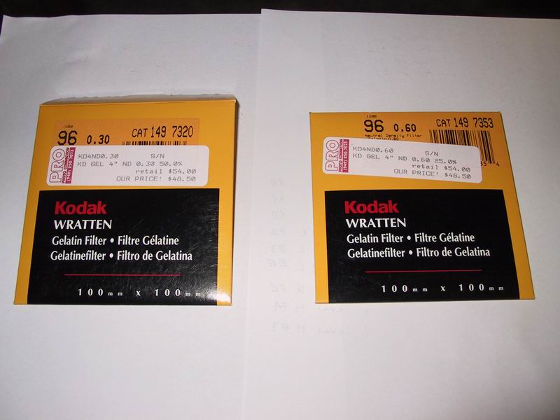

To control black level I decided to reduce light output. The easiest way to accomplish this is to add a filter to the optical engine. The high intensity discharge lamp in the set does not lend itself to a variable level control(a dimmer). The best filters to use are gelatin filters. These are used to modify image forming beams without introducing aberrations. You should not use stage lighting or theatrical gels. The filter you want is a Kodak Wratten Gel Neutral Density 4x4. The package looks like this:
http://www.perrigoue.com/photo/avs/IMG_2432.JPG
These can be found a pro photo shops and online photo supply houses. They come in many strengths, ranging from 0.10 to 3.00. 0.30 is one stop(50%), 0.60 is two stops (75%). The percentage refers to the amount of light the filter blocks. I bought 1,2 and 3 stop filters to experiment with. After careful evaluation I have decided one stop is about right for me. Black level is significantly improved, scenes are more 3D, dark scenes have improved shadow detail and color. The blue tint in deep shadows is totally gone. Blacks are mostly black, still a tiny bit gray. Bright scenes are still plenty bright and punchy. The set is perfectly viewable in my well lit living room with the sun coming in the skylight and 8x10 glass doors. Two stops is perfect for lights out movie watching, even better than one stop but too dim for daylight viewing. Blacks are truly black without crushing. If you are only using this set for nighttime movie watching I recommend two stops.

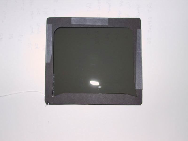

Step 1: Put on the gloves.
Step 2: Trim the sides of the cardboard mount to allow the image to pass unhindered.(see image below)
Step 3: Mount the filter in the cardboard mount. Use the clear tape to keep it closed, not the built in double sided tape.
Step 4: Poke a hole in the lower left or right corner and thread about 12 inches of dental floss through the hole, tying off one end.
You should now have something that looks like this:
http://www.perrigoue.com/photo/avs/ImG_2427.JPG

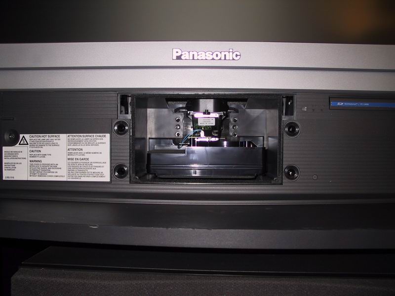

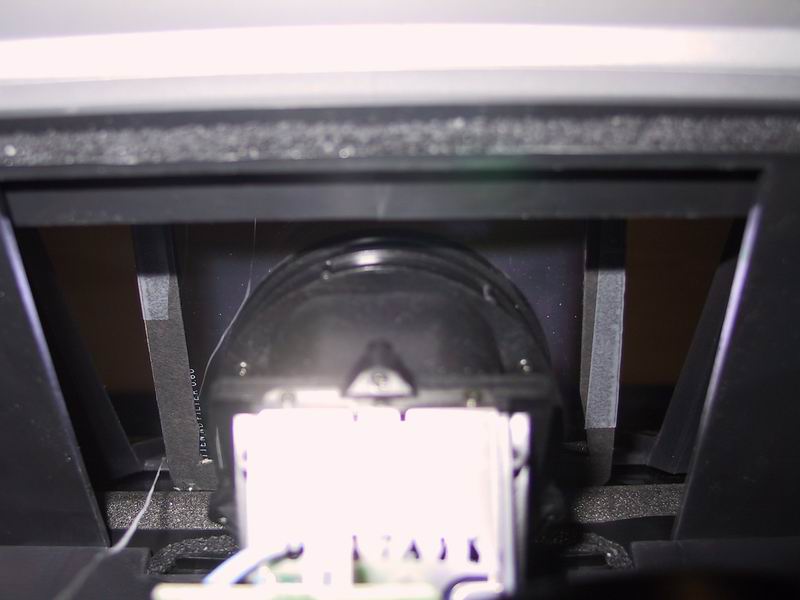

Step 6: Remove the front plastic bezel and remove the projection unit adjustment cover in the center. It should look like this:
http://www.perrigoue.com/photo/avs/ImG_2424.JPG
Look inside the set right above the projection lens assembly(the big round black thing sticking up through the hole). Notice the righteous little "shelf" behind the lens. This is what the back edge of the filter will rest on. Feel inside the opening just above and in front of the lens. You will feel a little shelf sticking out. The front edge will rest on that. The next step is the hardest part:

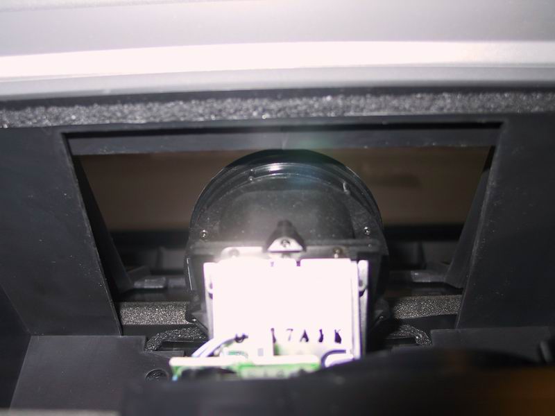

Step 7: Slide the filter, tail-end-up(the one with the trimmed sides) through the opening in front of the lens assembly. Use both hands. The idea is to get the front edge of the filter onto the little front shelf. Once it's there let the tail end flop over to cover the lens. This sounds way harder than it is. Once you are looking at the set this will make sense.
Step 8: Pull down lightly on the dental floss and use one finger to push up on the front edge of the filter. This will help the filter settle in over the lens. The dental floss also prevents the filter from getting lost in the set if you somehow dropped it. Center the filter over the lens. Here are before and after shots:
http://www.perrigoue.com/photo/avs/ImG_2428.JPG
http://www.perrigoue.com/photo/avs/ImG_2429.JPG

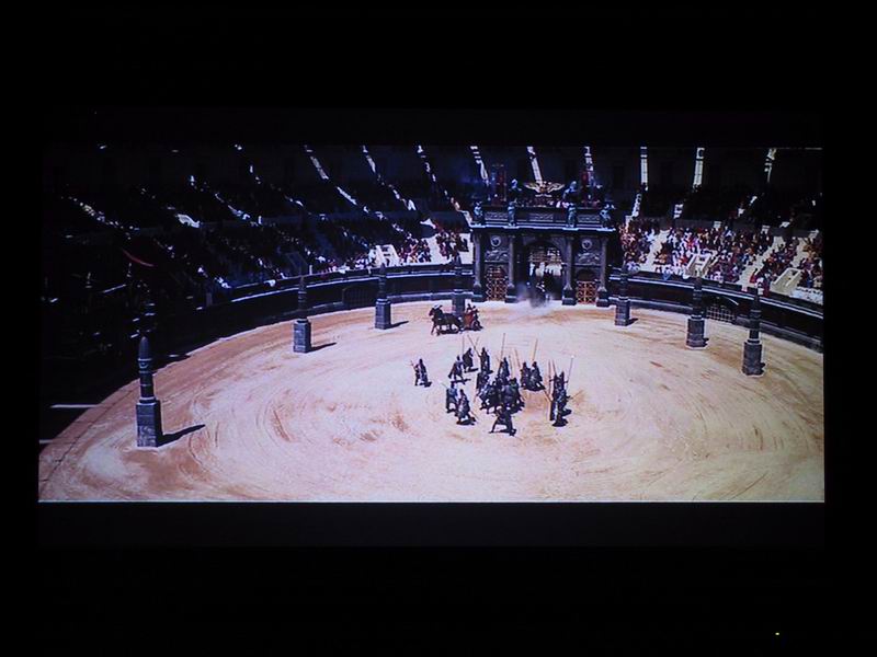

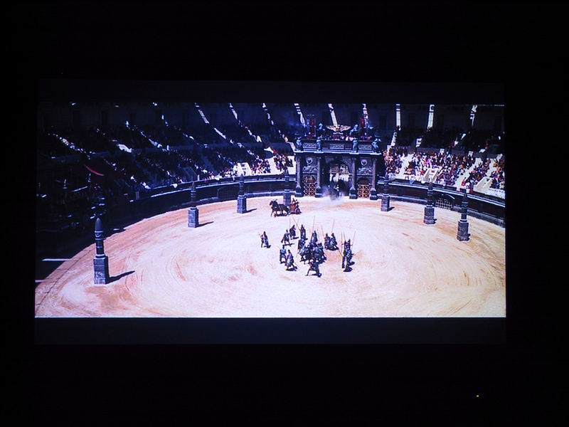

Wont you get the same effect by lowering the levels of the set? It does increase black levels, though by the pics at the cost of shadow detail.
Excellent post with great detail!!
No. The only way to lower the light leakage at 0 percent input is to use a filter tweak. This does not change shadow detail if done properly. No photograph is going to capture this properly because it does not have sufficient contrast ratio and it does not respond to light the same as your eye.
JoePerri,
Many LCD sets would benefit from a color correction filter as well. Did you look at your set with a Kodak Color Print Viewing Filter Kit to determine if it would benefit from a red (cyan blacks) or yellow (blue blacks) filter. You probably could also increase the contrast ratio if that was the case.
Thanks. AS UMR said that is not how it works. The pictures just don't show all of the detail. Black level is greatly improved with no loss of shadow detail or black crush. The picture is substantially better.

1. You should get a job writing manuals. Excellent instructions and good work on the filter! Blacks definitely better. The thing that stands out to me the most is when watching a movie in the 2.35:1 aspect ration I hate seeing the "grayish" unused TV area of my Samsung DLP at night. That has decreased to a very tolerable level on your set.
2. I doesn't appear much shadow detail has been lost at all but the whites on the set in the after state aren't quite as white. If the brightness is turned up higher does that help with that much or is that the after affect of the filter?
3. Would you really void your warranty by doing this? It looks like what you've done is simple enough to undo that no one would know the difference unless you phyisically broke something.
Thank you for the kind words.
My biggest complaint was the gray "black" bars in 2.35:1 movies. This mod has substantially reduced the problem. I am totally happy now. The frustration I felt in some darker scenes is gone.
The whites look great. Even if they were slightly gray, there is no point of reference so your mind sees pure white. Kind of cool.
I don't know if you would void your warranty. This mod leaves no evidence whatsoever. I could remove the filter in 5 minutes right before a tech showed up and he would never know a thing.
