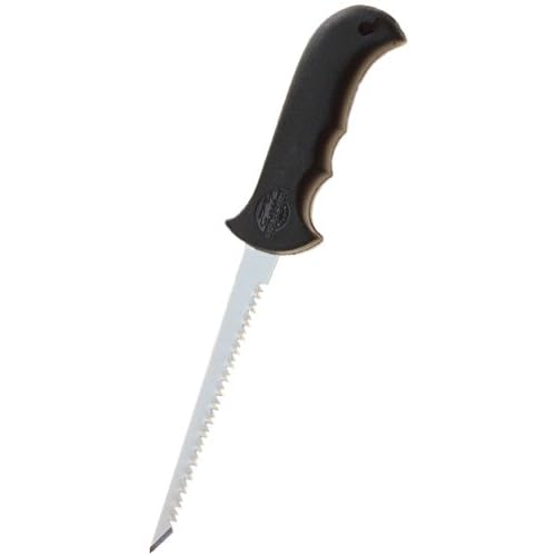

Sounds like the dogs aren't turning, you could try sliding in a putty knife and see if you can get them to turn, otherwise If you are going to be patching the wall anyway you may need to break out the scalpel:
