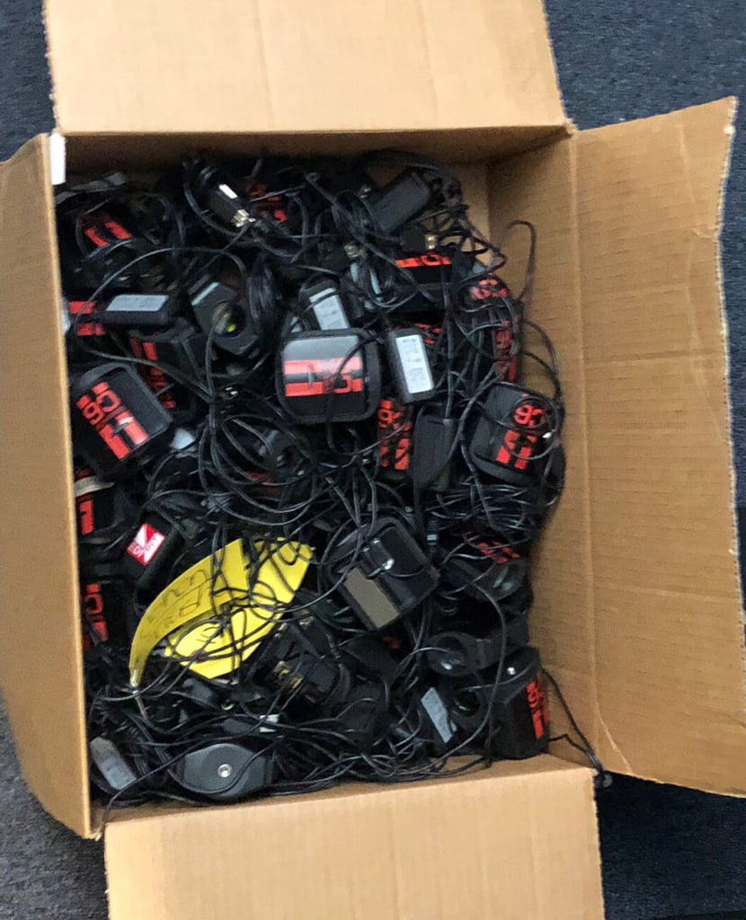

All meters drift, there various reasons, humidity, temperature, how much its exposed to panel heat or to sun, to dust, to any accidental drop/shock, natural aging over the years etc.
BTW see how many C6 failed to pass a verification (original post there):
Also the refurbished C6s went through a rigorous testing process.
Here’s a picture of the box of meters that did not pass the accuracy testing process.
But profiling a colorimeter using a spectro as a reference, it can fix any drift and improve the meter's color accuracy.
