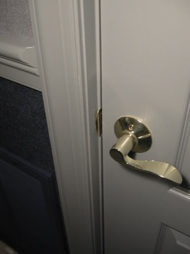

The same holds true for the case molding around a door frame. You add a strip to build out the edge of the door frame and another for the other edge of the molding. I used the 1 1/4 inch thick finger joined exterior trim boards (Home Depot) that I ripped into one inch strips from wider boards to get good tight wood that looked good painted.
here is a shot of a door that was built out with the furring strip technique. It looks best to use a reveal (offset) when putting on the furring.
