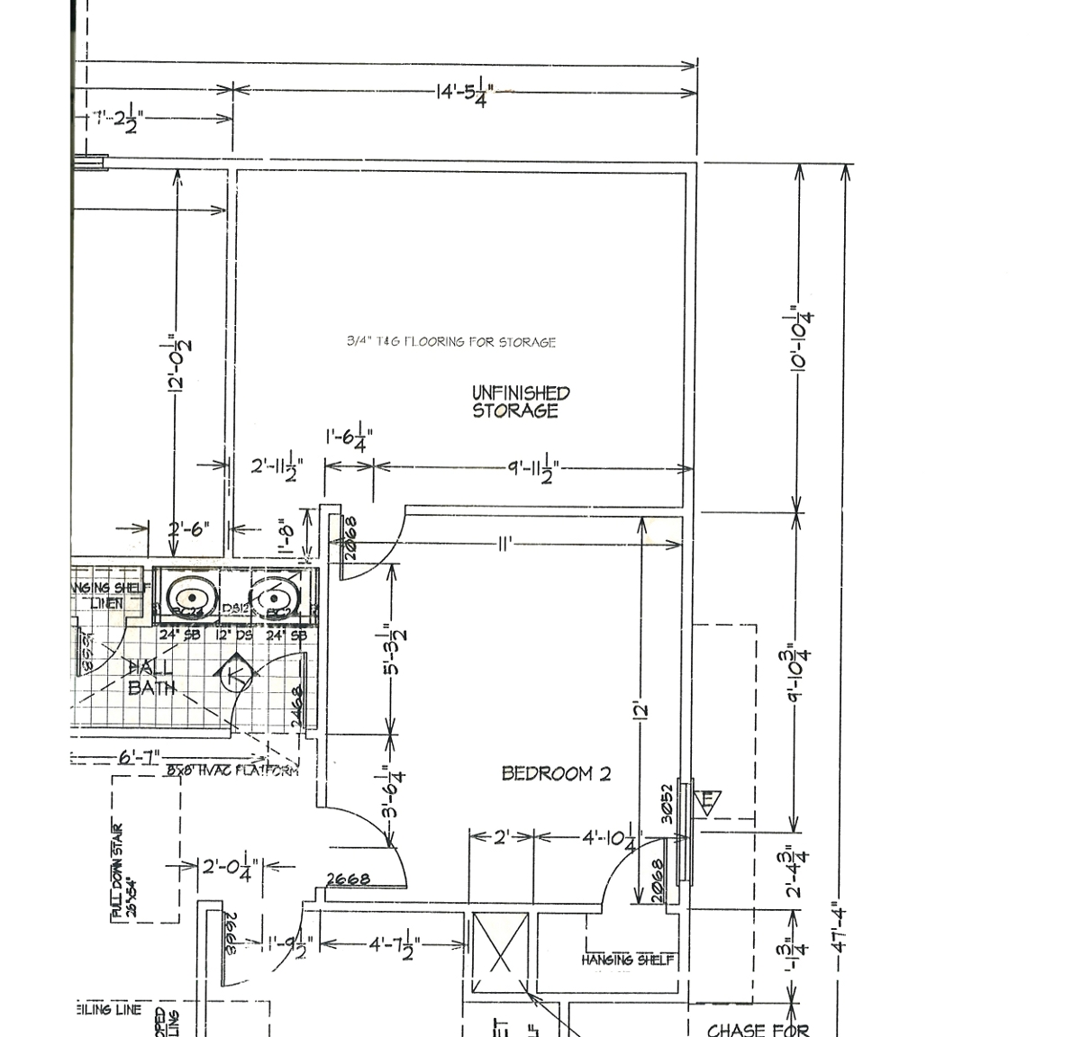

Well after looking for years and now finally having some place to build one I've started my theater. My room is a bit narrow (11 feet) but I have plenty of length for my purposes (over 20 feet). My layout will be very similar to rsprances "Arthouse Theater" (great theater BTW). I have not nailed down a style yet but I have something in mind. I guess I'll tackle that part once the room is in the right configuration.
This is what I have to start with:
I'm taking bedroom 2 and the unfinished storage area and removing the divider wall to combine them into one space. I already checked with the builder and he verified that the wall I want to remove is non-load bearing.
This is what I will turn the space into:
To even start the theater construction I have to move the hallway door to give me space for the sound stage, frame in the air ducts that run from the attic to the first floor in the unfinished section, and then frame in the back and rear side walls for the theater space itself. Since I will have the extra space on the side of the rear section I am going to put a small wet bar and have a location for the equipment that is nice and out of the way. The door at the rear of the theater will allow me to access the rear of the equipment with no effort at all.

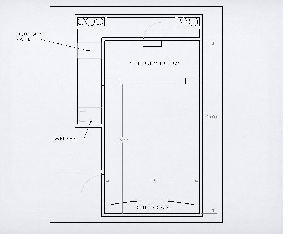

I would put the first row of seats around 10' - 11' from the screen and then start the riser right behind them. That way you can move your rear seat forward, away from the back wall (and the door?). In fact, I think I would eliminate at rear wall and rear side wall all together and just make the room asymetrical.
My room is similar to yours and I was able to get comfortable seating for 9 with just over 10ft of finished width.

I checked over my current sketches and my head location for the front row is right at 11 feet so I think that will be OK. I do have room to push the riser forward some to move the rear seats up some and I may end up doing something like that. I started out with no rear theater wall but with it there it gives be a nice place to stash the electronics, cleans up the messy back wall with the ducts and I just like a nice rectangular room

I have revised my plan slightly after doing some framing and check for actual space. I have removed the rear wall and just extended the side wall all the way back. After framing up the walls over the ducting there just was not going to be enough room between the back of the theater wall and the ducting wall to be practical.

I am surprisd though that no one has said this, but have you considered flipping the room around? I know you did the door and all but you might still want to consider it.
How many seats are you planning to do? Depending if the plan is to put the screen on the wall vs a false wall with AT screen you can possibly fit a third row bar in that type of setup. Especially now that you have the door on the left wall for equip. access.

I considered having the screen on the other end but I could never come up with a configuration for the rear riser and the aisle between the seats that I liked. I really did not want off center seats so my only other choice was to move the door. If I would had had 2 more feet of width I could have done it.
As for seating, right now I'm planing on 2 rows with either 5 or 7 seats. With my extra 18 inches I have gained I might do a bar stool style 3rd row now though. Here is a rough layout of my seating plan. I looks a little sparse but I did not sketch in any columns or wall treatments on this layout so the actualy room width will be smaller in the end.
