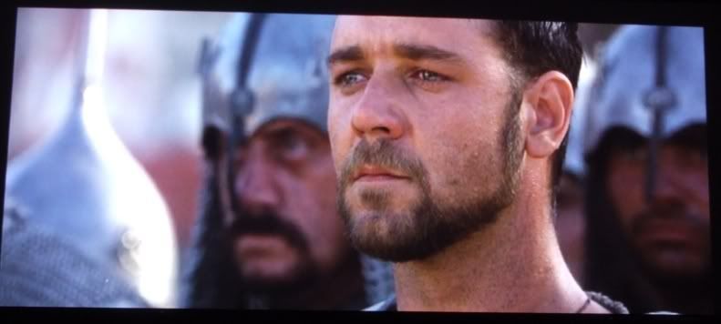

Hey folks!
Well, ive just finished making another DIY screen and thought i would take some Caps and show them.
I am not that handy with a digital camera and its only a cheapy digital so pictures dont do it justice, and its not straight on, but will give you some idea.
Projector is optoma hd70 using a 2.37:1 diy screen 100".
Dvd's are all SD using the upconverting sony 76h(aussie model).
The board is bought from a hardware store(bunnings here) and is:
Particle board/white melamine 16mm
V 040406
F/L 0570132
09314576089279
(in case any aussie's would like to buy it), comes in 2400x1200mm.
AU$39
This board has a shine/hotspotting to it, if using as is... so it is highly recommended to do one coat with (i used robertson brand name) matt clear acrylic, water based.
Now some pics

Ok, those were pics of the diy screen, now...
I got some samples from a well known manufacturer here in australia, just some small A4 samples, and ive put them on against my diy screen.
The first 2 pics have 2x samples
Then i left the one sample wich is the premium quality(read, highest quality they sell), see if you can tell the difference, if there is any, its bugger all
well, there you have it, my home DIY screen... screen $39 + poly $20 + borders+velvet $100(i bought quality stuff velvet and boarders) total AU$159

Very nice. A great example of how by using a material than many would discount as being acceptable AS IS, can be come quite acceptable with the use of known adjustments. In this case, a simple dulling of the reflective properties of Gloss White Melamine results in a White surface that's more than adequate for the task at hand.
From the accuracy of the colors shown, it's obviously not shifting anything bad enough to be concerned about. A real "Laminate Killer" that one.
