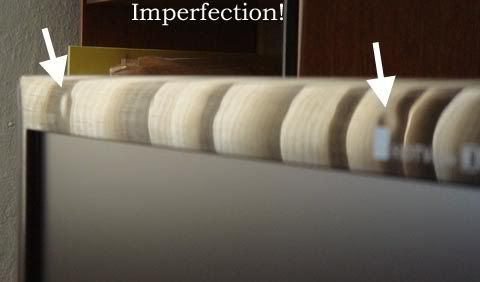

1. U mean like this?
I describe this a two screws behind overtightened just a tad. Not gonna O.C.D about it.
2. That sounds weird. Wouldn't expect that in a Mercedes.
