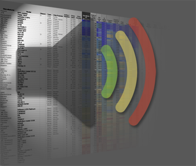

Link to Google Spreadsheet !
Link to [static, sorted by performance] published from Google doc .
Partial list below. Go to the PDF (below) or the Google spreadsheet for all info.

Data
I'll be pasting the list of speakers and what data I can in a more limited format, but I'm maintaining the master as a Google Docs spreadsheet which has the most information.
Color Coding
I used conditional formatting to come up with color coding. Dark red = bad, oranges less bad, yellow almost good enough, greens are good, blues are better, and dark blues are superlative. Lots of subjective thinking here, as I realize that sensitivity is neither bad or good, but rather a design decision. However, it plays such a huge part in speakers' ability to output high spl with low distortion, that I'm willing to judge it. The colors have been "normalized" when I saw huge gaps in the colors or a cluster of a lot of numbers using the same color.

Here's the make models of those that can do 95db with 1/8th of peak power (where power compression reportedly begins) at 12 foot listening position.
Code:
Code:
JTR             Triple 12HT
JTR             Triple 8HT
Klipsch         KLF-30
Seaton          Catalyst
Klipsch         KLF-20
Klipsch         Cornwall III
Carvin          PM10
AWO Fostex      LS/3
Tannoy          Definition Install DC12i
AWO Fostex      LS/4
JTR             Single 8HT
Danley S. L.    SH-100
Klipsch         Heresy III
Chase           SHO-10
Peavey          PR10
eD              eD[c]12
Mackie          C200
Klipsch         RC-62 II
AWO Fostex      LS/2
eD              eD[c]6.Center
JBL             LSR6332
Procella        P8
Yorkville       YX10
Chase           PRO-10
Klipsch         RB-81
Klipsch         KL-525-THX
ElectroVoice    ZX1
Tannoy          Definition Install DC8i
eD              eD[c]6
Klipsch         RB-61
JBL             Studio L890
Paradigm        CC-390
Ascend Acstcs   CMT-340 SE
Hsu Research    HB-1 MK2
Hsu Research    HC-1 MK2
JBL Synthesis   Ls 80
Tannoy          Definition Install DC6i
Here's an image of the sheet, but missing the "bottom-feeders."
