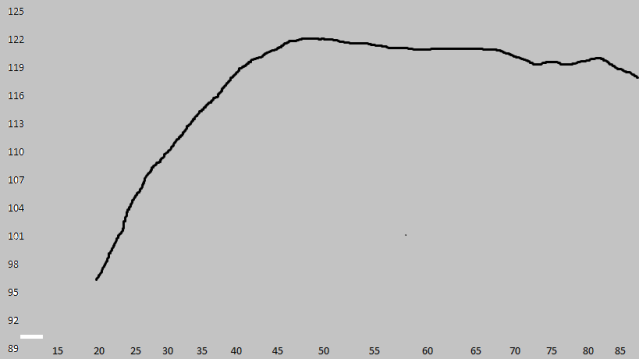

WEll since I suck at life and cant figure out WTF im doing wrong with REW I decided to just go back to pen and paper marks.. I moved the sub AGAIN , behind the coucjh, AGAIN, but gave it a little more space behind there this time and wow, I have found the right spot, Finally which ended up being about 2 feet from where I started 2 weeks ago
Last week when I got my RS meter I did some test, all tones are run @ 19-20 Volts @ the listening position ... Old marks in standard text, New readings on right .. MUCH smoother response and overall better output especially to 40 hz
And yes I am this bored
Lets just call it MEW... If you guys want to run the program , let me know and I'll zip you a file
......Old #s ......... New Numbers
20 hz - 92 db .. 96 db
24 hz - 100 db.. 102 db
27 hz - 98 db .. 106 db
30 hz - 101 db .. 108 db
35 hz - 107 db .. 114 db
40 hz - 111 db .. 114 db
43 hz - 115 db .. 118 db
45 hz - 118 db .. 120 db
50 hz - 118 db .. 119 db
55 hz - 117 db .. 117 db
60 hz - 114 db .. 114 db
65 hz - 108 db .. 115 db
70 hz - 104 db .. 118 db
75 hz - 111 db .. 118 db
80 hz - 117 db.. 114 db

Originally Posted by mj79 /forum/post/18187082
what do your graphs look like? I know you had your meter a few inches out of the mouth corner loaded in a few of your vids.. This is at my LP which I assume is getting tagged in the low end by my room.. COmpare your #s with me, what are you hitting at say 10 volts a foot out of the mouth?
I never posted vids with a meter.
my graphs look like this:
you can see how mine drops out around 20hz, that's normal.

is that graph with both of yours? and what voltage is the yellow graph? Yours are naturally gonna dig deeper I think just from being 30" but yea I agree, something is weird how I dip almost 20 db from 45-20

that doesn't account for the huge drop

yea so I should be seeing at least 104 db @ 20 hz ,, hmmm I dont think the seal is bad, I just RE tightened it last week ..
