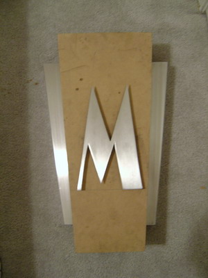

One of the custom sconces... the wood to be covered in black leather the light comes out above and below and halos the M

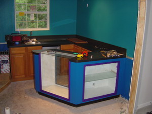

Candy Counter getting installed... no glass yet

Finished all of the sconces...
Aluminum and wood wrapped in black leather the M has a hole behind for the halo light effect

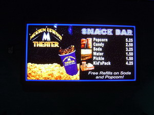

There is more but no pics right now.... I'll try and get some pics this weekend, but I hung the automatic drapery rod for the lobby, the posterbox, the concession sign and the light cannon. made the drapes for the lobby from so drape panel we got from Ikea, but the hooks we have right now catch, I am going to have to modify them. I put the lighting in the candy counter and wired that up to a touch switch but I have not tucked it all away neatly yet, and lastly I got a cellular no cord blind for the single window we have.

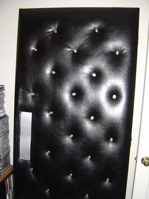

pics of the door I made... it's a Safe n' Sound covered and the other side has a 3/4 mdf attached to it with roof felt and batting in between to stop squeaks.

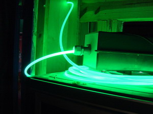

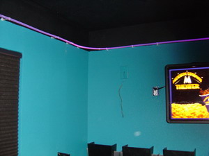

I also installed my flexible neon, pics of it and the illuminator. It has a color wheel turning so the colors are always changing.
Some more images...
http://www.samuland.com/gallery/thea...485_resize.JPG http://www.samuland.com/gallery/thea...487_resize.JPG
http://www.samuland.com/gallery/thea...488_resize.JPG http://www.samuland.com/gallery/thea...490_resize.JPG

what are your measurements of your sconces, they look great.

I want to do a similar treatment on your door on the front of my bar.
What thickness foam is that, where did you get your matching buttons, did you hand tie each button? any other tips would be greatly welcomed.
The flourecent light is one of the best tools I have! that thing is great!!!!! Got it a HD for $60 and every guy who's been in my room has gravitated to the light, heck I am giving one as a xmas gift this year!
I can get you exact dimensions of the sconces when I get home but they are something like 14-15" tall... there is a Show us your sconces thread here somewhere I have more pics of them there. They have the underside of the M cut out so the light Halos the M it looks very nice mounted I have experiments with different covers for the top and bottom to project a pattern on the wall as well but until they are in the theater I don;t want to go any further on that
On the door... I got some buttons from http://www.mjtrim.com/catalog/catego...tegory=Buttons but it looks like mine are no longer on there! So what I did was:
1. Cover the door completely w/ batting and leather.
2. measure and mark dimple points
3. Screw washers down to make the dimples( have to be carefull or you will twist the leather. JUst go slow.
4. Dremel out the back of all the buttons( this took forever!) I wanted the buttons to sit down over the screwed washers.
5. Hot glue your fingers off...
...sorry did not take any pics of this process.
See less See more
Thanks for the details on the method you used. I think I'm going to try the tie down method. I should have access to the rear. I'll drill holes in the wood and use a long needle and nylon cord.
