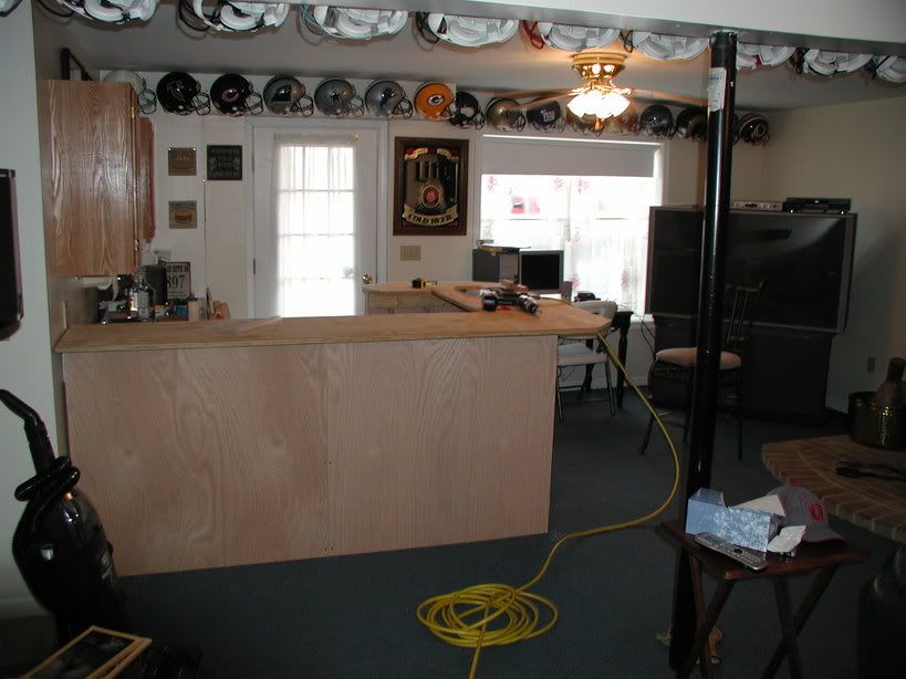

My research indicated that the bar should be 42 high from floor to top. Figuring that I would have a sheet of ¾ inch plywood for the top base plus and estimated ¾ inch of whatever I decided for the finished top of the bar. I had them cut both plywood sheets to 40.5 inches. This gave me four 40.5 by 48 inch sheets out of the two eight foot long sheets to make up my base.
This shows the long dimension. My base is 7 feet long by 4 feet wide with a 2 foot return.
This shot shows the 4 foot section of the base and the ¾ plywood top.
This shows the return and you can see the back of the bar that I used 2x4s to bridge the plywood sections.
How the unit will relate to the half of the basement room.

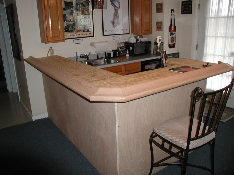

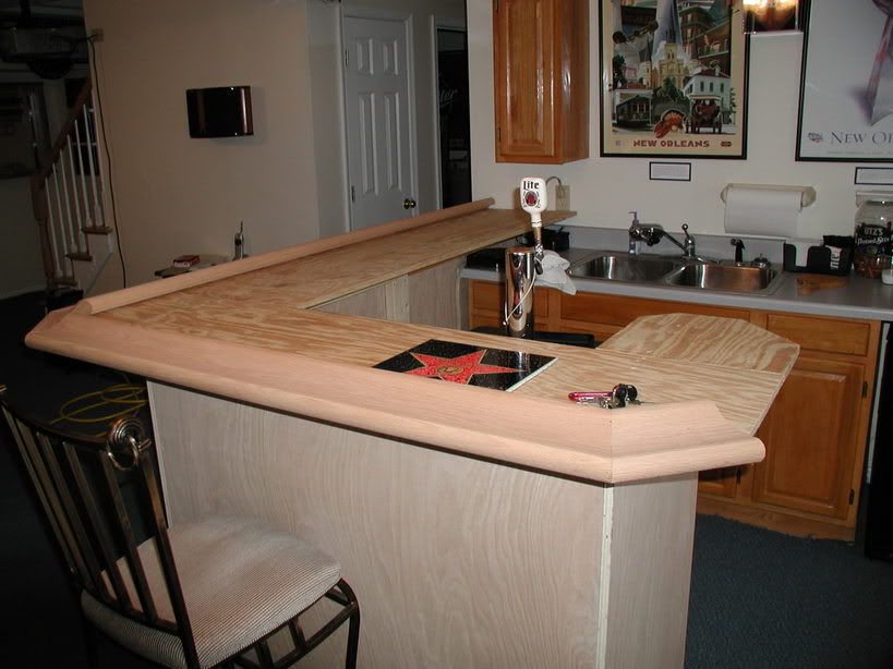

The beginning of the application of the bar railing. I love this stuff. It drove me crazy, but it looks good and is very comfortable. The chair is there to check the height, but it was several inches shorter than our final chairs. So why did I bother? Because I was thirsty!
Long side with railing application
Return side
Return side
