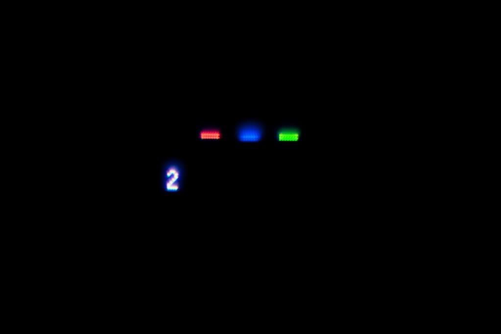

A little background. I bought my first projector, a new Sanyo Z60, before christmas. I picked it because my new house has a media room and the reviews said it was razor sharp but a bit dim. I mounted it dead center about 1.5 feet above the screen and 13 feet back. I mostly played DVD's and some games on it, but was noticing some pink tint on white text. When I finally got a pc hooked to it via HDMI, the calibration images looked pretty bad so I sent it back to sanyo.
In short, they called me and said it was "within spec" and sent it back, but noone else I show it to seems to think so. I need some opinions to use as ammo when I call them back. Any help would be appreciated.

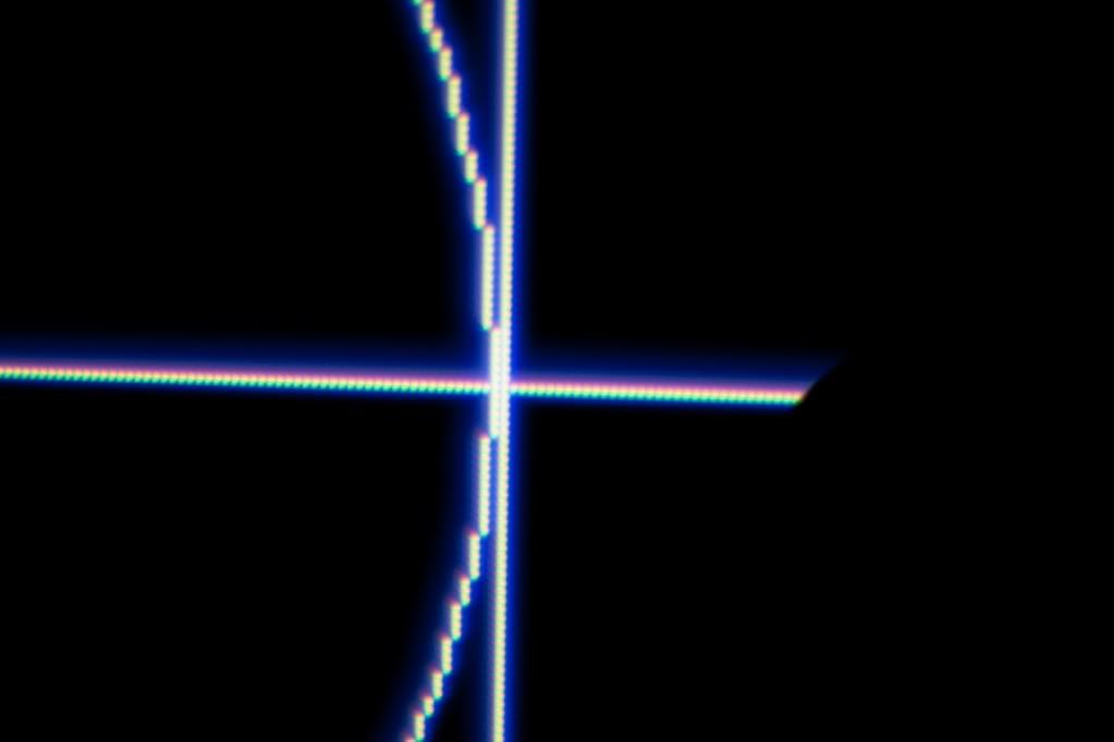

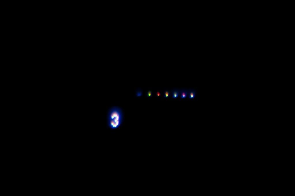

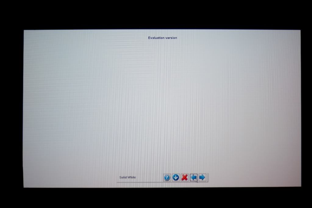

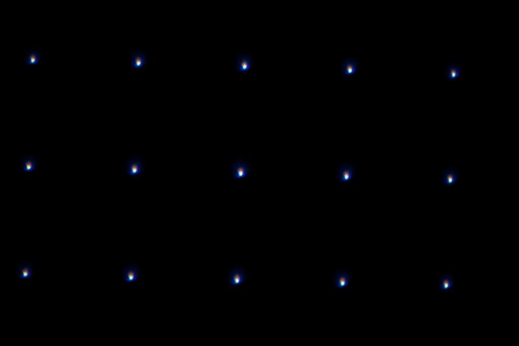

Anyway here are the pics, note the massive blurry halo. (yes, this is what they really look like, my friend is a pro photographer):
Solid white screen (pink in the corner!?)
Convergence Lines
Convergence Banner
Red Blue and Green 2 pixel lines
Target
White Dots
Pixels - Blue Green Red Yellow Cyan Magenta White

More than just pink, that image in the first photo shows blue toward the top left and pink toward the bottom right.
Sanyo says it's fine? What does your vendor say? I'd be calling both until you get a better machine.

The chroma issue in the first picture looks pretty nasty on the right, not quite so bad in the bottom left. That alone would be enough to have me climbing the walls. If Sanyo isn't seeing that they must have Stevie Wonder working in the service center!
I would refer to Art's review of the Z60 at projectorreviews, specifically the image of Gandalf in the image quality section. He was seeing the same thing as you on a pre-production unit and it was bad enough that he asked Sanyo for another unit just to make sure this wouldn't be nearly as unacceptable on a retail version.

Misconvergence:
Red is probably within spec - about 1 pixel.
Green and blue are not acceptable to me.
Color uniformity is pretty bad. Overall not something I'd accept.

Any idea why things have a massive glow? For misconvergance I thoguht I would see that the the blue squares would be slightly higher or left of the other squares, but still square. Why do i see a giant blue blob?

I really havent touched anything. I am going off of the assumption that if I project a blue line that is 2 pixels tall, and I see a blue glow on top that is 4 pixels tall, there isnt much point to calibrating it. Am I incorrect in my assumption that I should be able to shine a blue square on the screen and actually see a blue square?
I would appreciate you downloadign that last pic as a bmp and full screen it (i used irfanview) and take a pic of some of those. If you want to make your own, I just opened up paint and set the attributes to 1280x720 and painted it black and drew some red blue and green patterns on there.

Update:
I called them, he read me the notes that it was the convergence was calibrated. I told him it was unacceptable and they agreed to take it back.
I then unmounted my projector and set it dead center on the screen to take away any lens shift. I projected some new images and it is pretty apparent what is wrong.
a) The 3 colors are not at the same focal length. I was able to focus one color at a time, but overall focus is more toward red (which is why blue has a huge halo)
b) the red pixels have green in them (hard to see from my crappy camera), this would not go away no matter what i did to any of the adjustments (gain, tint, color, etc)
c) BOTH red and green colors have a blue halo!?
Text test:
